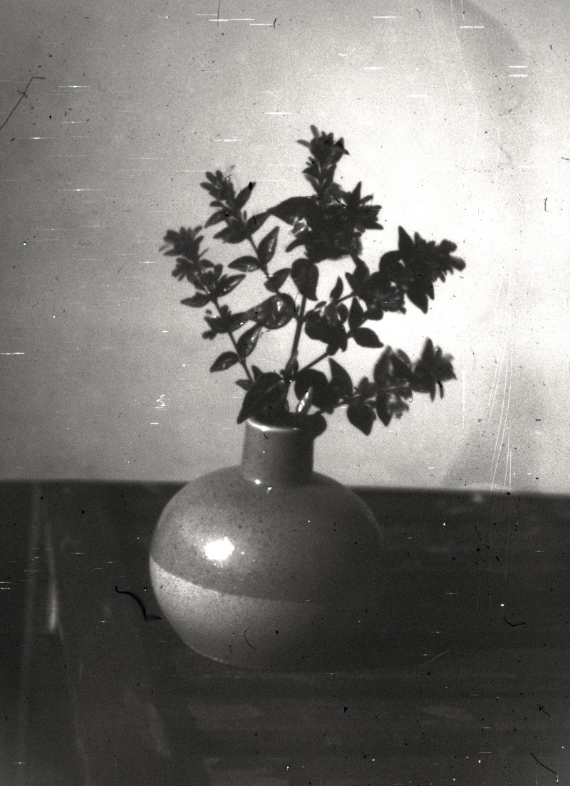

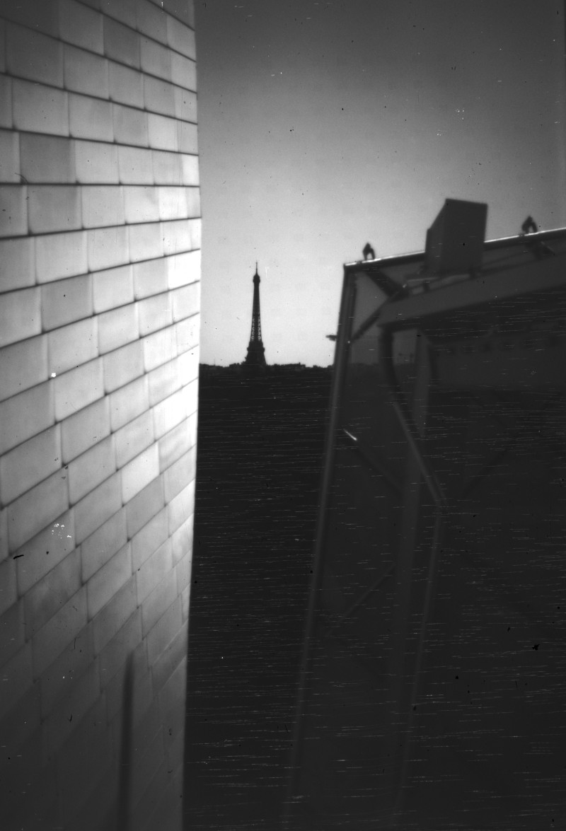

We now have 35mm UV-sensitive film available and in stock. It's very low ISO (10 mins with the sun out), but high resolution. Developing there are 2 options - remove it immediately from the camera and develop with heat (contrast fades within minutes) for a negative. Or give it a couple of weeks, flash with a high brightness UV light and develop with heat for a positive. We can provide the positive processing if needed through our custom machine that includes a UV lamp and a heat drum. It's a very impractical way of taking photos, but a lot of fun, and no animal products as not emulsion based so great for vegans. For anyone interested please drop us an email through sales@jacrofilm.com .
