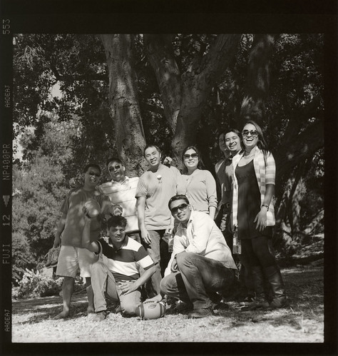

The negative I used for testing was a naturally contrasty sun-lit frame shot on Fujifilm Neopan 400PR (generally a contrasty film) developed in Rodinal 1+25, and then printed on Emaks K-888 #4 paper developed in Selectol 1+1 for 3 minutes. I wanted to align as many things in the "wrong" direction of too much contrast to see how SLIMT would benefit this pathological combination of materials. Normally I would never print this negative on #4 and reach right for #2 just by looking at the negative as it was dense, contrasty, and full of hot highlights from direct sun. However, it's still a typical negative that doesn't print straight out of the box.

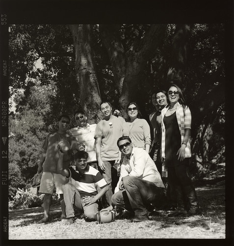

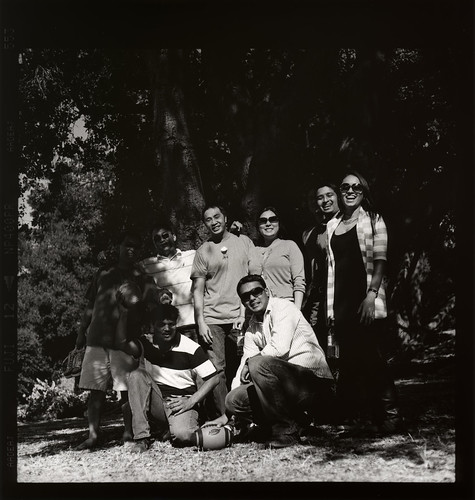

These are straight scans of 3 different 8x10 prints using an Epson V700. The straight normally processed print is on the left in both cases. No selenium or other stunts were used - just SLIMT for comparison and traditional bleaching for another comparison. Obviously there are many different ways to handle this print, but the point of this is to focus on SLIMT and not exploring every way to skin this cat. I wouldn't normally print this frame on #4, but as mentioned previously there's a reason I chose it.
Straight vs Post-bleaching (5ml of 10% stock/500ml, until shadows opened slightly/brightness punch):
Straight vs SLIMT (5ml/500ml, 2 min):
It's painfully obvious that this technique works effectively and doesn't carry the drawbacks of lost micro-contrast from pre-flashing or manipulating development dilution/water-baths, etc. (I still recommend considering those techniques as additional tools to have). The straight print is far too contrasty and highlights are difficult to balance without printing more open and burning in or sacrificing the shadows and printing down (which is unacceptable for this type of photograph). Actual hassle is fairly low as mixing the tray mix for each print that needs it takes around 15 seconds (Use a 5ml tsp and mix into 500ml of water in a tray).
The amount of options afforded to the printer through use of grade choice combined with SLIMT is great. There is no reason one cannot use #2, #3, or even VC grades to arrive where they want to through educated trial and error (which is how most people print in the first place). One can print the shadows down and then use the SLIMT bleach bath to open the shadows back up while leaving the upper-mids/highlights unaffected and properly exposed but retaining high contrast. This is also somewhat possible with post-bleaching but I feel SLIMT offers much more latitude and affects things differently - but there is also no reason the two techniques cannot be combined.

FWIW, the SLIMT print looks too light and washed out to me. Are pure blacks always sacrificed so heavily with this technique, and are the high tones always so glaring?
No. #4 and exposure is setting the high tone contrast and overall level. As I previously mentioned I didn't go nuts trying to achieve a perfect print - just enough to demonstrate where SLIMT can take a complete over-contrast situation to.
Here's a 5ml/500ml SLIMT bath with 1min duration as opposed to 2min (which was shown above):
No Selenium toning has been done in any of these - and that would definitely help solidify shadows in a beneficial direction. The above print I feel to be pretty acceptable for something that added 1-2 mins of additional time to the process without *any* local dodging/burning/split-grading/etc. - also considering the disadvantageous neg/scene/paper grade.
