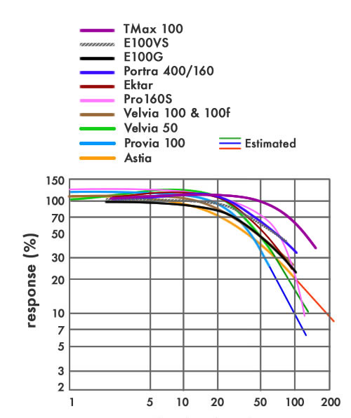

I gather Velvia 50 is the sharpest available slide film on the market. Could anyone please advise on the sharpest 100 speed slide film available?
It appears according to this that Provia 100 is your sharpest 100. I'm also quite surprised that the sharpest film is Pro160NS which is sharper than Ektar. I think people beleive Ektar to be the sharpest when actually it just has the finest grain. The sharpest Kodak neg films are the Portras.

That graph looks kind of normalised. Ektar for example has much higher contrast than Pro160S or Portra 160 (and hell, they differ in contrast but get one line!). Once you move the Ektar and Provia lines upwards to account for the higher contrast, I would expect the Provia 100F or Velvia 100 (not F) to be about the sharpest(-looking) ISO100 chrome currently around.
Sure, Astia may have a lot of resolution, but that doesn't mean it's got a lot of acutance; in fact its low contrast will hurt apparent sharpness.

I've only reproduced the information supplied (and taken the best curves for the kodak stuff).
I imagine that the results were taken from a typical print but won't it be possible to increase the contrast of the negative material more than the transparency? I don't know how they calculate MTF for neg is the problem.. Having scanned astia and portra 400 shot of the same subject, I have to say that the Portra 400 held a lot more sharp detail - anecdotal evidence caveats apply.
