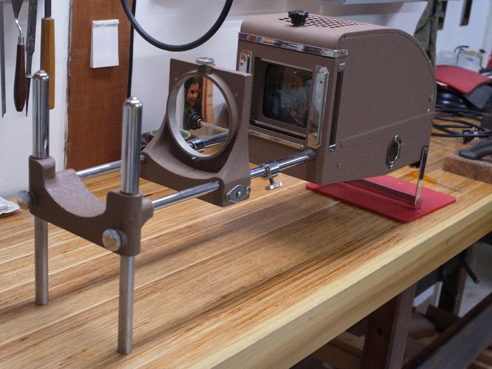

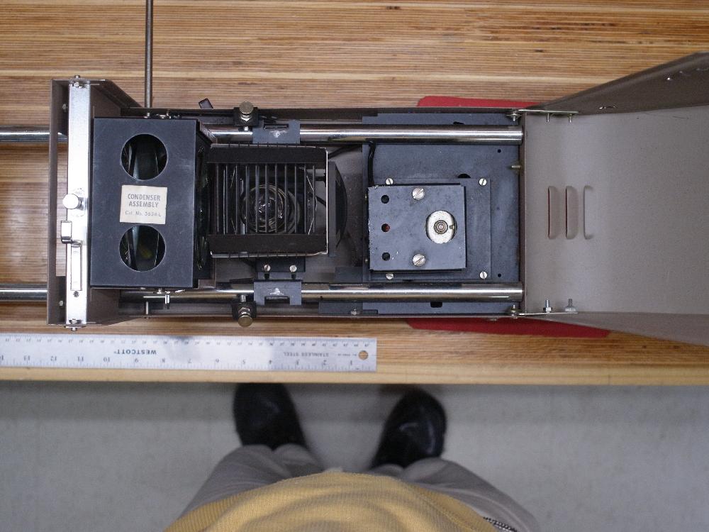

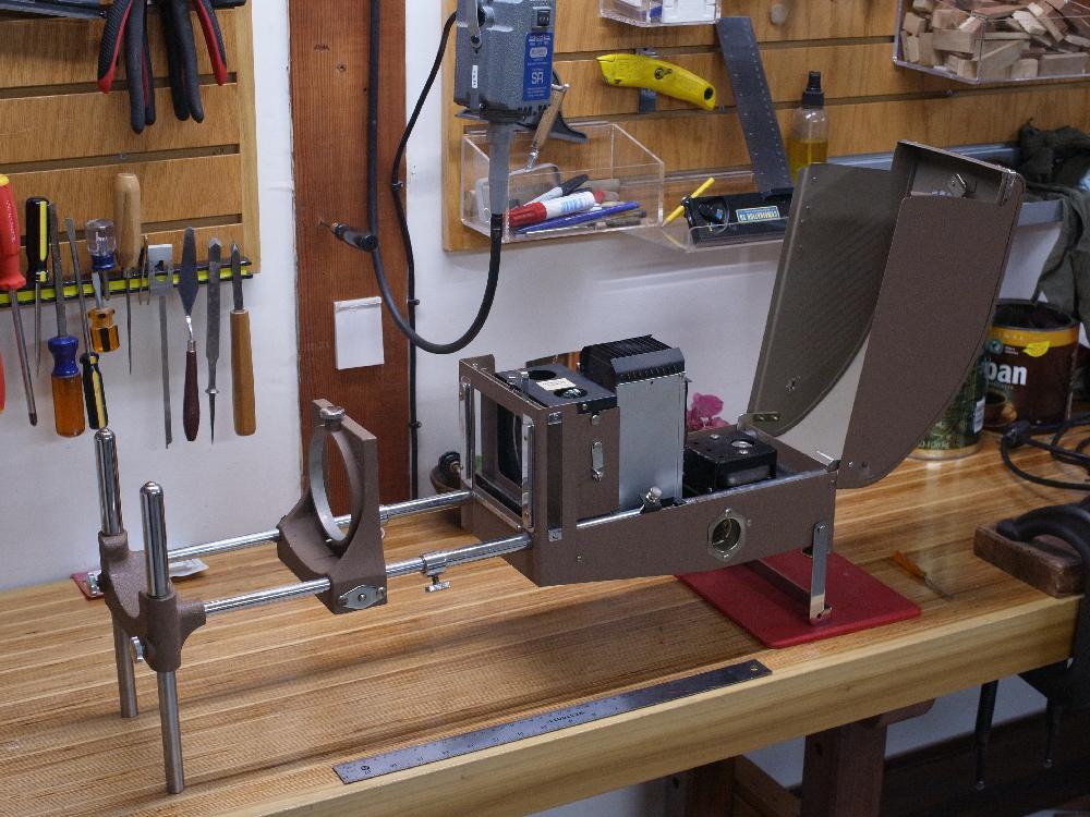

Attached a couple of photos of the Slide King. Inside you can see the condenser assembly on the left, in the center the light bulb, and on the right the motor/fan blower. I have already removed the bellows and lens.

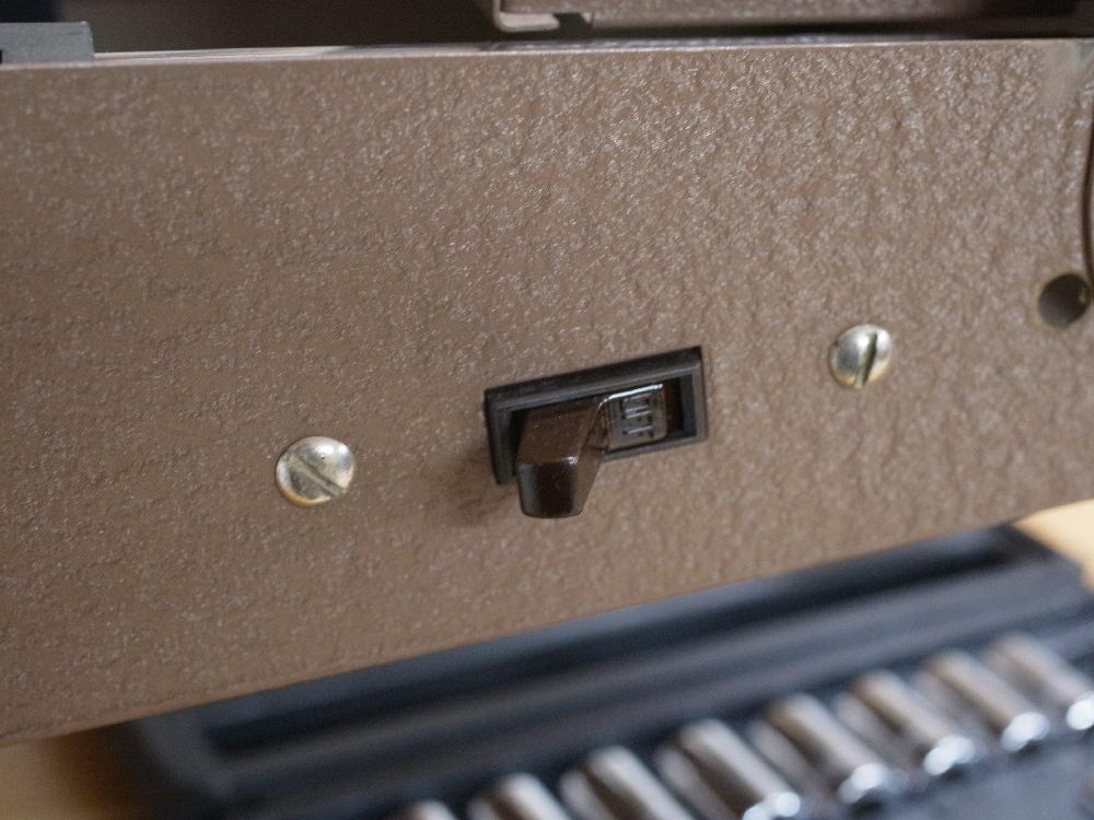

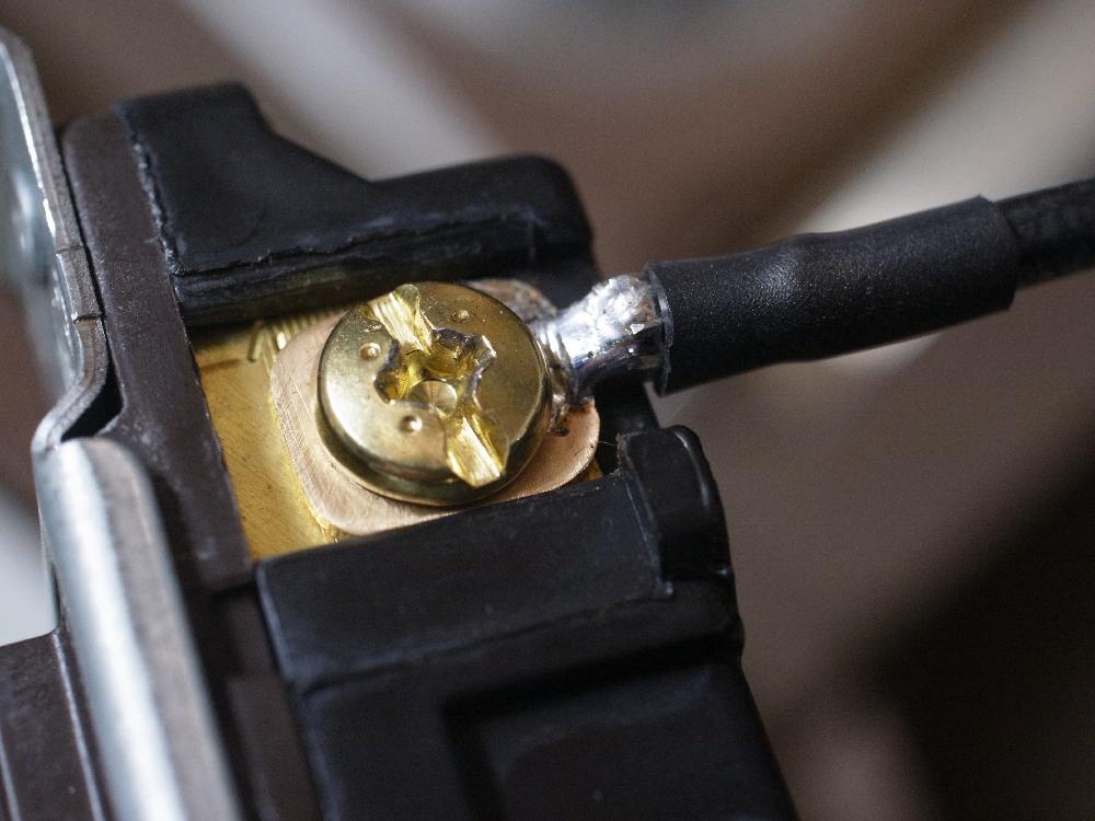

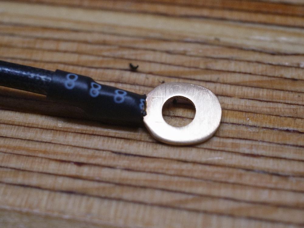

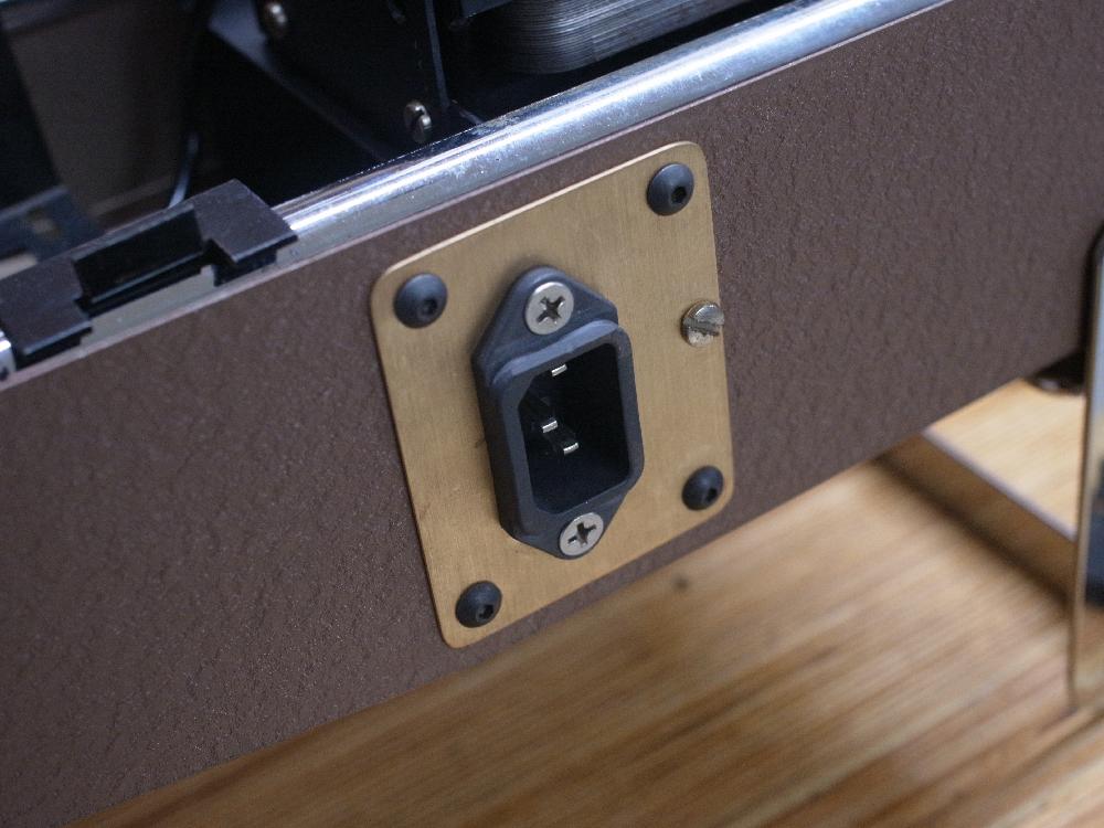

The first couple of upgrades are done, see attached images.
I bought a new switch, it is, just like the old one, simply a light switch like one that is used for ceiling lamps etc. It's rated 15 Amps at 120 Volts. It was really easy to install, since it has the same thread holes etc. as the old one.
I also installed a new mains socket. This one is rated 10 Amps at 250 Volts. It also includes a ground connection, which I will simply attach to the metal case of the projector. The socket was a bit more work to install, since it is smaller than the original. I opted to cut a little bronze plate to size, so that the original hole would be covered. Everything is properly mounted with screws and nuts.
I haven't done the wiring yet, I will wait for the new light bulb socket. I did however take pretty much everything apart. Most of the wires were in pretty bad shape, except those of the fan, maybe the fan had been replaced at some point. When I got to the bulb socket, I was able to see its rating--it's rated for 1000 W. The original switch and mains socket were rated for 10 Amps, so the only reason I can think of why the projector was not "officially" rated for 1000 Watts on the plate is, that the blower is not made for 1000 Watt light bulbs.

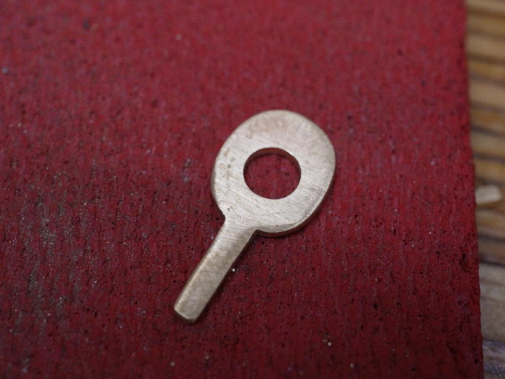

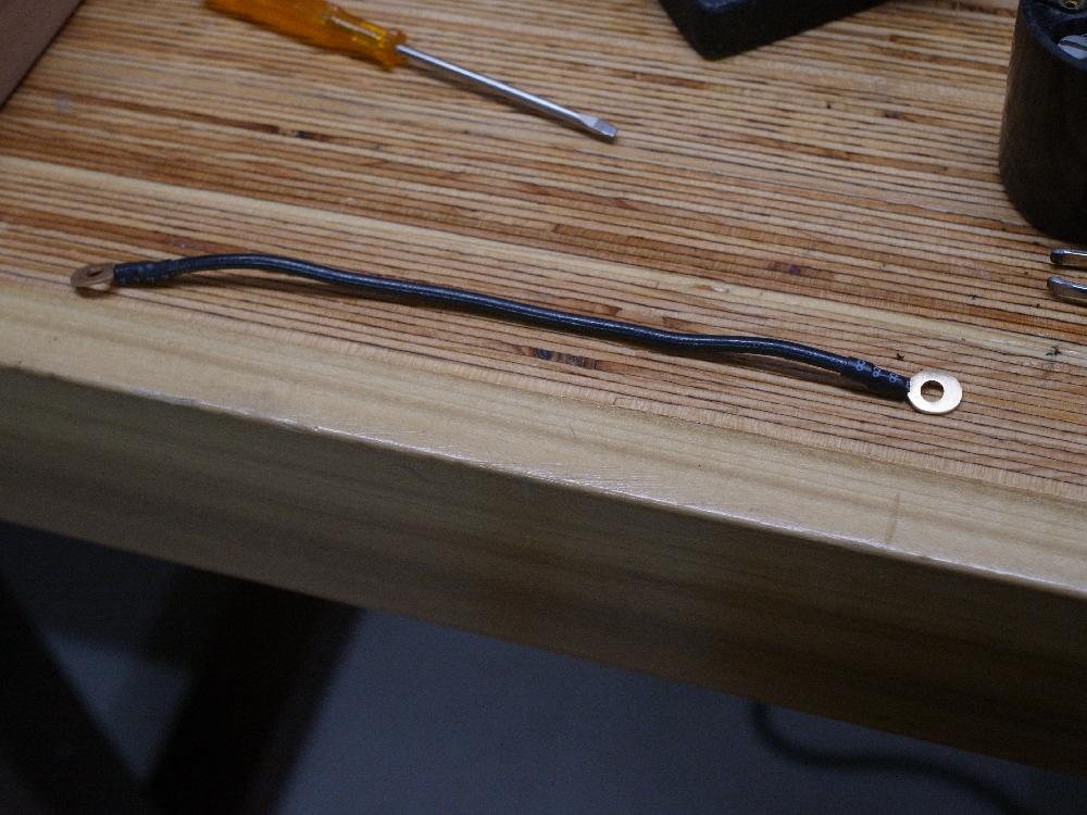

Upgraded wiring, 600 Volt 12 gauge wires with custom-made clips (soldered on):

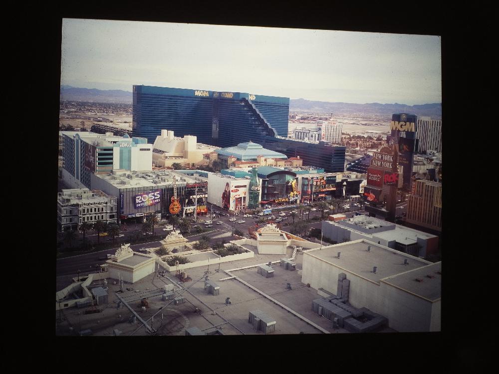

Image of screen with 750 W bulb, before lamp housing adjustment (notice the uneven illumination):
Image of screen with 500 W Halogen bulb, after lamp housing adjustment (notice the even illumination):

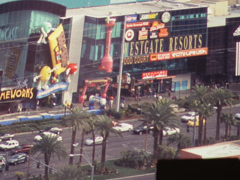

Image of screen, same as above, close-up:
