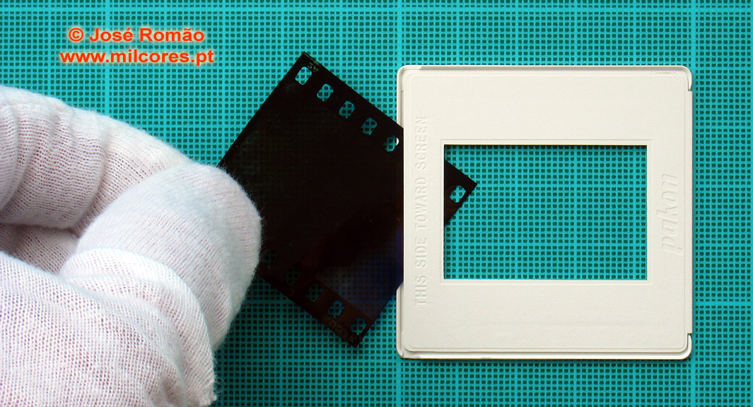

Does anyone knows how it works a reflecta RG 750 CS? It's a slide month machine but I don't know how it works.
Works ONLY with CS slide frames (not CS-2). push in film from the left, insert open frame from the right, advance film into frame (grey thumb wheel) - press red button... (provided batteries and motor work) ... may be a framed slide comes out, may be it got screwed and - I dare not mention...
Good luck!!
