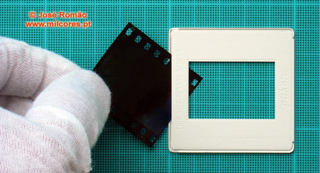

Do you mount your slides at home? Is that safe?
