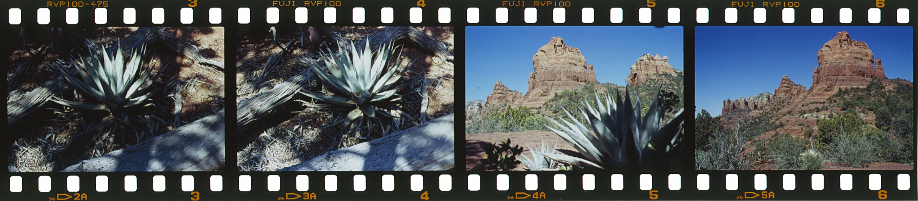

Here's a scan of four: Velvia 100

Frame 2A & 3A have bright/harsh sunlight and shaded areas together, which is very hard to expose for and difficult for the film to capture. The only way I can see to improve the shot would be to use either a reflector or fill flash to try and lighten the shadows
Frame 4A looks good to me, maybe slightly over exposed but again it's harsh lighting conditions.
Frame 5A, I'd be delighted with that, especially the blue sky.
