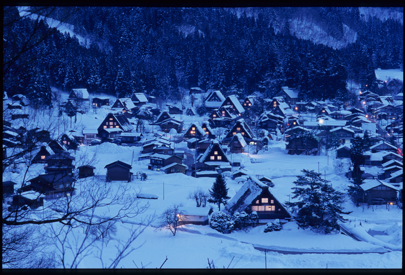

Just curious if you bracketed your exposures. Before I moved to black and white, I shot mostly slides (esp Provia) for years, and dusk was my favourite time to do so. But I would often bracket (erring to the side of overexposure) to make sure I got what I wanted. I experimented a lot in those days - with gelled flashes, double exposures, etc. Don't know what happened to all that. ;-) I think the key is reading your light - are you after the (dusky blue) sky, or the buildings/objects that are lit up? If the latter, how lit are they? Often you have to make a choice about what you want in the composition.
Here's a shot at dusk in Ogimachi, Gifu taken over 15 years ago on some flavour of Provia. Of course the light is a lot more even than some of the city shots you posted, but it's just what I have at hand at the moment.
Really nice shot! I'm betting the tendency of Provia shadows towards blue helped to set the mood here.
