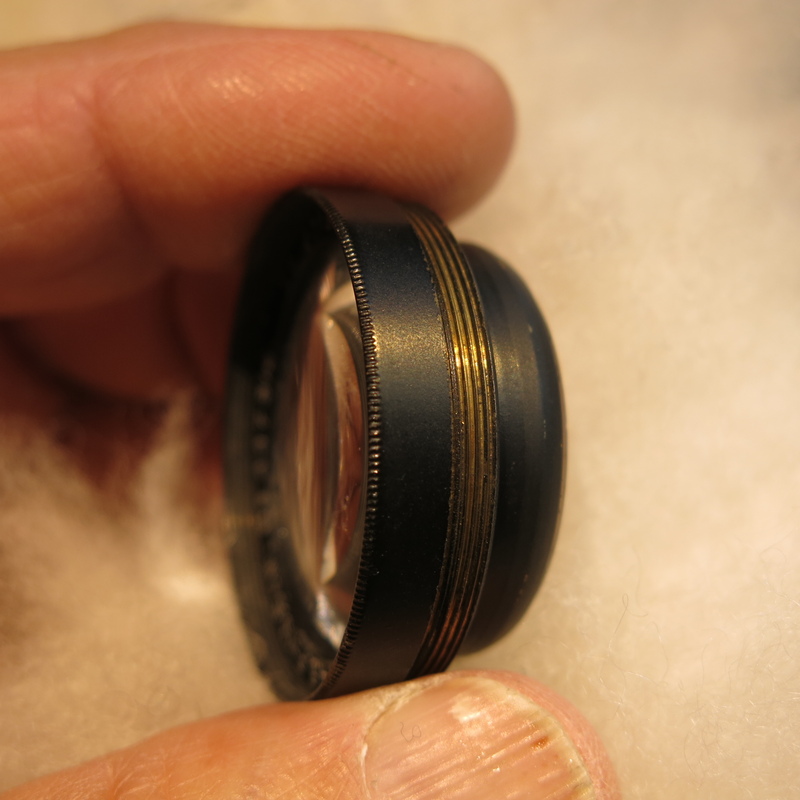

The front element of the Skopar 4,5/13,5cm on my Voigtländer Avus has the inside lens surfaces fogged. I thought I would be able to take it apart.. but then I read the manual!
From the "Sundry hints" section:
"On no account must any attempt be made to unscrew the separate parts of the front and rear lens elements for it is beyond the skill of even an experienced amateur to put them together again so perfectly as to restore their original optical quality. Anyone who tries the experiment in disregard of this caution will discover to his chagrin the extreme precision with which the assemblage of a lens of this kind is done."
I'm reasonably deft with my head and fingers. Should I heed this warning or not?

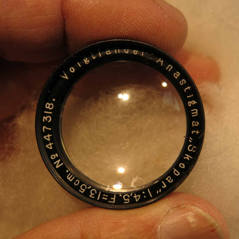

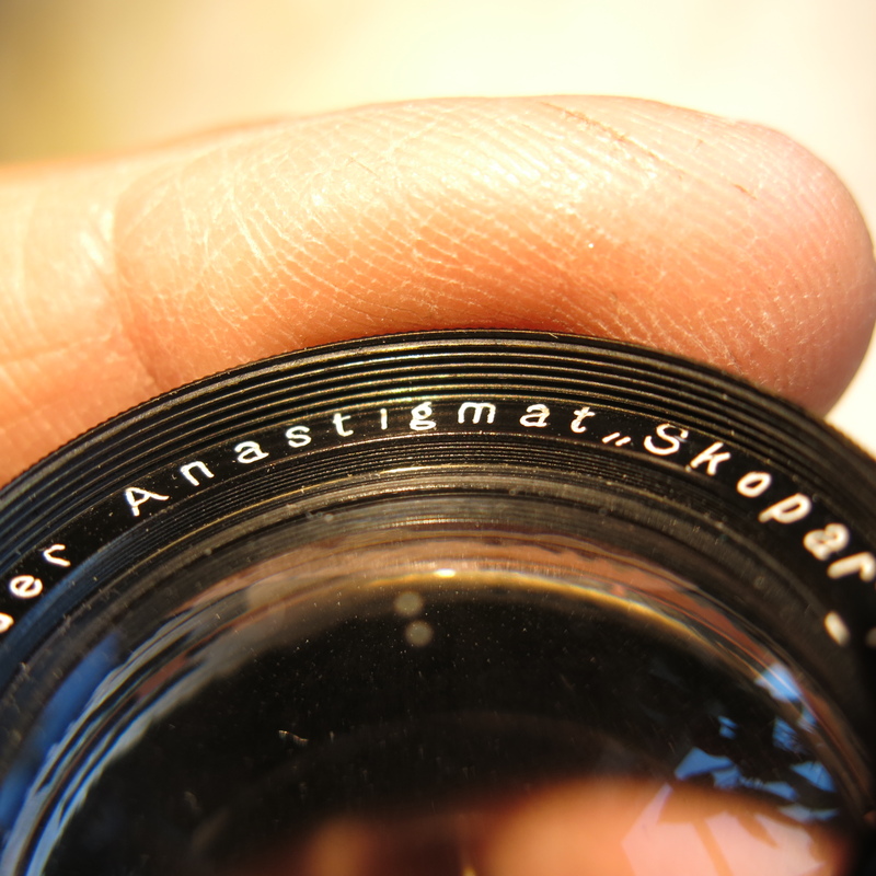

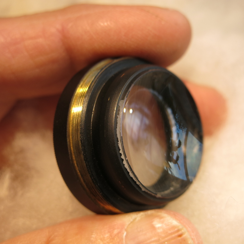

It's a plate camera that focuses by moving the whole lens/standard.
And it seem the rear glass is glued to the cell while the front glass can be taken out by unscrewing the ring with the text on it.

Good! So you can't screw up the second element position unless you remove it from the cell, and as long as you don't lose any shims (they'll be behind the front element) it should be easy to return it to correct position. The only gotcha I see is if the front element has lateral play inside the cell, and it likely doesn't or it would be prone to move over time without being disassembled.
Then, of course, the next trick is to get that name ring out without marring it (or accept drilling a pair of small holes for a spanner's pins; the one on my Rollfilmkamera has those from before I got the camera). I'd start with the usual rubber bung type gripper, and several layers of leather to protect the threads from whatever you use to grip the cell itself.
