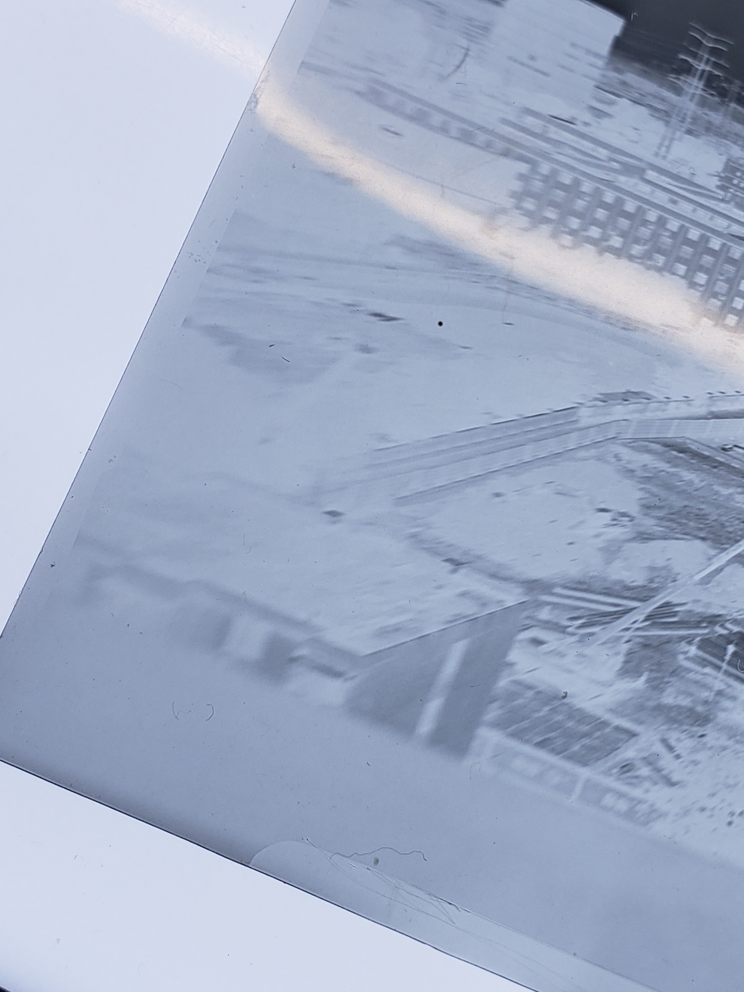

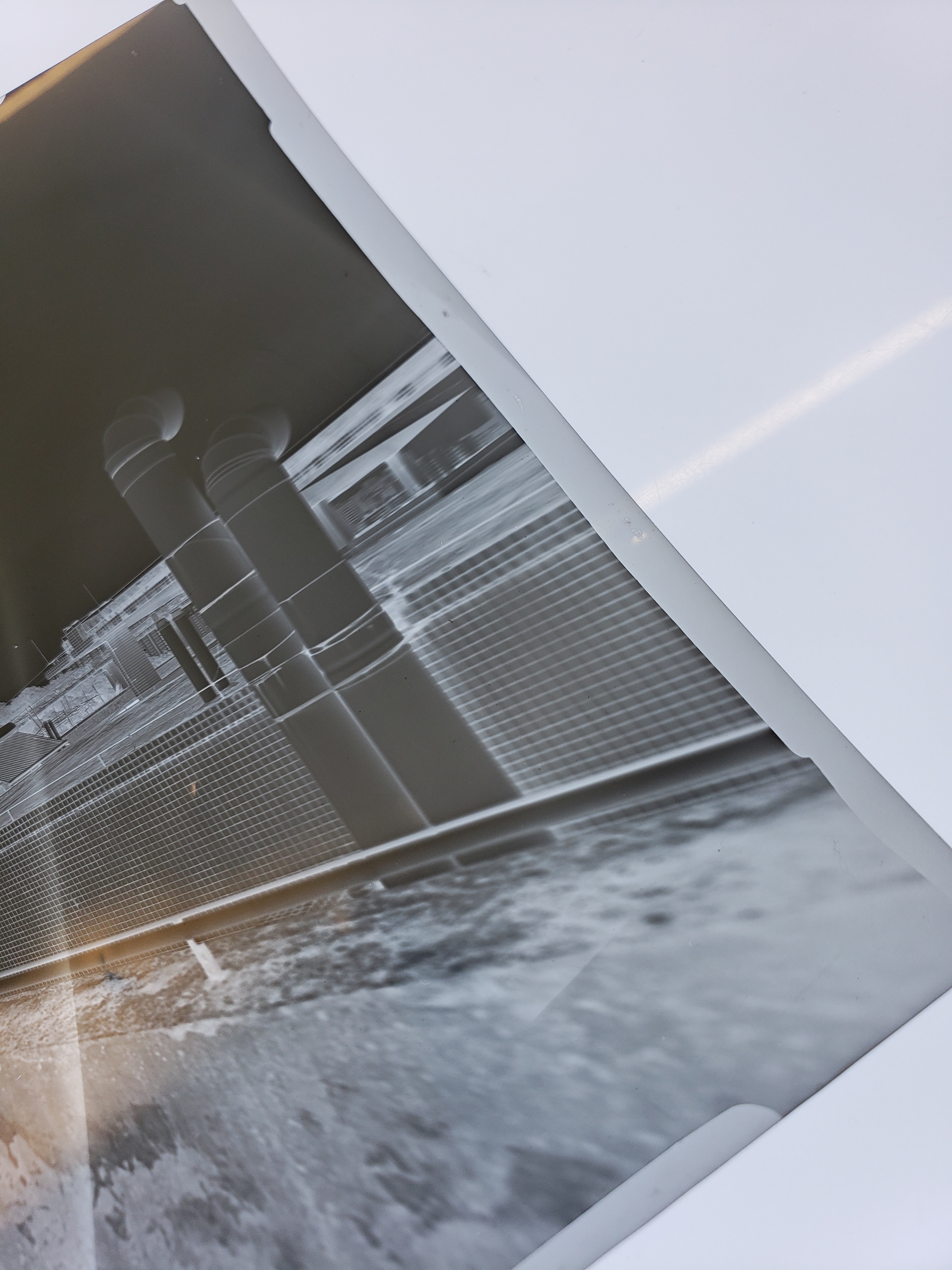

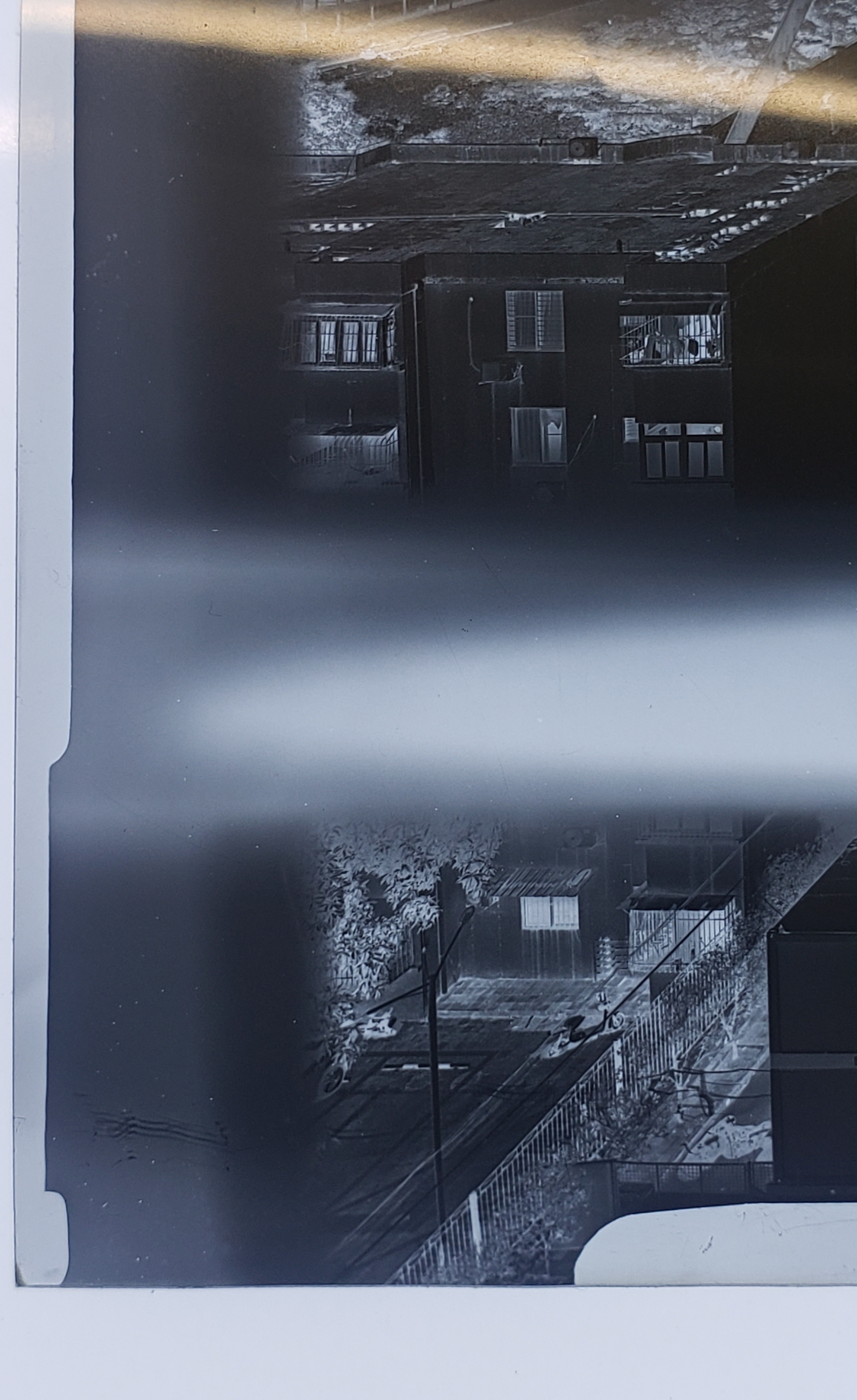

I just got a Sironar Digital 55/4.5 lens, which was mounted in a Sinar DB lens panel. I measured its length before moving it to another Copal shutter that only cost less than $30. It's 70.94mm. Then I measured again after mounting it, 69.50mm, a horrible shutter, far away from standard, 20±0.025mm. That's why my late batch Symmar-S which mounted in this shutter isn't sharp I guess. Anyway, I only ordered 10 pieces of 0.02mm shims, they weren't enough to adjust this shutter and I had to buy some ready-made products to fix my shutter. Finally, yesterday, I used 4pcs 0.2mm, 3pcs 0.1mm and 2pcs 0.02mm shims and successfully adjusted it to 70.94mm.
Today, I took it out to test it, with Sinar P and Kodak Pan-X 3412 film. All sheets were shot at f/11~16. I do know Rodenstock did some tiny trims on Apo-Grandagon 55mm and renamed it, then sold it as Apo-Sironar-Digital.After processing, it's sad that contrast with really high resolution centers, all corners are soft and fuzzy. There are two examples below. Maybe only 90mm acceptable IC I can get from this lens. I plan to test it again with and without shims and shoot at f/22 tomorrow.
BTW, if there's anyone have experience with this lens? What result you got?

I'll change shims' place to see if place of iris will influence it. According to datasheet, Grandagon and Sironar Digital are both recommended to work at f/8-11. It's not normal I think

Forgive me if this is a bit of a silly remark, but isn't this lens intended for smaller digital backs and thus cannot be expected to actually cover 4x5" film format? As far as a quick online search suggests, this lens should project a usable image circle of about 125mm. The diagonal of 4x5" nominal is around 160mm. If you've used any movements or tilt/swing, the usable image circle at the film plane will fall even more short.
MsLing
MsLing
Sep 29, 2023
87
Guangzhou China
Hmmm, I didn't use any movement. The main reason why I use 4x5 is to check if I can get a 125mm high quality image circle because I plan to use it with digital and 6x9 back. But obviously 125mm is impossible on this copy.
koraks
Nov 29, 2018
20,958
Europe
Sharpness degradation does start closer to the center than I would have expected - although I really can't tell for sure. What usable image circle did you get on these two sheets of film?
Also, have you tried the lens without the additional shims?

Keep testing. But if 90mm of circle is all that meets your standards, then you may have higher standards than the manufacturer. A not-unheard-of scenario in photography.

From looking at the negative, if what's seen is what's really on the negative, it seems that negative gets visibly blurry before 125mm circle. The only way to say if it meets the specs or not is to shoot resolution target and measure.

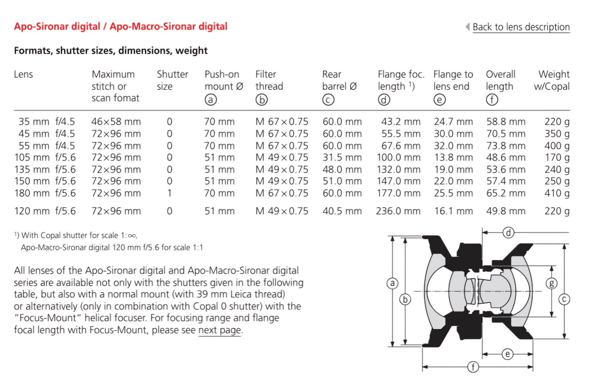

MARTIE
Oct 31, 2004
250
Hello,
1. Did you make any photos with this lens in the dB mount to find out if was sharp?
2. We're shims used in the dB mount?
3. Can you post what source documentation you are using for your measurement calculations?
I could be way off, but I've looked at 3 pdf's and all appear to give completely different measurements, including differences between the 'Sironar digital' and 'Rodenstock Grandagon' versions of the 55mm f4.5.
I'll include a screenshot from the 'Apo-Sironar digital' brochure.

Hello,
Oh I don't have a DB shutter or a Expolux shutter so I can't do any shot with the original DB panel.
Original DB mount used a small metal ring like the one in Copal version Rodenstock lenses as shim.
I only use vernier caliper to measure my lens. And I read all Rodenstock and Sinar datasheet as you show, its length is quite different.

I compare image with 0.00, 0.04, 0.08, 0.12, 0.16mm and 1.5mm shims, 0.02-0.06mm maybe good enough at center and corner.
MsLing
MsLing
Sep 29, 2023
87
Guangzhou China
After final check with digital, I decided to use 0.02mm shim. BTW, additional shims do increase resolution of center, but highly reduce corner's

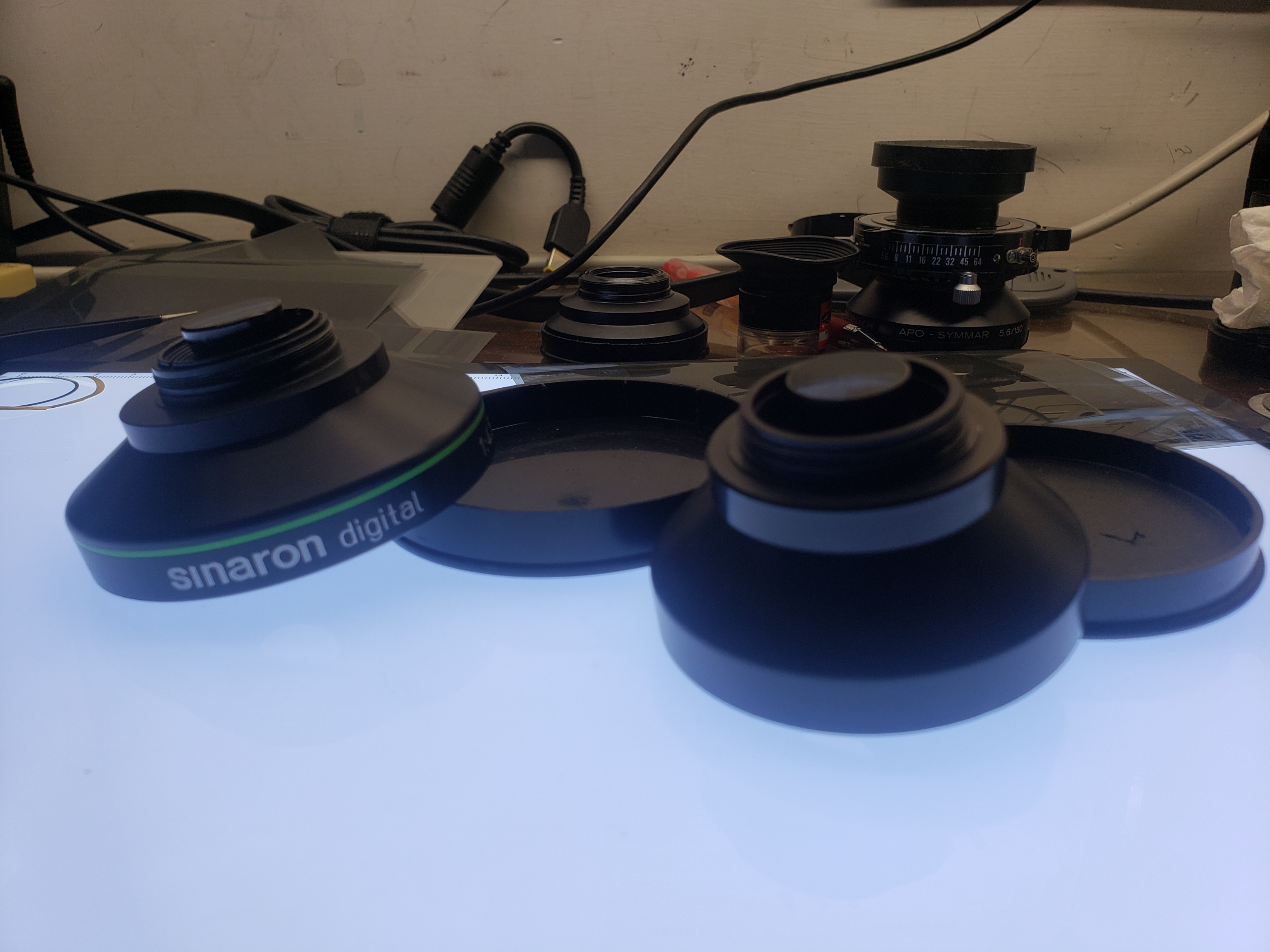

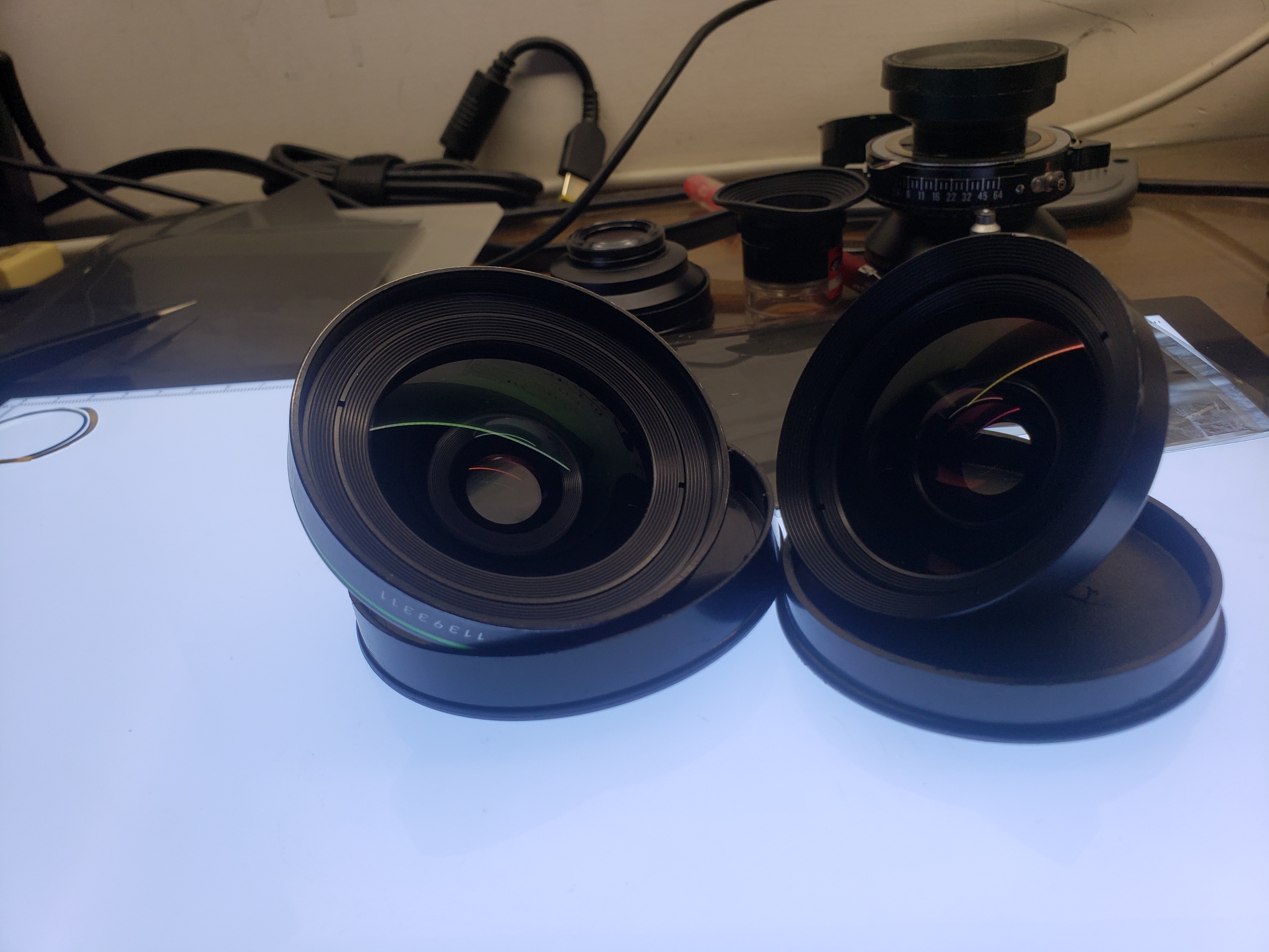

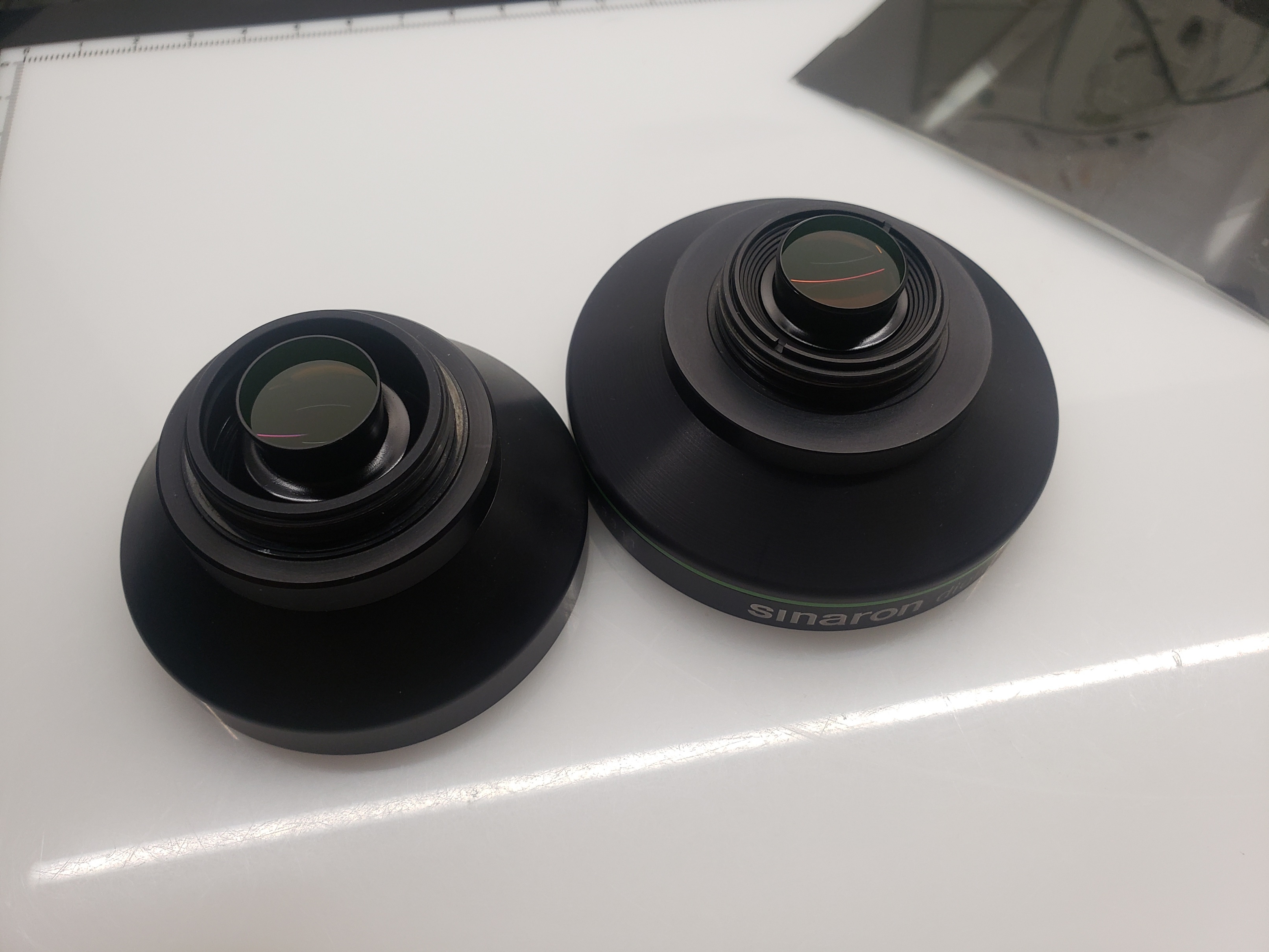

I'm starting to wonder if something odd is going on with your lens - e.g. this being some kind of Frankenstein combination of the front group of one lens and the rear section of another. The kind of unsharpness variation you're getting across the frame reeks of an unusually poorly compensated optical system - the kind you get when you flip one section back to front, have vastly incorrect spacing (much beyond tenths of a millimeter), remove elements from groups or, indeed, combine groups from different lenses into a new one.
Can you post clear photos of both sections of this lens (back & front)?
MsLing
MsLing
Sep 29, 2023
87
Guangzhou China
OK, here are pictures. After remove shims, corners look quite nice.
