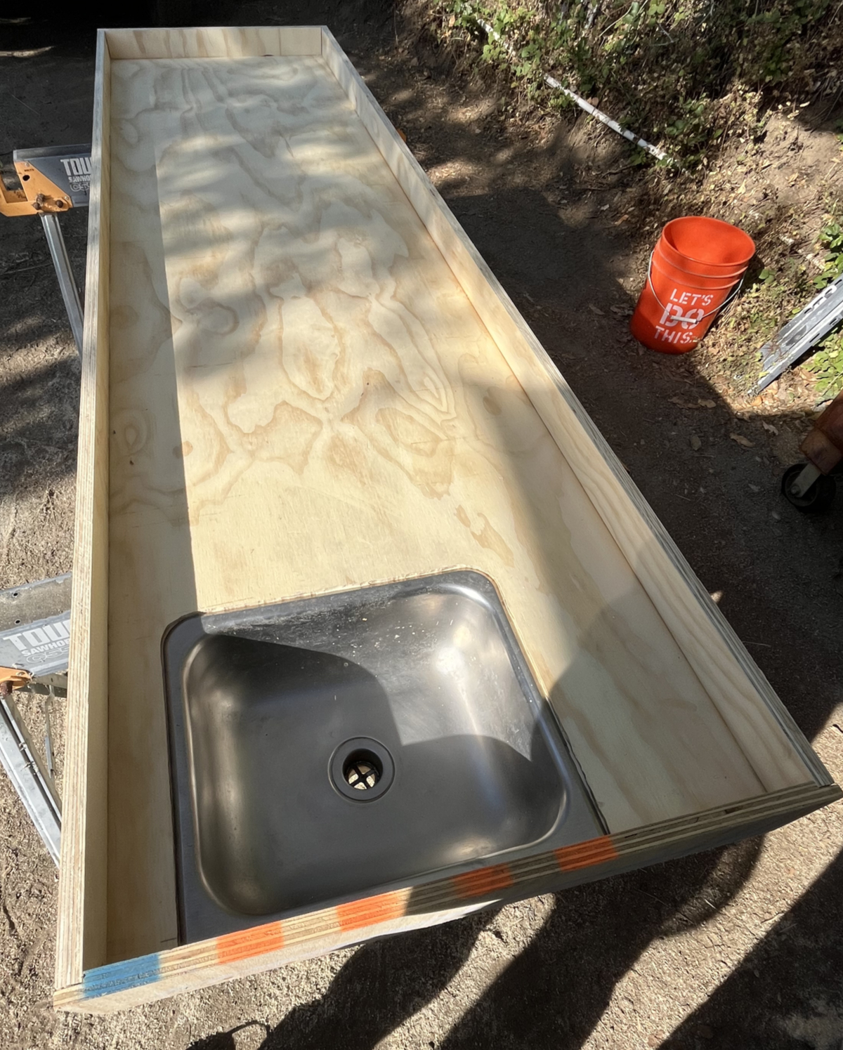

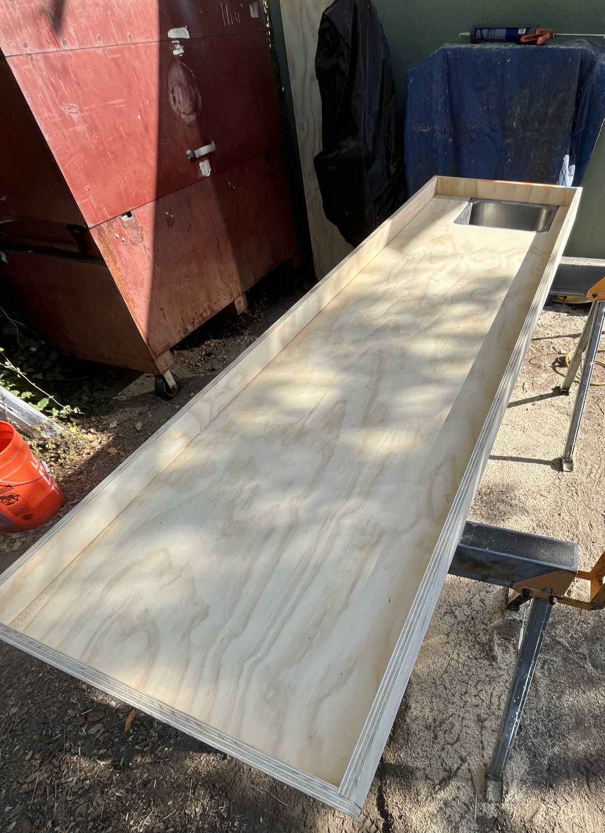

I wanted to add running water to my darkroom and went looking for a cheap sink. The Habitat ReStore had the board for my copy stand but the sinks they had were $155 and nothing I liked. I got home and was talking to my neighbor who just scored some beautiful cabinets from the ReStore and she asked if I wanted the sink she was replacing. It was perfect. I bought a sheet of 3/4" (23/32 for nitpickers) cabinet quality plywood, ripped it to size cutting the sides from the scrap. I routed the sides 3/4" x 1/4" deep to fit over the bottom then assembled it with Titebond glue and a finishing nailer. The groove in the end piece fits over the sink edge where I trimmed off the faucet holes. The whole thing was fiberglassed with 2 laminating coats and one finish coat. I should have left out the 6 oz cloth as I got bubbles and structurally it didn't need it but it will work fine. I topped it off with a genuine USA Lab Faucet with 2 Gas Valves that are plumbed with water for washing. Cost about $300 including the faucet. Size 25x88x4.375" with a 2.5" lip above the sink bottom. The stainless sink is routed in as well, 1/4" down.

I'm always impressed with the other talents shown on this forum. Good work! The only thing I would change is I would bevel or chamfer around the edges for resting your arms.

I broke the edges then used 6 oz cloth which rounded the edges further. I also made the height above the bottom just right for rocking the trays. LOL
This replaces a smaller one with 2" sides that was just Latex painted, no drain. I just checked and I can get 5 11x14 trays with the last a wash or 4 16x20 in the new sink. I was originally looking for a conventional sink that would hold 4 deep film tanks and not touch the Latex painted tray trough. The bar sink was too small for that but the new sink will store the film tanks at the far end and still allow 5 11x14 trays. I don't have to dump the film tanks to process prints now. That and running water makes it all good!

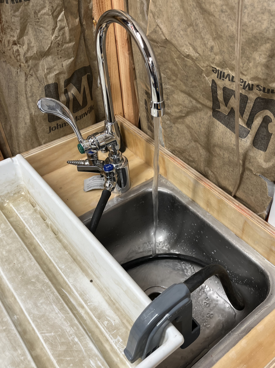

Sorry, not a snazzy dresser but the drain and water are plumbed. I left room for drywall if I want. Got the Kodak Tray Siphon hooked to the repurposed gas valve and it works great! I'll use that for my hold tray.

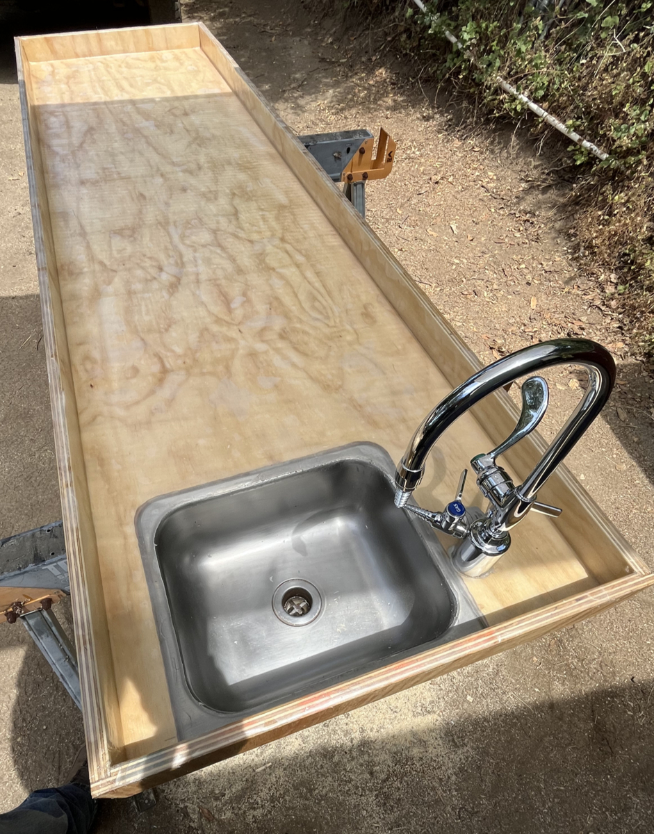

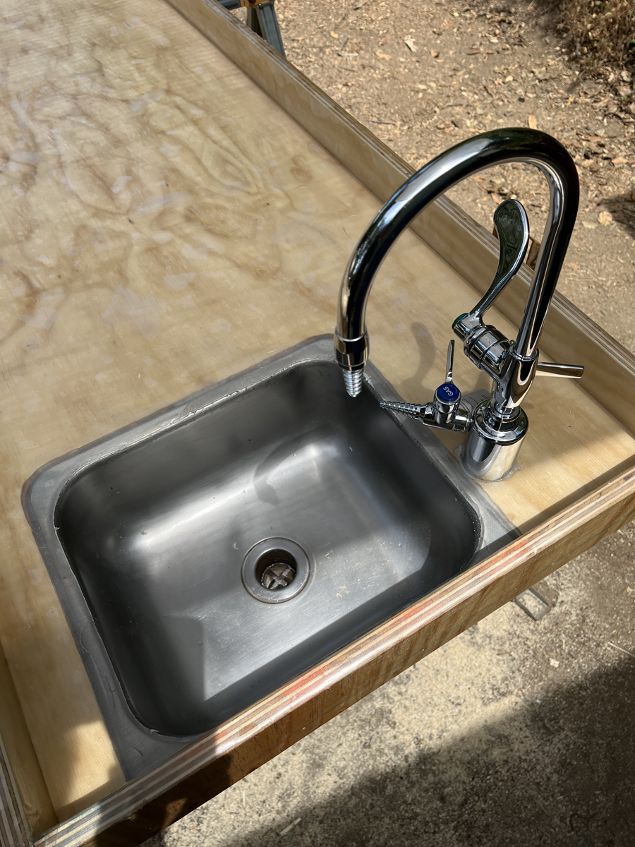

I just re-read the thread, and my only nitpick is that you have the faucet mounted down in the main "tray" of the sink where it could see regular immersion in water/chemicals. Since you salvaged a lab faucet this may be ok (might be much better and/or thicker coatings on the base metal)?
Or, you may not have the available space to mount the faucet above the "rim" of your overall sink. Either way, I still think it's a simple and effective design.

The faucet is a heavy USA Lab faucet probably made 20 years ago and never installed. It likely laid around in someone's shop and picked up a few dings on the threaded shaft which I had the tools to fix. If I had to guess the current price is probably above $300 and could sit in photo chemicals for years with no effect. It is sealed to the fiberglass with Silicone. The tray part is for developing trays and tanks and is never filled with liquid, just watertight for wash down. The stainless steel sink won't be filled with liquid either. I needed a place to mix chemicals and for the wash water to go. This is for B&W only and I use an immersion heater for tempering.
I had a similar but smaller tray for 11x14 developing trays and I was looking for a large sink to hold 4 Yankee deep tanks, no luck. The bar sink was free so I changed plans. The deep film tanks can sit off to the side when I use 11x14 trays, there is room now.
Restaurant stainless can be a great deal but usually takes more space as you have to go larger to fit your trays and tanks. With plywood I went wall to wall to wall with just enough room to open the door. I trimmed the bar sink with this tool. BAUER5 Amp, 14 gauge Metal Shears (977) It could work to reshape your restaurant finds. Also TIG welding isn't the only way to do Stainless, 57% Silver Solder (brazing) will also work. Oxy-Acetylene is ideal but Oxy anything will work.

One thought - I know the hose to the gas valve for the tray siphon is well secured by friction with the tube stretch and ribs on the nozzle, but being paranoid when it comes to leaks (from many experiences), I'd likely put a hose clamp around that connection.
Yeah, these valves are solid brass with real old school chrome plating. As long as you don't expose it to elemental Chlorine gas you will be fine 🙂 👌
I'd be more worried about the salvaged sink (and more specifically the drain) not being up to suitable spec (304, ideally 316 stainless) - they will disintegrate alarmingly fast if they aren't.
The barb is actually a serious piece of equipment and it's very hard to get the hose off. I also have a shutoff on the outside of the darkroom to shut off the water when not in use.
The sink survived an artist's studio. Mixing and wash water is what it is for. I don't intend to dump chemistry here. I need the height of the faucet above the sink to mix chemistry. I was mixing in the kitchen and carrying it across the yard.
If it had survived a professional kitchen, it would be more likely to be the right grade - if it isn't, you'll get a very rapid lesson in halide caused stress corrosion & cracking. Chemical resistant plastics have been the first preference for a great deal of printmaking and darkroom process sinks over here for quite some time as they effectively eliminate any chance of a weld or drain not being up to spec.

No welds, it's a stamped, one piece. Drain is plastic.
