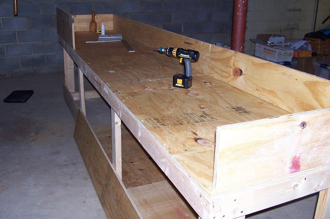

I'm building a sink and when I set it up to see how it all fits the sides seem a little high. Right now they are 8" and I'm wondering if that's deeper than usual. I know that most of this is how it feels to me but I can't help but wonder if there's a starting point with sink depth.
Thanks in advance.
Alan.

Starting point would be 0". :D:D
I have had sinks from 4" to 12" deep. I guess it might depend on what you want to use it for. I would feel comfortable with 8" for general purpose use. If I was using them for hand processing prints, I would use about 5" sides, with a deeper one for washing.

I should have added that I process film in Jobo tanks and the sink is for developing prints and washing/toning. I'll see if I can grab some photos...

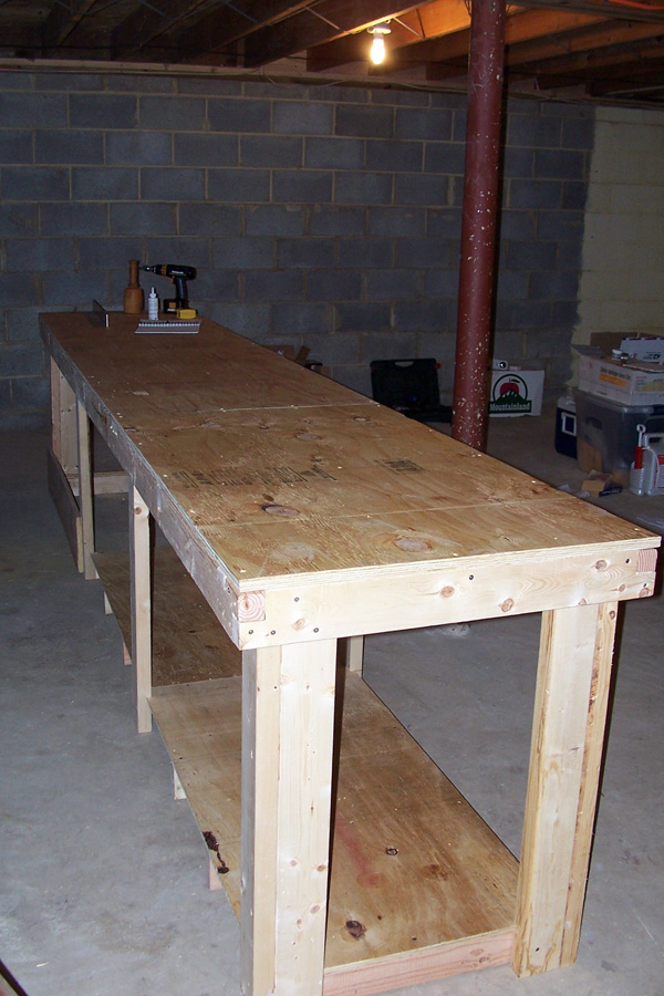

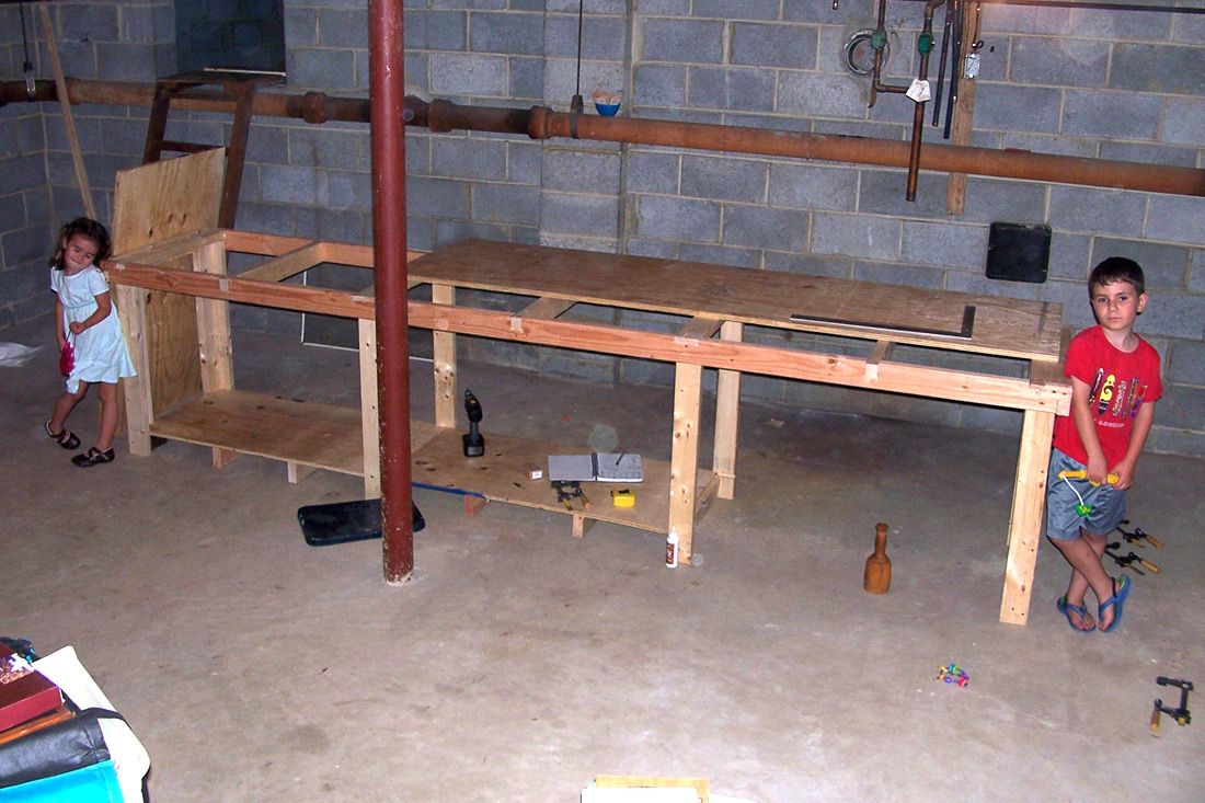

photos
Here are the photos...

For me, 8" is too high. The front of my sink is about 4" and the back about 8. If you plan it right, you can rest your forearm on the edge, esp if you add a wide,rounded lip on it, while rocking your trays during a printing session. One other thing I may try add to my sink stand is a foot rail for putting a foot up during long developing runs. ymmv of course :wink:
btw, that's a nice long sink you're building, lots of room for everything.
