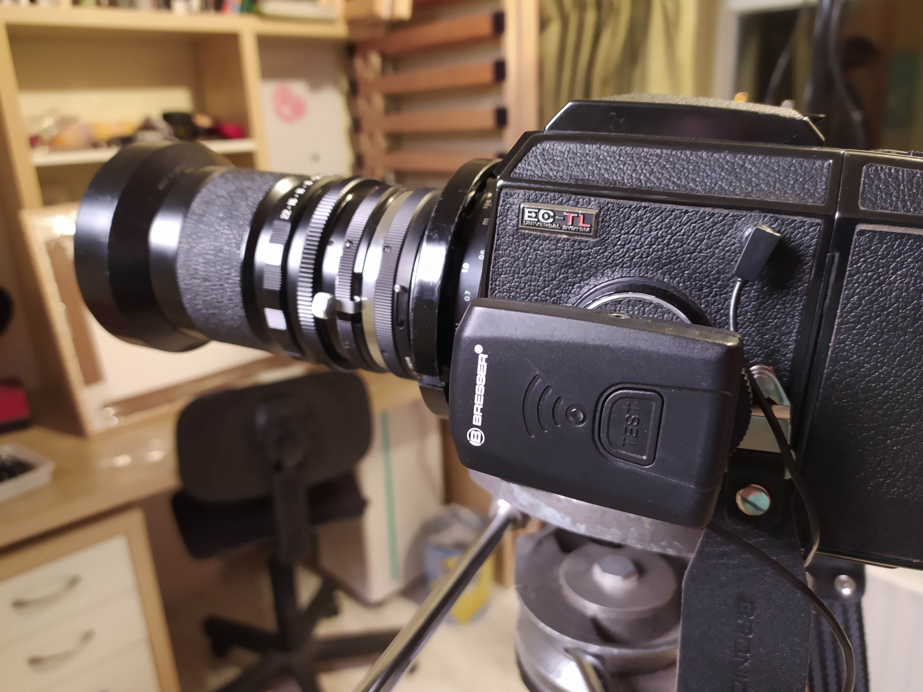

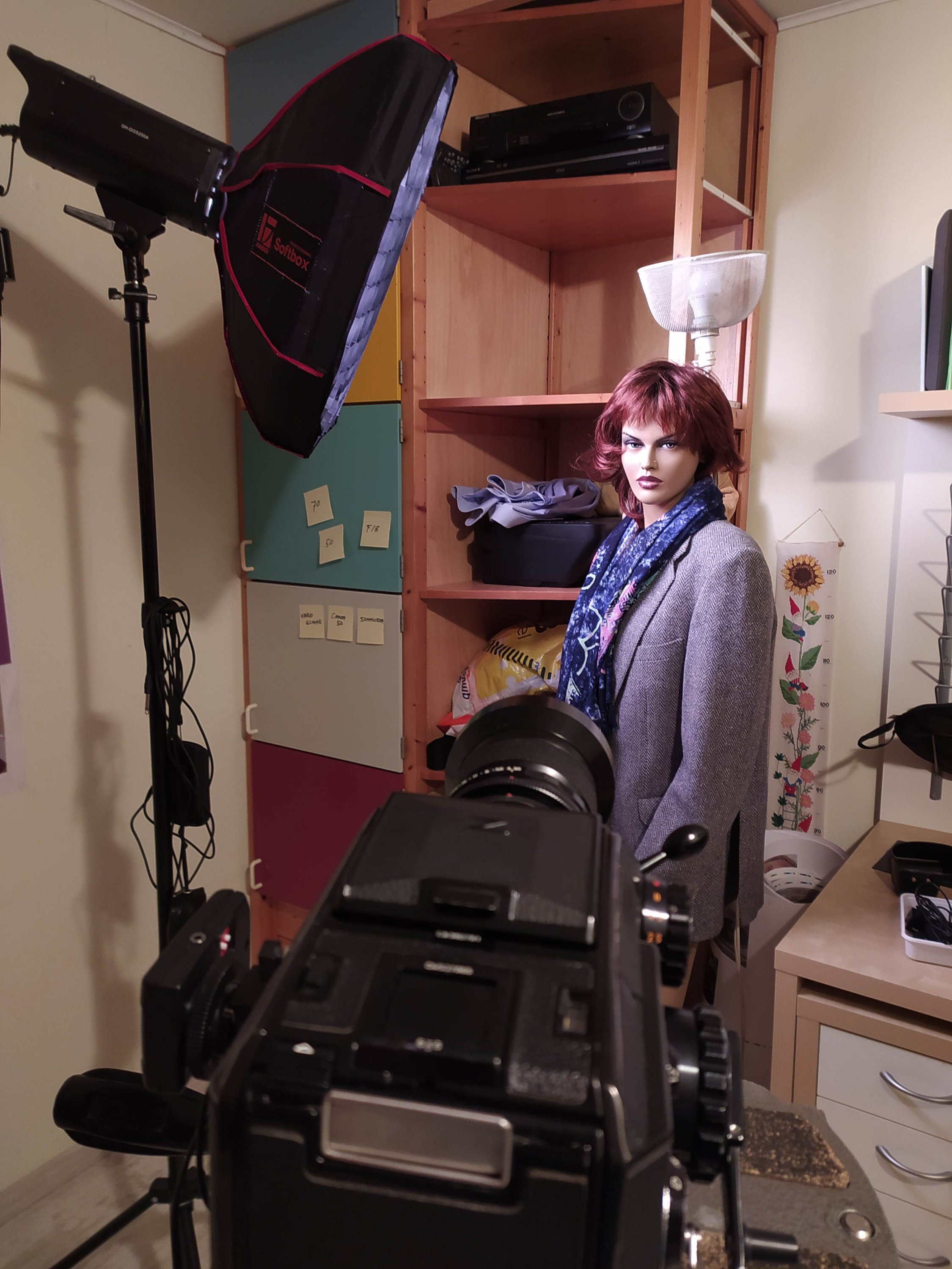

This is my setup: studio flash with modeling light, soft box with diffuser and grid, wireless trigger set, trigger in accessory hotshoe with connection cable to the PC connector. Works fine! I'd really recommend a studio flash, not a speedlight: the modeling light enables you to direct the light and see the effect on the model. Without modeling light there is no way you can see upfront how the light will work out. Second hand studio flashes are easy and cheap to find, in my experience.

The hot shoe on my EC-TL is indeed a standard hot shoe with PC cord.
