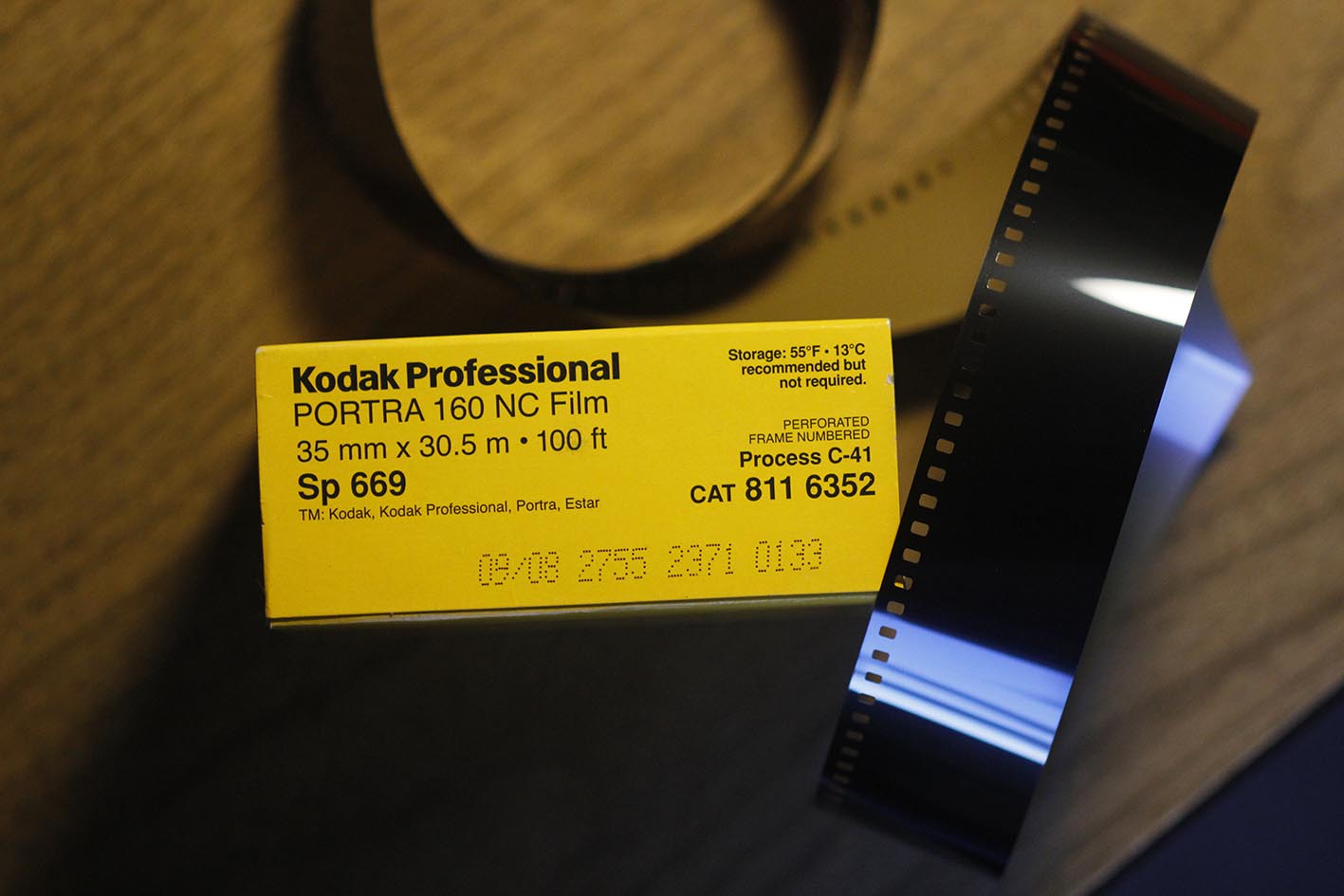

I recently purchased some 100' bulk film rolls of 35mm from someone locally. They were a good price, but I never asked why. I found out now upon opening them, that they are only perforated along one edge. There is no indication on the box that it is only single perfed, so didn't even know to ask!
How do I shoot this stuff (what camera)? My canon EOS auto-winds a bit out of the cassette onto the take up spool, and then flashes the "not loaded correctly" indicator.

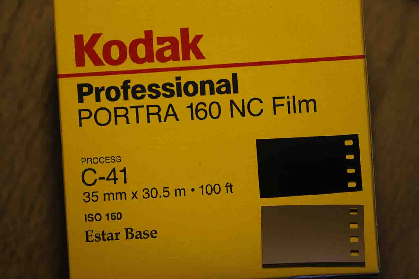

There's always the picture. :surprised:
Are these pictures on the box? Looked to me like snippets from the actual film put on the box by the TO to illustrate ... Maybe I need a new display ... or maybe new eyes ...!!
BrianShaw
Nov 30, 2005
16,346
La-la-land
I had to look twice... but I think that to the right of "C-41" and "100 ft" is a picture on the box. Below that is certainly a snippet. Maybe I'm incorrect, of course. I know for certain that I could use a new display and new eyes!

SP 669 on the box is the Kodak "Specification number" - that is how you tell what the film is like even though nowhere on the box does it tell you it's single perforated. Of course that also requires you to have a list of all the SP numbers and good luck with that! They exist, and the various options are generally included on the spec sheet for any given film, but when talking about older outdated film it gets really tricky.
SP 402 is the standard spec for 100' bulk load Kodak 35mm still film. I don't have the description handy, but it will specify that it's 35mm, wound emulsion in on a small plastic core, double-perforated with Kodak perfs, etc. SP669, if you could track it down, would obviously specify single-perfs.
Both of those are small pieces of film I clipped off and placed on the box to demonstrate the simple perforations. The top one is upside down, and I can see how the black AH layer makes it look like it's printed on the box.

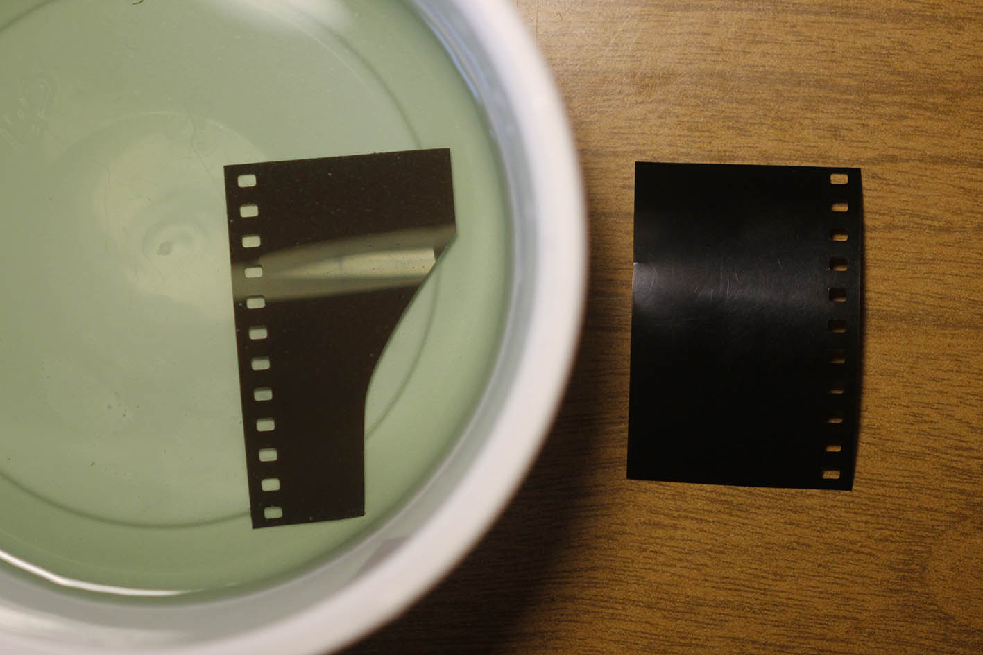

I'd be curious to know if that black AH layer is RemJet...
No remjet. Left is a piece of the film soaking in sodium bicarbonate solution. Right is a piece of film before soaking. It says "Process C-41" on the box, which doesn't have a RemJet step.
