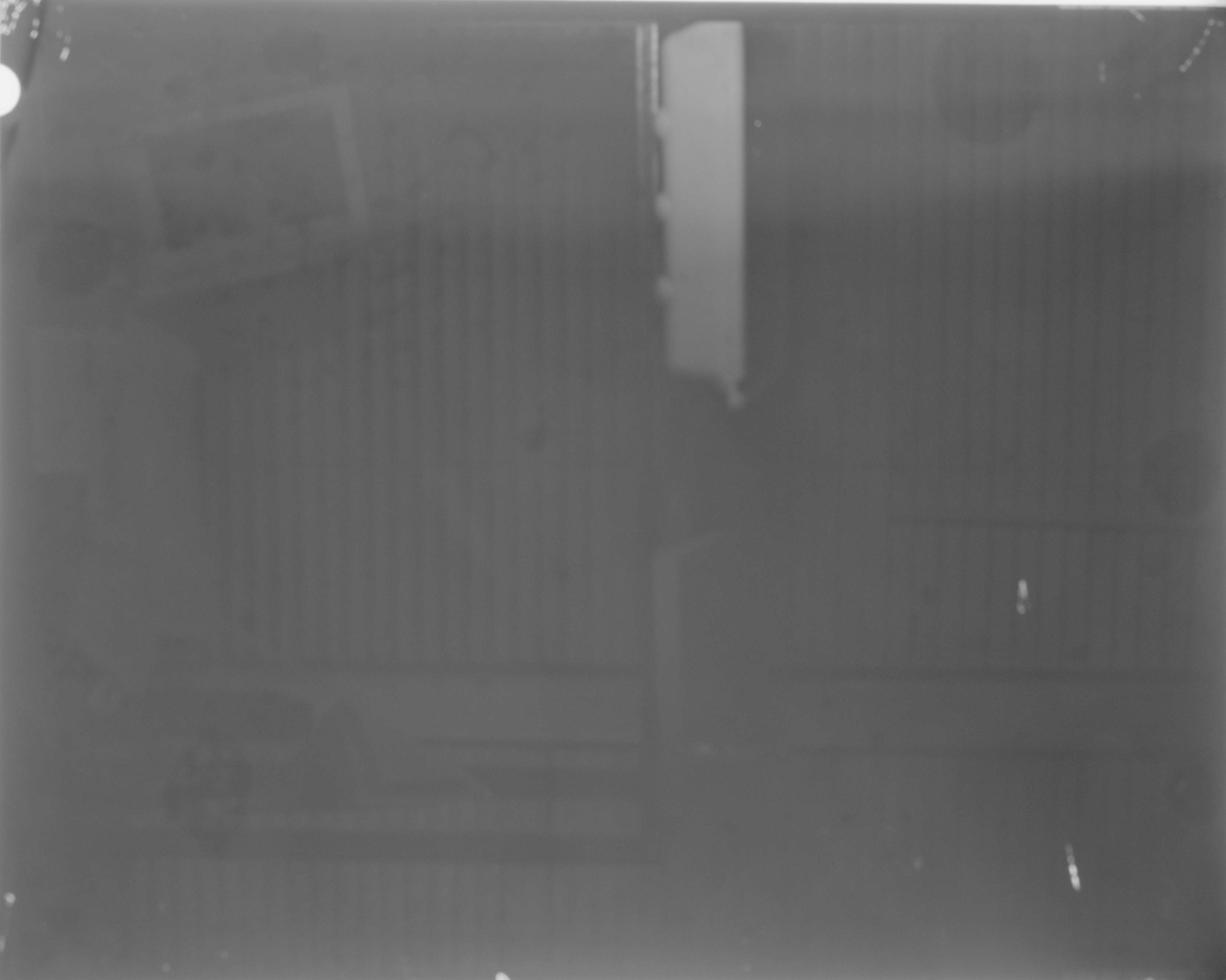

attached is a "scan" of a red slide, and the "blue/green" slide (the scan quality is of absolutely trash quality, I can't be bothered to get a nice scan of a crap image, these are done with a $5 nikon lens, a rebel from 2014, and my shaky hands.)
I have a number of chemistry related issues to solve on top of these, push processing my red slide properly is one of them, but those I can work through, and clearly I need to take better care of my negs when 40C liquids are involved.

attached is a "scan" of a red slide (the scan quality is of absolutely trash quality, I can't be bothered to get a nice scan of a crap image.)
Boosted contrast:
Sorry, I don't know what we're looking at.
