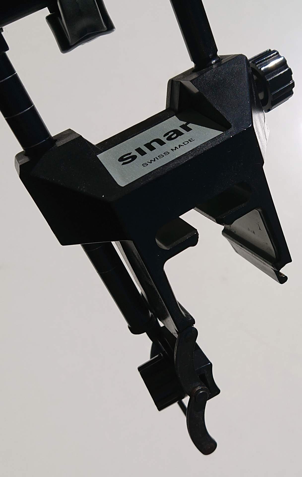

I'm far from an expert, but it looks like an F (not F2) becuase of the silver trim. It also looks like a rear standard because it has a focusing knob (the F only had fine focus on the rear.) Also the F front had a different base that could hinge out of the way. I know the Norma had a special standard that was really only for supporting bellows and special type setups, but I don't know if they had the same thing for the F. That said, since the stardards have the same mount on both sides, I'm 95% sure you could use it as a middle standard to join two bellows.

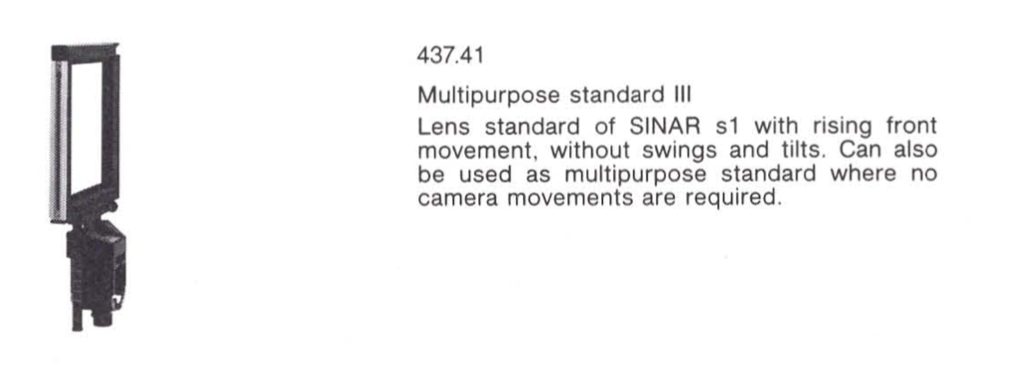

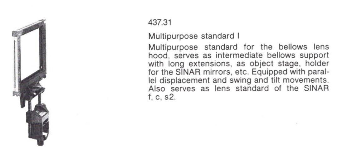

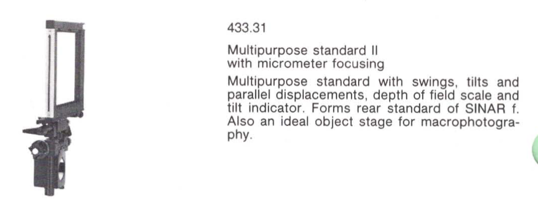

I did a quick check of the "catalogs" and it looks like there was a intermediate standard for the F series. Actually there were three standards:
I is the normal front standard, II is the rear stanrard, and III only does rise and fall and is the usual middle standard. The one in your link is a II, but it can be used like a III if you like.

It says it’s the rear standard. On my P, I use a regular front standard from an F as the intermediate. I think any of them will work, but the multipurpose is probably lighter.

It's a rear standard but you can use it perfectly fine as a middle standard. I've done this.

Yup. Rear. Same one as I have.
