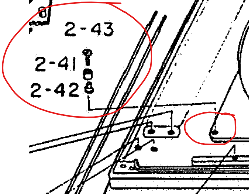

The Charge Lever Assembly needs to strike a release roller at the end of its travel - this disconnects the CLA from Tension Ring Assembly and the shutter fires.
On my copy the release roller - parts 2-41. 2-42 and 2-43 are missing (it looks like they've broken off) : Missing Roller
See the attached screenshot from the service manual for the missing roller.

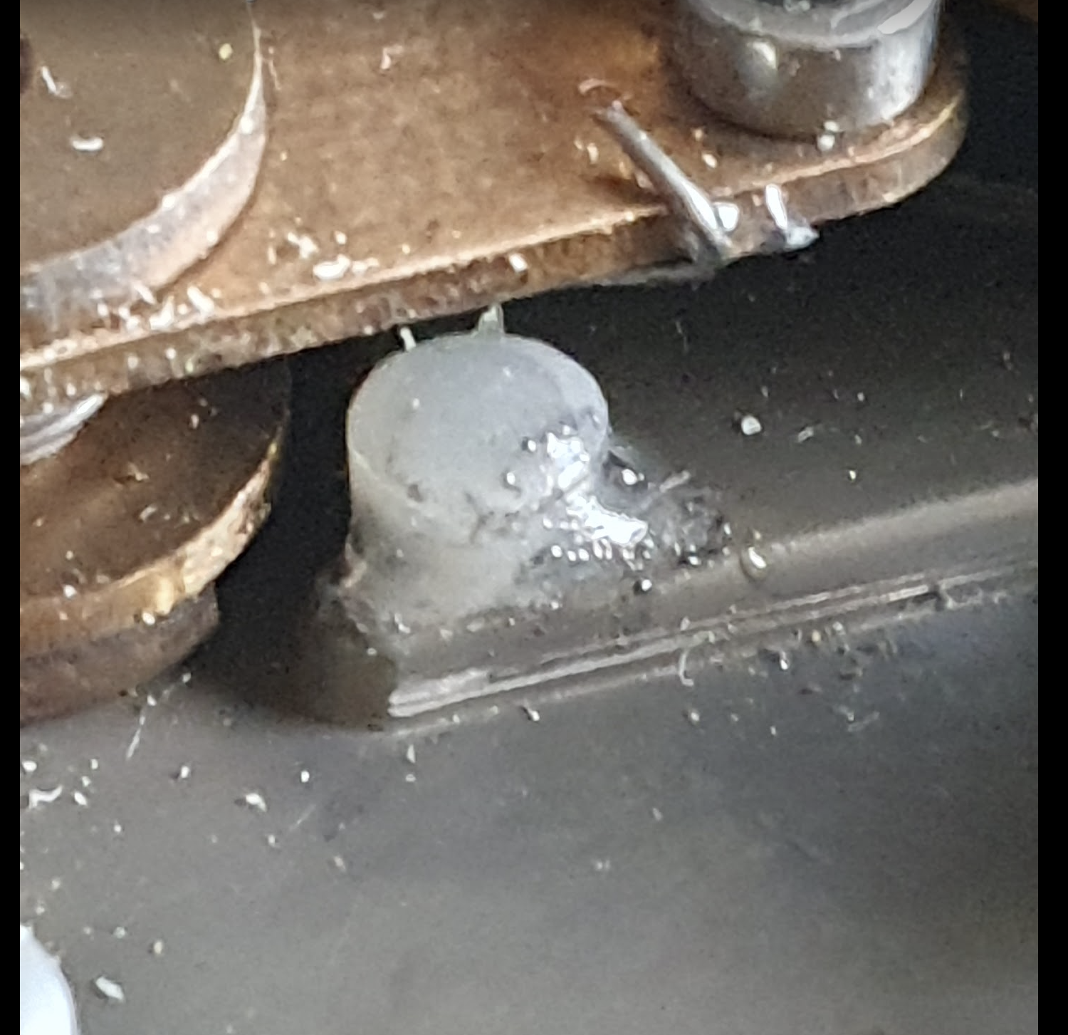

I've fixed it - at least in the short term - by flooding a small plastic washer maybe 2mm deep by 3mm wide with epoxy resin glue in the place where the roller once stood. I left it to set for 2 hours.
On return it worked immediately with the Charge Level Assembly meeting the stop and disconnecting at the end of the stroke and firing the shutter. Very satisfying!
Then on the side that meets the Charge Level Assembly I've added a little grease to counter-act the stickyness of the expoxy.
I wonder if it will stand up to constant use, but with the price of sheet film, it's not going to get constant use!
