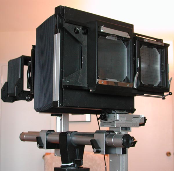

If it's the same one I have, there's a lever on the bottom with a knob, and you have to raise the lever to slide from the viewing side to the shooting side. Also, on the shooting side, you need to use an older, non-metering 4x5" back, if you want a groundglass back on the right side, otherwise it won't work in the horizontal position.
Also, you might look at the stops on the rod used for sliding from one side to the other to make sure they are in the right place, if it's not working properly. Once you see how the stops work, the operation of the back should be clear.
I also think this back doesn't work with the F, because the lever on the back interferes with the swing lever on the rear standard, or something along those lines.
I use it on my 8x10" P with a Norma-era 8x10 to 4x5" reducing back as shown in the attachment.

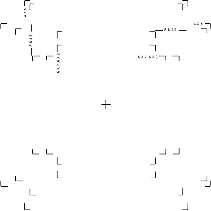

I've also attached a grid overlay that can be printed out on overhead projector film for the groundglass on the left side. I adapted it from one of Dave Parker's overlays on www.satinsnowglass.com

Thank you David. I dont think mine is the same as yours. Here is a link to the auction: http://cgi.ebay.com/ws/eBayISAPI.dll?ViewItem&rd=1&item=130140888852&ssPageName=STRK:MEWN:IT&ih=003
As you can see it looks different from the one in your picture. But exactly like the one on the king-platypus site from the link in my first post.
The tab to the left(bottom) is for unlocking it when it has been slid to the viewing position, and the lever on the right seems to be for unlocking the graflok holder. I have no clue what the silver thing on the left is for, maybe for the auto-shutter but I dont know as ive never seen one.
I use it on a Norma and it works on both vertical and horizontal. My only gripe with it is that it doesnt seem to lock in the taking position, and the weight of the rollholder is enough for it to slip down a bit if its mounted for horizontal taking. This is a minor problem though as i can mount it the other way, so that it slides downwards.
I wonder if it was designed this way or if it was supposed to be held up by friction and stuff has got worn over the years.

Interesting. That's different from mine. It looks like it takes the small Graflex and probably RB67 backs. The silver thing on the left is probably for the auto-shutter. It should stop down the aperture when the back is in the shooting position.
I suspect there's a stop and it might need some adjustment to hold the back in place in the horizontal position.
