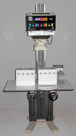

I'd look for an inexpensive enlarger.
When I was in the search mode I used "Search Tempest" (Craigs List search) and looked in a 3 to 5 hour driving-distance radius for a few months. I used search terms like "enlarger" "Durst" "Darkroom" "8x10" "De Vere"
Just for fun I punched in the search "Durst 8x10" and got this hit in a second:
$900 De Vere 5108
