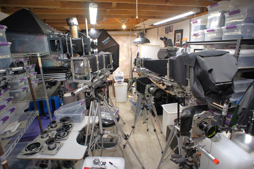

I have twelve Normas in my studio, plus about 90% of what they ever made for it. I've been collecting Norma stuff for nearly forty years. :smile:

Organizing the Studio by Nokton48, on Flickr

5x7 TLR Norma 360 Componon Peco Studio Stand by Nokton48, on Flickr

Nokton - are you sure that long setup is a Norma camera, and not some kind of linear neutron accelerator? The two-eyed thing is obviously from an alien landing site. ... and the blindfolded guy in a business suit? - obviously an alien abductee.
