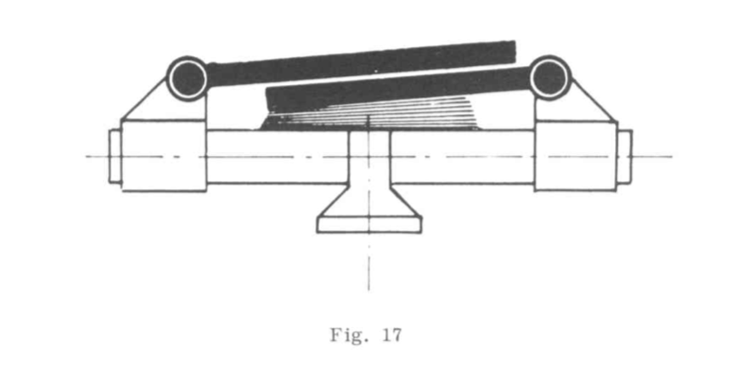

if you fold it this way:
The length will be a little over 12 inches since it uses the 12 inch base rail. The other dimensions are a bit harder to guess (Mine is packed away so I cant mesure at the moment) but maybe 8x8x12. BTW for a small lens like most 150mm lenses, you can easily leave the lens in place when folding, but don't try it with any of the Super Angulon style 90's (Super Angulon, Grandagon, Nikon SW, Fuji SW.)

I had my 4x5 Norma folded this way until a few days ago as I needed the front standard for my 8x10P. I found that to get it as compact as possible the front standard had to be the one on the bottom and the rear one on top (not indicated in cartoon above). There was not much space between the standards that I recall but possibly enough for a 90 Angulon (without Super in the name). One would need to be careful not to forces the lens close to the ground glass as it could break. One could insert a film holder to protect it but that would reduce the space available for a lens.

A couple of follow-ups:
- I just measured mine. Folded the total length is about 12.5 inches. Height (from the bottom of the tripod mount to the uppermost point) is 8 inches. Width is about 9 inches.
- I looked at the 150 I have in there, and looked online, and I'm afraid @Lachlan Young and @Focomatter are more correct than me. You can fit a 150 in there, but it has to be a small one. Mine is a Schneider Xenar 150/5.6 and it fits without removal. I know I've had a Schneider G-Claron 150/9 in there as well. But I think most plasmat's front element will be a bit too big.
EDIT: also just a side note I add another half inch to the height because I keep the bag bellows ounted to the rear standard where it acts as a mini dark cloth.
