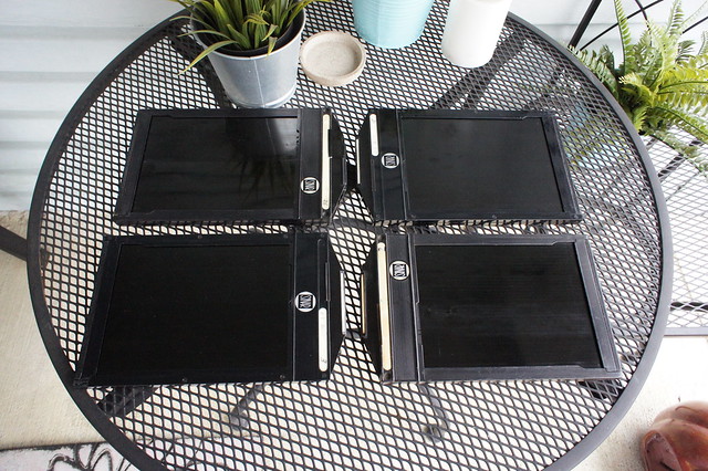

Sinar Norma 13x18 Planfilm Kassette by Nokton48, on Flickr
Anybody here know anything about these Norma era Sinar holders? These are 13cmx18cm Sinar Norma Planfilm Kassettes.
Any idea who made them? These held E-3 50 ASA film now that would be something to find.
Loaded with Fuji HRU XRay film these will make nice sized contact prints.
My Cambo 5x7" came with a dozen of 13x18cm holders and it's what I have... it has been stated that they are not useful 5x7" size film as the sheet may fall outside of the guides. This may happen depending on the dimesions each (film/holders) manufacturer uses/used and there is a variability from tolerance...
I addressed that by placing a narrow 1'2mm (IIRC) wide plastic strips (made with a cutter) inserted in the notches so the film won't move enough to fall. Another choice is converting the holder to Adhesive class, just spraying some 3M Re Mount glue in the septum.
In european countries 13x18cm was a popular very Pro format in the 1960s, 20x24cm was way less popular in most of the regions.

Thanks for that :smile:
Actually I have 9x12cm, 13x18cm, and 18x24cm Sinar Holders. Right now I am cutting down Fuji HRU XRay film to fit the smaller holders. In XRay single sided it seems to be all about metric 18x24cm as a minimum, and I have 18x24cm Sinar Norma holders which fit the big sheets perfectly. An 8x10 RC contact print from a 18x24cm sheet of film, with black border, is the goal. 13x18cm I will custom cut which is not difficult for me to do. I can get two 13x18cm negs from an 8x10 sheet of HRU, and then split 8x10 RC paper to contact print two of them, also with black border. For 9x12cm I simply split the 18x24cm into four 9x12cm quadrants.
