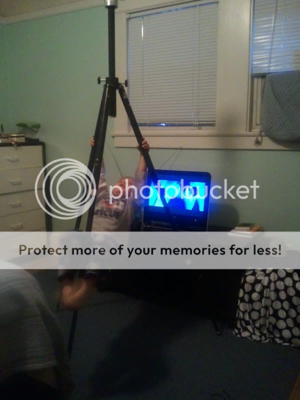

Well, I don't own a LF camera (yet) but I do have a Star-D copy of a tiltall and it is pretty strong. Reasonably steady as well, good enough for studio use.
Here is what I walked in on one night, had the tripod set up for some measurments and my son thought it was a jungle gym just for him...a testament to the strength of these!
