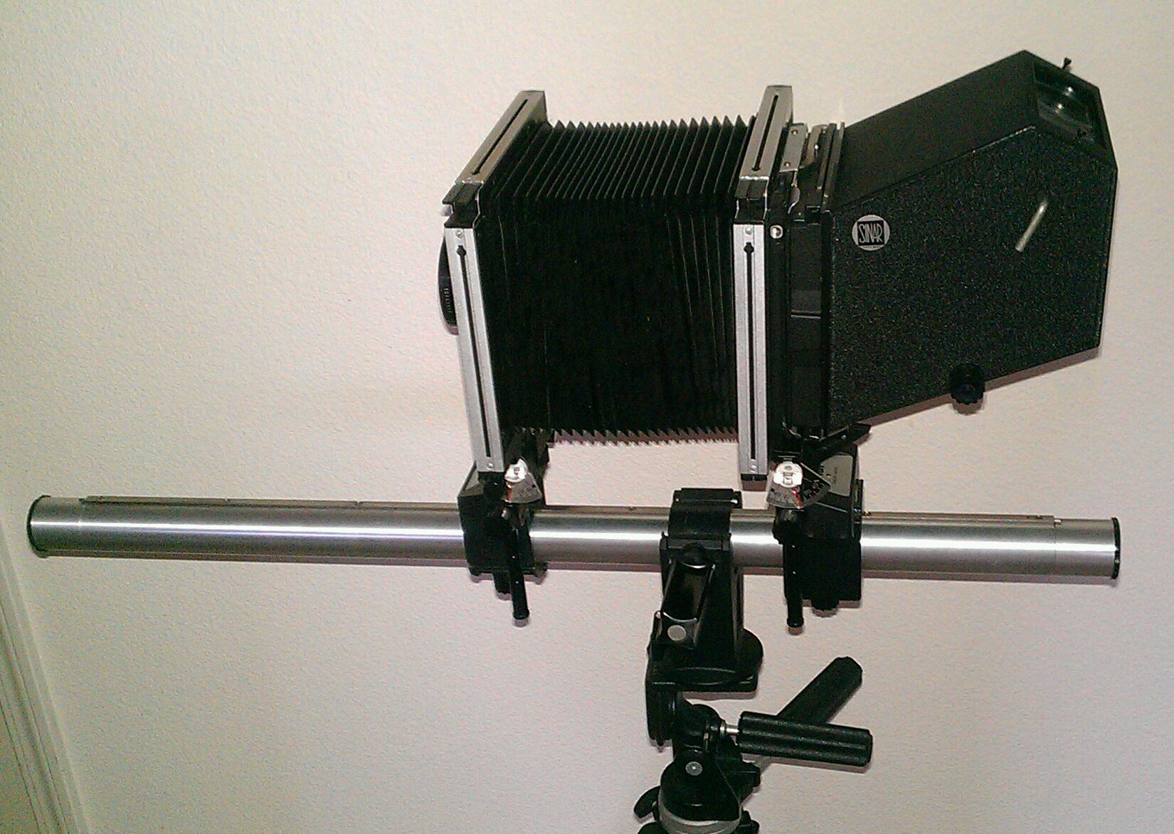

This is my Sinar F with the binocular reflex viewer. It also has a lever for 2x magnification of an area.
I don't know the part number, but it should work on an F2.
I'm now using a sturdier Gitzo tripod.
