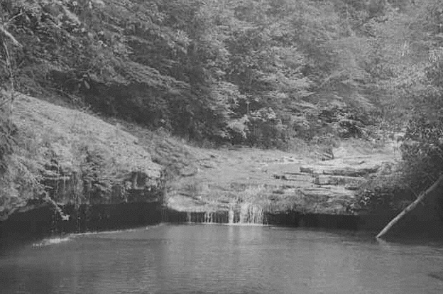

This is a printed-out/developed out image:
I soaked Oriental Seagull VCFB Warmtone II in Ilford Cooltone diluted 1+3 for 4 minutes, squeegied the paper onto glass, and exposed under the enlarger until the image grayed out. I then developed it in Neutrol WA 1:15 for six minutes.
It was an experiment, and it worked ok for what it was.
K.
