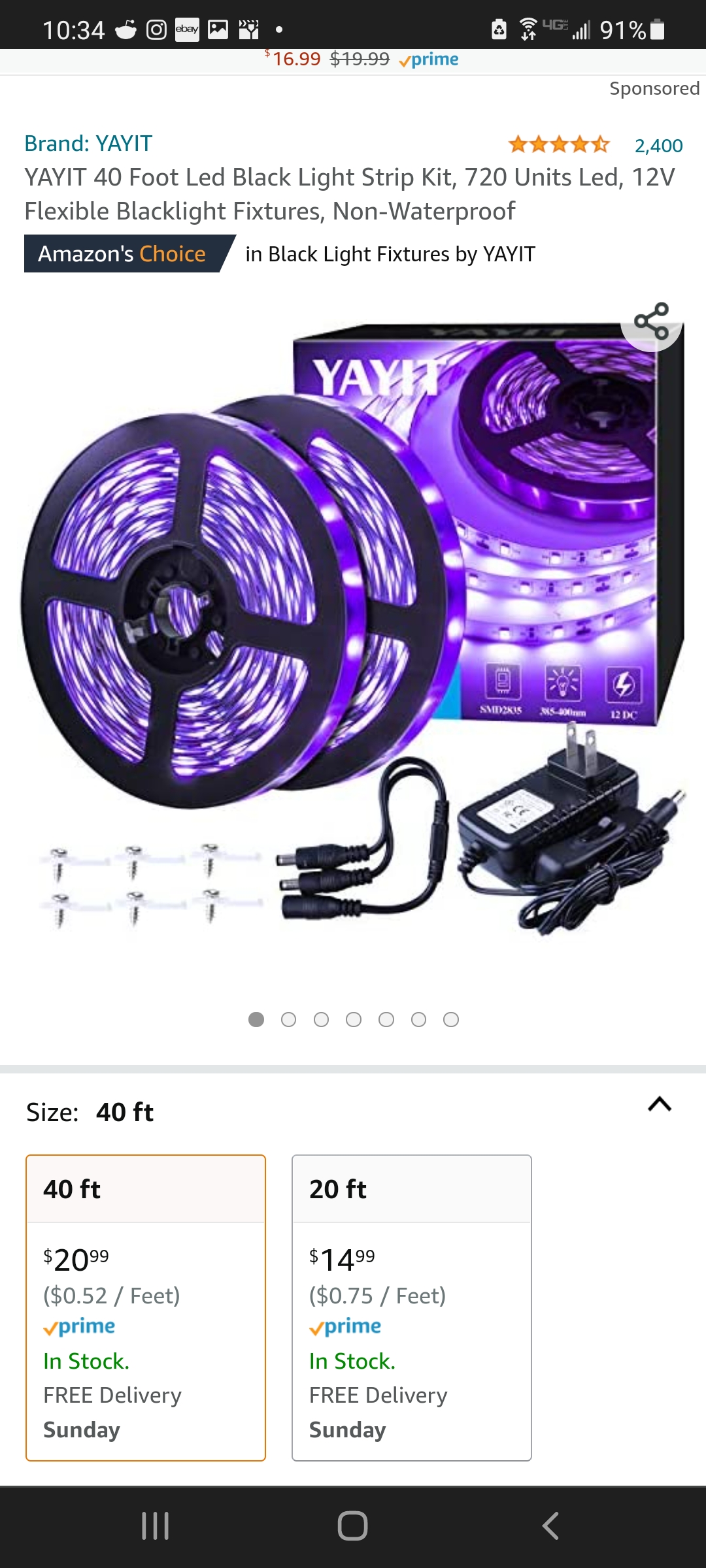

So the title pretty much has the question in it.
Are these the type of lights one would use to make a UV exposure box?

Ill be looking to use cyanotype and van dyke. Im realizing now these light strips arent the SMD 5050, but the lower powered ones. What do you think, pull the trigger on these or just go with smd5050?
