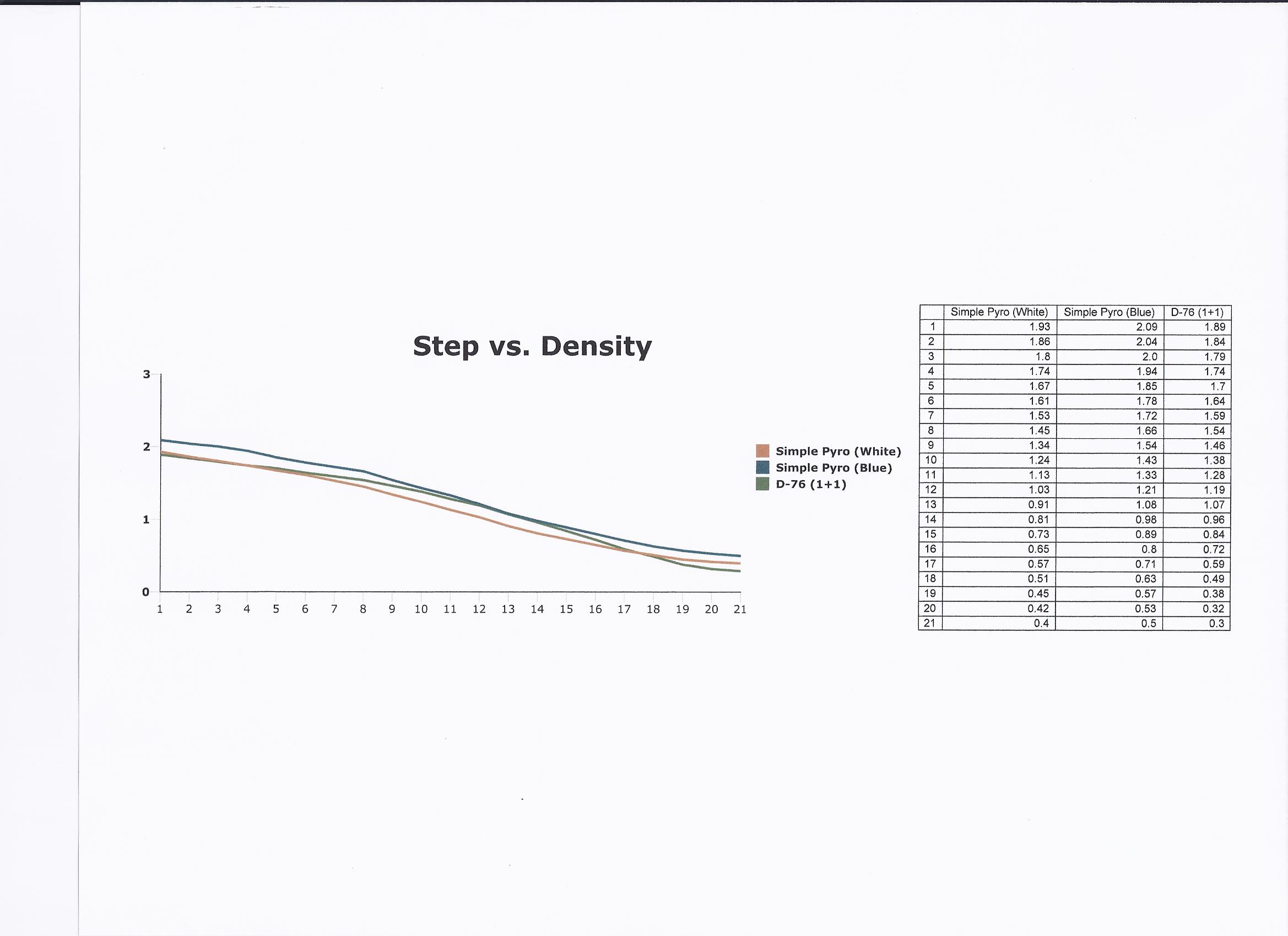

I finally got around to actually trying this developer. I tested it on EFKE PL-100M. I mixed it according to the recipe shown above, and developed the film for 9 minutes. For comparison, I also ran some of the same film in D-76 (1+1) for 10 minutes. My guesses about its life seem to be correct. The developer starts turning brown as soon as you add the TEA. When I poured the developer out after developing the film, it was a bright brownish-red. I'd say it's only good as a one-shot with a mixed life of an hour or so, but I haven't really tested this.
The developer produces very nice looking negatives with the characteristic yellow-green pyro stain. Densitometry shows it has slightly lower contrast and a longer straight line section than D-76 (1+1) with this film. I ran desitometry tests with both white and blue light (I do not have a UV densitometer.) The curves are almost exactly parallel, except at the highest densities. The stain seems to just add density, not contrast. Under 50X magnification, Simple Pyro produces negatives that are very slightly grainier than D-76 (1+1), but they are also noticeably sharper.
So based on your blue/white channel measurements it looks like general as opposed to imagewise stain. Would you say film speed is lower or about the same as D76 1+1?
You can get an idea from looking at the raw data. The density difference between the top an bottom step is 1.53 for white light and 1.59 for blue, so there is some image stain effect, but probably not much. King has pointed out, however, that effects can be greater in the ultraviolet. As for emulsion speed, there is no toe area to get real speed point measurement, but from the low density data I would estimate that D-76 gives about half a stop more speed than Simple Pyro. The step tablet exposures were based on EI 100, reading the light box intensity and opening up 5 stops. This works well enough to give useful curves, but there are enough uncalibrated things involved that I wouldn't rely on it for real speed measurements.
