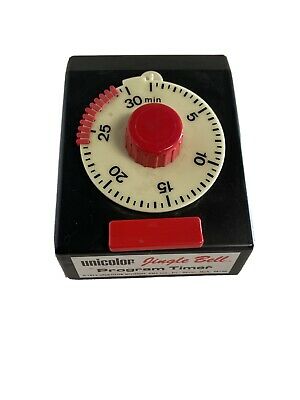

Si
I think this is one of the best. Except for the metal spring, the rest of the mechanism is all plastic.
I use a Graylab to time development (B&W) and the Jingle Bell times the other steps which only need to be 30sec accuracy.
Omega made a plug-in version that is similar. This one, of course, requires no electrical power.

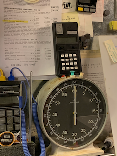

otra opción de vieja escuela son los crometros Jhungas
van algunas de las fotos de los equipos..

Another old-school option is the Junghans chrometers
Here are some photos of the teams.
