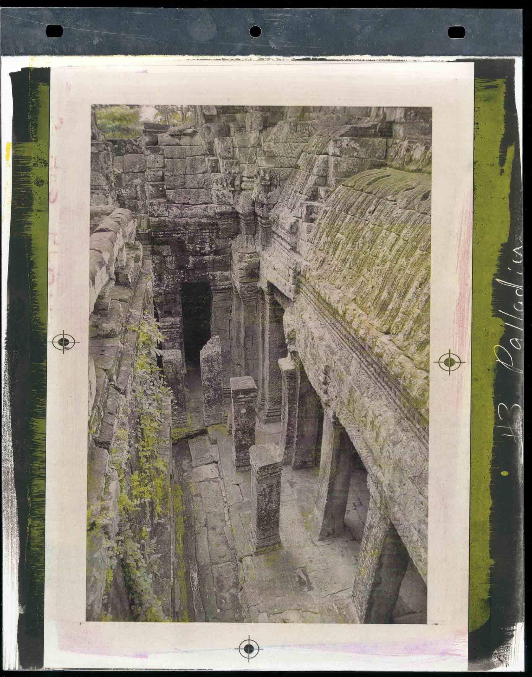

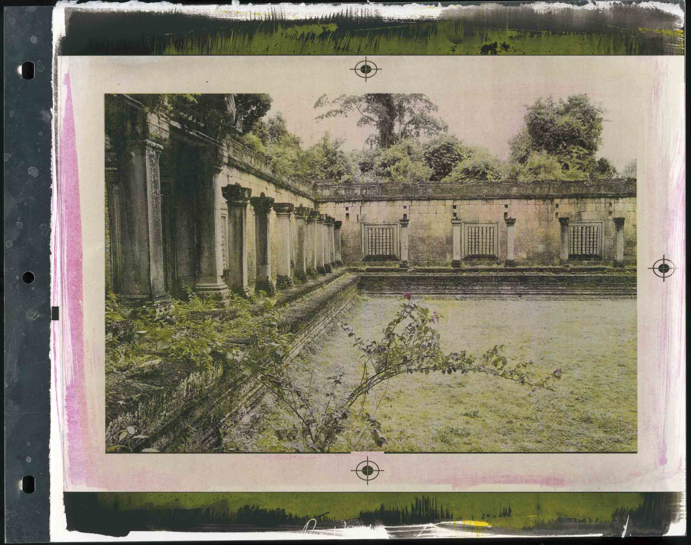

Bob Carnie
Apr 18, 2004
7,735
toronto
Med. Format RF
Image courtesy of Monica Glitz.
So here are two images almost completed .. As you can see the paper is mounted onto aluminum and in one case three layers of colour, the vertical image
we have only placed two colours.
aluminum is 11 x14 for sake of scale.

Bob, thanks for the kind words,it's been a while since I've done close registration but interestingly have been considering some color carbon prints and dug out my old register punch.
Ned when you get closer to doing your registered prints let me know.Somewhere in my collection(wife calls it junk) I think I have a 4X5 two hole register punch.It was/is attached to a large plate but could be moved to a smaller backing. It will work for 4X5 and 5X7 easily and could probably work for 8X10 if care was taken.
I'd be willing to loan it and a couple of pins to you for testing before you invest in a punch system and would allow you to know through experience what system you'd like.The system I used for years consisted of a hole pattern of an oblong hole on both sides and a round hole in the center spaced so 4X5 up to 8X10 could be punched(we actually used the punch on film up to 20X24) .Of course the smaller sizes would only have two holes.Strips of estar film would be punched and then attached to the working negatives/positives as the case might be.Then the unexposed film would be punched and placed on the pins and the afore mentioned pos/negs would be placed over the pins and drawn down with vacuum or a heavy piece of plate glass would be placed over the sandwich for good contact while exposing.
Any how good luck with your experiments and let me know if I can help.
Don
