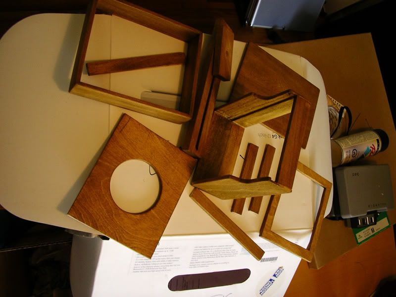

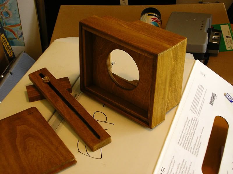

All the bits, unassembled:

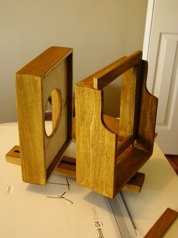

Ground glass frame partially removed:

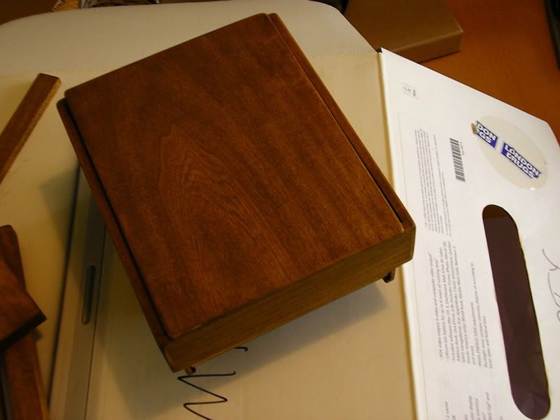

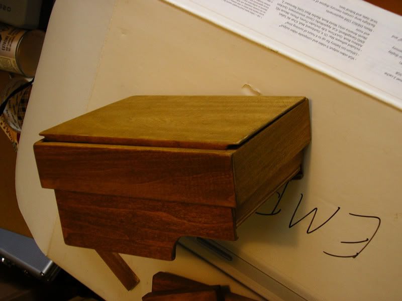

"Lid" installed in folded up configuration:
