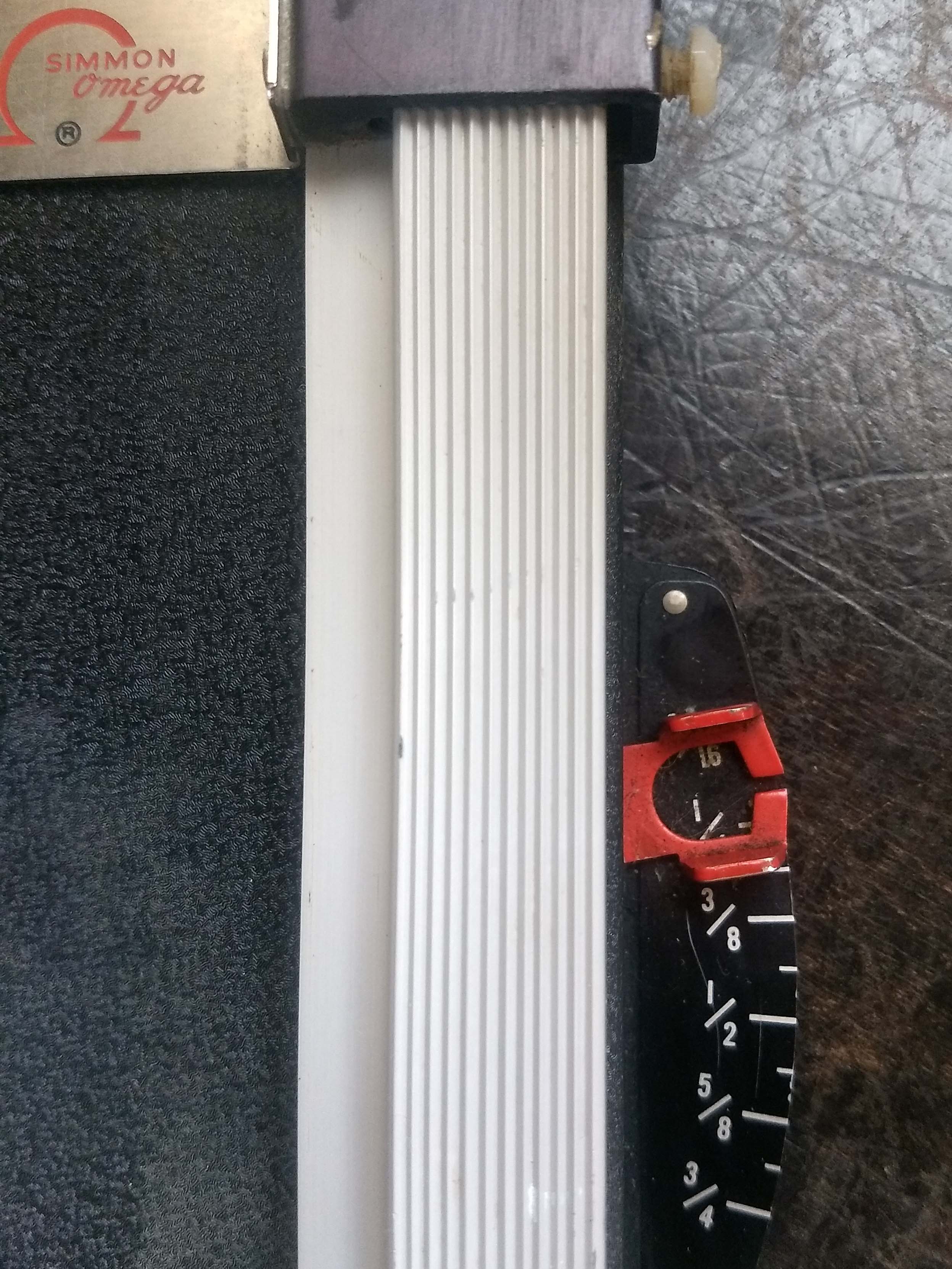

I can't move the margin setting on the Simon Omega 2 blade easel. It does not budge. Is there a locking mechanism? Or do I need open up the back to see if it has jammed.

Over the years, there may be a huge variety of easels that were labelled with the "Simmon Omega" brand. It might help if you posted more photos, showing the entire easel, both top and bottom. Perhaps open and closed as well.
If there is a model number anywhere that might help as well.
i’ve used those off and on over the years, though haven’t seen one in a while. They were never easy to adjust, as I recall, so yours probably needs some internal attention, probably lubrication and cleaning.
I have one of these easels, like bdial I also seem to recall the margin setting was difficult to move. If I can find it easily I’ll check mine and see how it feels. I believe there were a bunch of things moving to make these margin adjustments under the paper surface. I found the Ganz Speed Ez-El a lot easier to use, so used the Omega infrequently.

If you can't adjust the margins with the control, you could probably adjust them smaller by adding a thin piece of something to the positioning surfaces.
