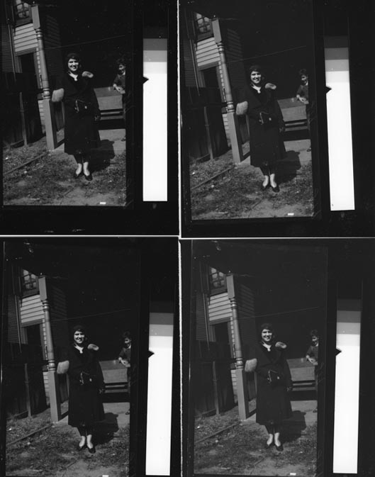

John, you are probably correct in all of your statements about the environmentally friendly nature of these products compared to others on the market. I can't say without knowing the contents which I do not. The only disturbing implication in your post is the one that I have lied or misrepresented the facts about the tray life or capacity of the developer.
I... DON'T... LIE!
As a scientist, I cannot afford to lie. I can err, being human, but I don't lie. So, that said, I would not have made my post without evidence. Here are 4 pictures, the two top ones are Dektol 1:3 and the two bottom ones are Tektol 1:9, just partway into the test. The origninal image quality of the Dektol example can be regained by extending development time, the Tektol cannot. These all had exactly the same development time. Both developers dropped in activity during the test, but the Dektol dropped less.
The test used 1 liter of each developer in an 8x10 tray. The test was conducted several times for different combinations of commercially available developers all of which performed more poorly than Dektol.
As you can see, the fresh Tektol performed as specified when fresh but fell off rapidly. It dropped in pH rather quickly during the time of the test. The Dektol did not drop significantly in pH.
PE

Developer lifetime is a function of exhaustion and pH drop caused by development and air (CO2 and Oxygen).
As such, I have run many many developer tests that have been verified by tests in the field. This test that I use is one we used at Kodak to 'certify' a developer, and developers using this method of initial testing have been sold for years. Why not use this test, it works and is quick and reliable. It is a good indicator of how the developer withstands actual use and keeping.
After posting this, I saw Dan's post and feel this is good point. If you are going to use Tektol for one session and a limited number of prints, there is absolutely no problem, but if you have a lot of prints, and/or are called away from a session, then you can begin to see differences that can be compensated for with Dektol but may not be with Tektol.
If you run sessions requring identical prints from start to finish, this is where tray life and capacity come to the fore. You will see this in large jobs or long jobs. There appears to be little safety factor when compared to Dektol.
I stress again that fresh, it performs as advertized. This may or may not be important to you. I am putting this data on the table for those who may find it important.
PE

With reference to some questions I've had put to me or seen posted, ie, 'why would someone use this type of test?', I've thought that I should post an answer.
In R&D, often one does not have a lot of a new chemical or coating. Due to expense, you may often have 10 grams or less of a new developing agent or stabilzer, or 10 feet or so of a 4.5" coating. Therefore, it is necessary for the research scientists involved to develop an economical method of testing coatings or chemicals. It helps if the test can be done quickly due to R&D time scales.
Therefore, the test described above, the open tray keeping was developed to meet the needs of the R&D community with limited supplies of chemistry and/or coatings.
So, the test above was designed to work with a minimum amount of developer and paper, and was verified to be a reliable benchmark. The length of the test was established to determine safety factor and recovery factor (the ability to adjust development time to get back what was lost by keeping) which was always paramount in Kodak's philosophy of design for developer capacity, fixer capacity or even coating expiration date.
This is not meant to give you license to go overboard in pushing things, but there is the reasoning behind my testing methodology.
