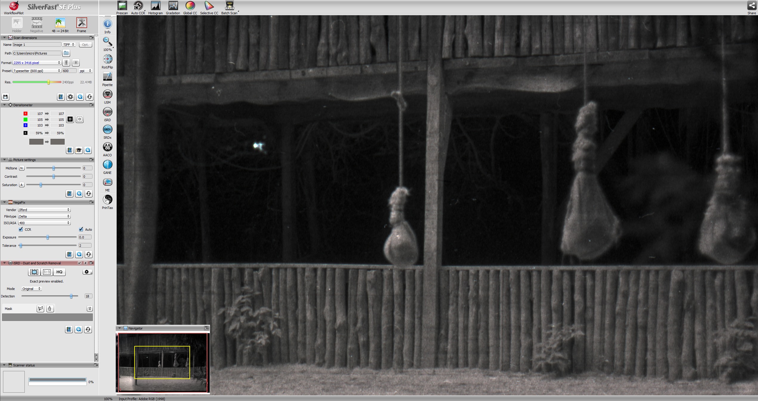

I'm struggling to use Silverfast's iSRD feature. I have a rather dusty roll of 135 to scan and after physically removing as much dust as possible, I want the scanner to do it's best to remove the dust digitally. But when I enable the iSRD thing it just gives a preview with weird geometric shapes in it:
With iSRD off:

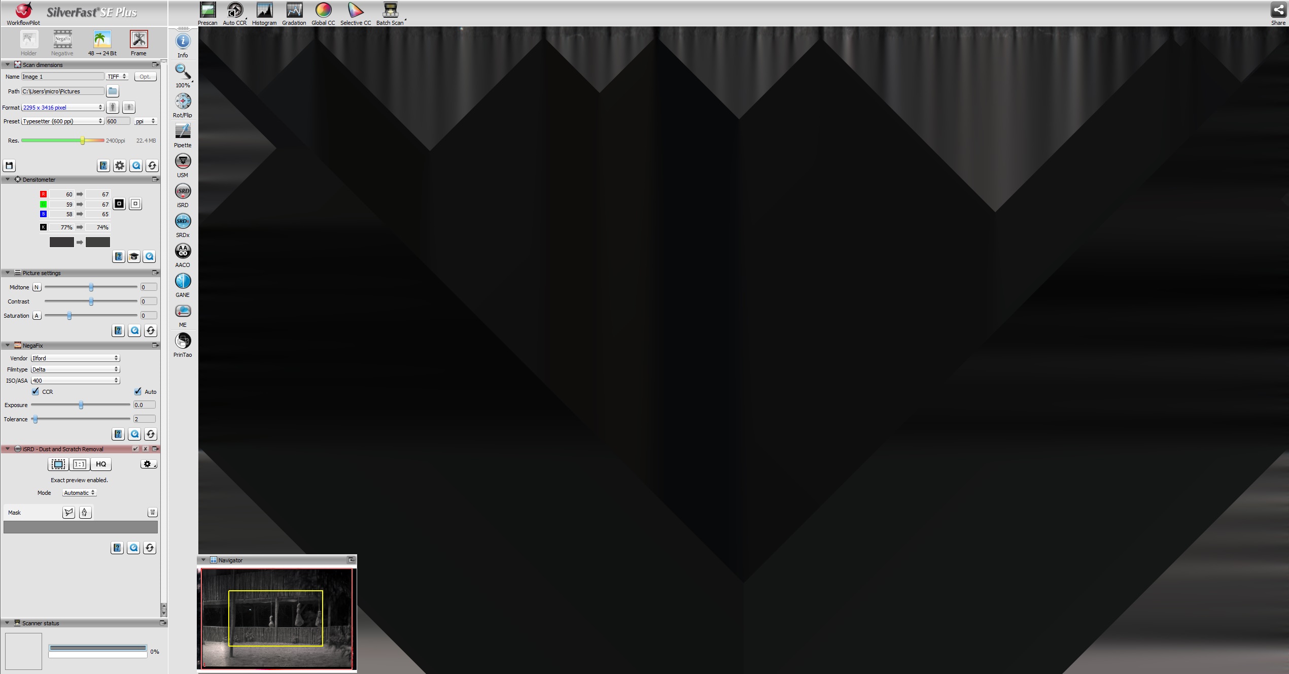

And then when I change the mode to "Automatic":
Other modes don't fare any better: "mark" just gives me a red screen.
Anyone any idea how to use this damn thing? The manual is typically useless.
Is this an ICE-enabled scanner that relies on an additional IR capture to determine where the dust is? If so, do you realize this does not work on regular B&W film? It's designed to work with dye-based film; i.e. color film and chromogenic B&W film.
brbo
Dec 28, 2011
2,327
EU
iSRD won't work on BW film.
You need to use SRDx which is not hardware based (IR) and, of course, YMMV...
Stanbey
Stanbey
May 24, 2024
17
At my desk
Ah! Thanks for that! I did NOT realise that iSRD only worked with colour negatives. It would have saved me a lot of time if that critical little nugget of wisdom was mentioned in the app, or at least in the documentation...
