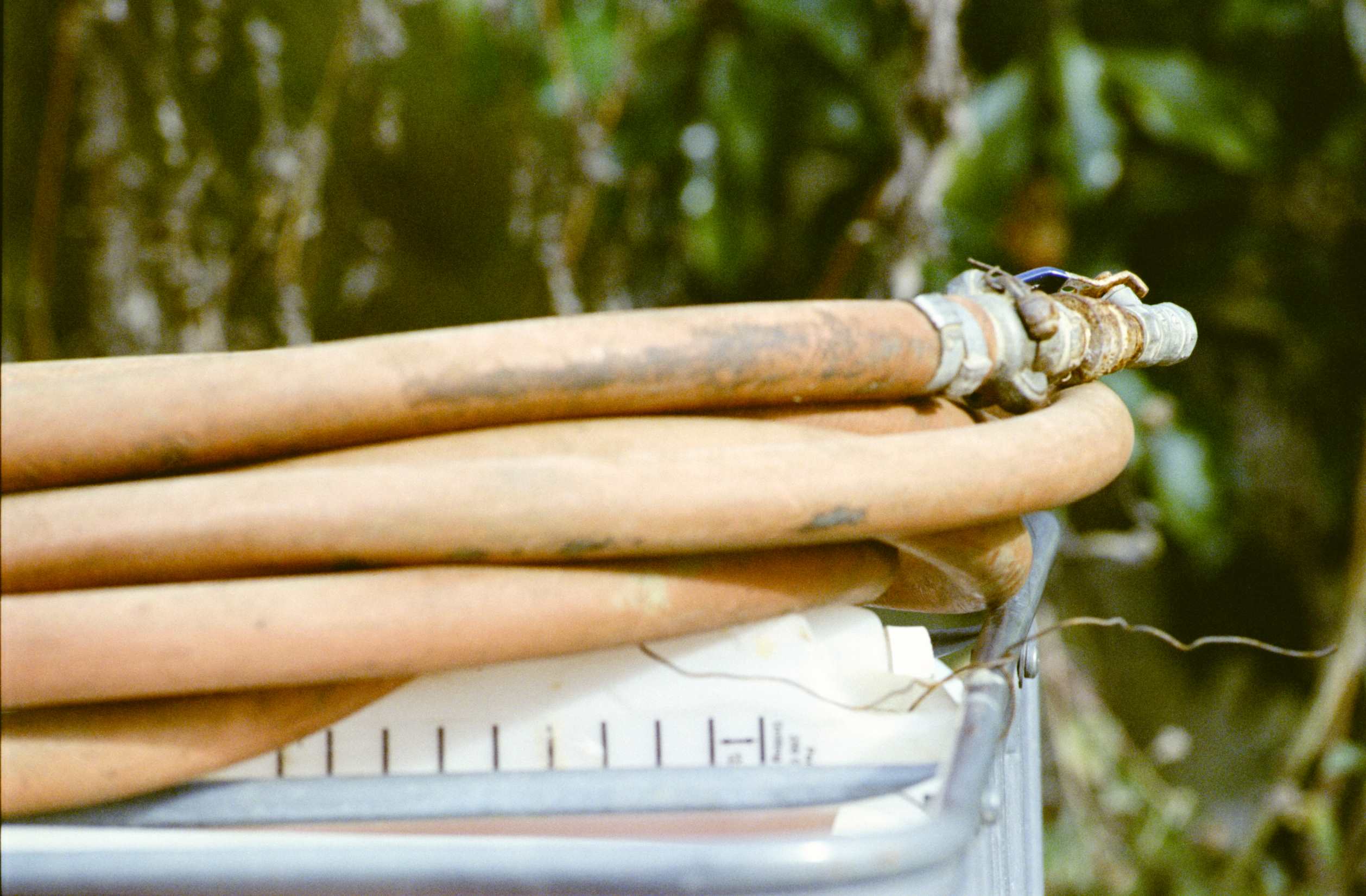

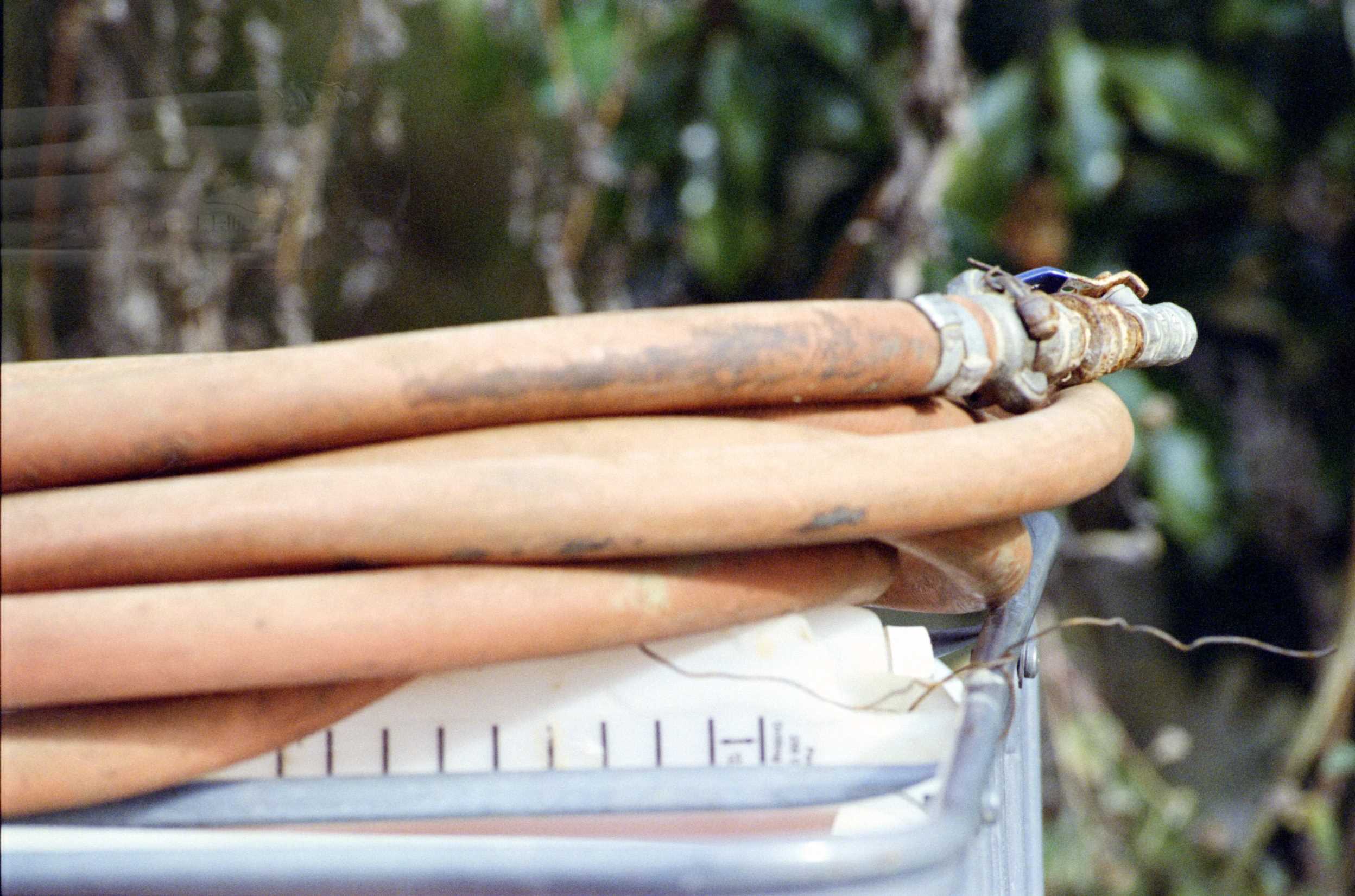

I scanned an an entire roll this way as .tif files, and noticed this when I started going through them. A faint ghost image in the upper left corner.
Converted .tif
OG Negative Image, scanned and saved as a .tif. I don't see the ghost image, at all.
Re-scanned as a jpg and converted as a jpg - no ghost image.
And the original negative, scanned and saved as a jpg.
I re-scanned the roll using vuescan (which takes 2x as long as SF), saved the scans as tifs and those conversions were great - no ghost images at all.
So....Does Silverfast save tifs with something extra in the format that imagemagick stumbles on?

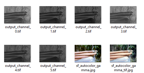

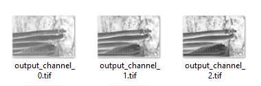

So, that's interesting. I used imagemagick to pull the channels out of the Vuescan negative tif. Three channels.
Silverfast has 6 channels in the tif. I think the conversion script is choking on the extra channels.

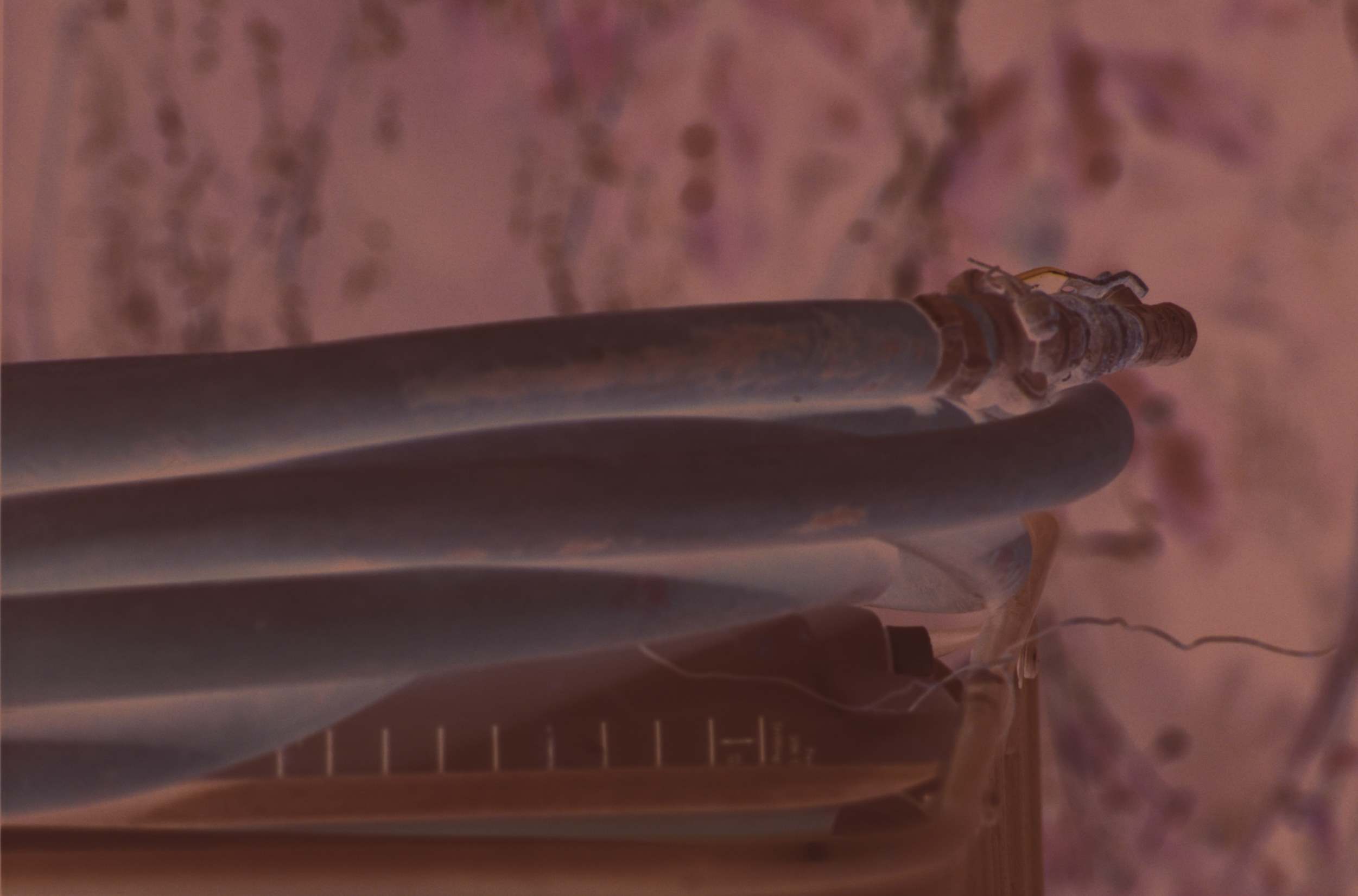

I combined the first three channels from silverfast (_0, _1, _2) and got this image:
Attempting to combine all 6 of the channels into an image resulted in a 'images are not the same size.' I guess that explains the slightly smaller ghost image in all the images.
