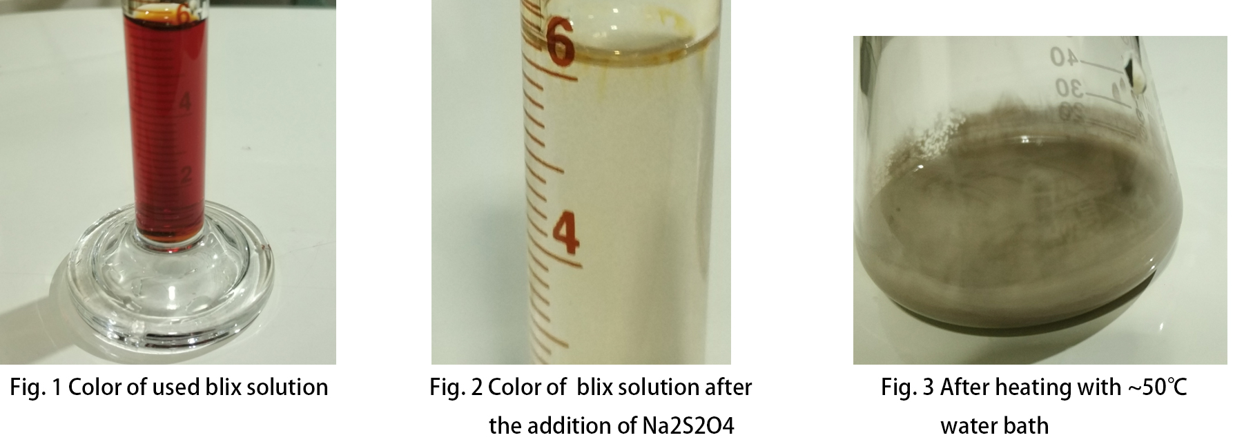

I've just carried out a small batch experiment with my blix. Here I used excessive sodium dithionite and heated the mixture to a higher temperature to accelerate the reduction speed. As shown in Fig. 2, you can see that at the surface between air and solution, some Fe(II) are oxidized to Fe(III). On the flask wall in Fig. 3, some silver is oxidized and redissolved into solution due to the air oxidation.So if you want to recover silver with Na2S2O4, you'd better carried out this procedure in an air-tight container or use excessive sodium dithionite.
To those oxidized blix and fixer, I'm not sure whether there is still some silver in it. You can test them with small batch experiment or use other analytical procedures (silver test strips, ISE, etc.) to determine the silver concentration. Oxidized fixer and blix can have lower pH value, which can weaken the reducibility of sodium ditihionite and cause it to decompose. So you'd better adjust pH to 6-7 in this process. Higher pH (>7) can promote the reducibility of sodium dithionite (theoretically), but to some fixer like F5 which contain potassium alum as a hardener, high pH can cause the precipitation of Al3+. To avoid decomposition of sodium dithionite, this compound should be added in batches and the temperature should not be too high.
