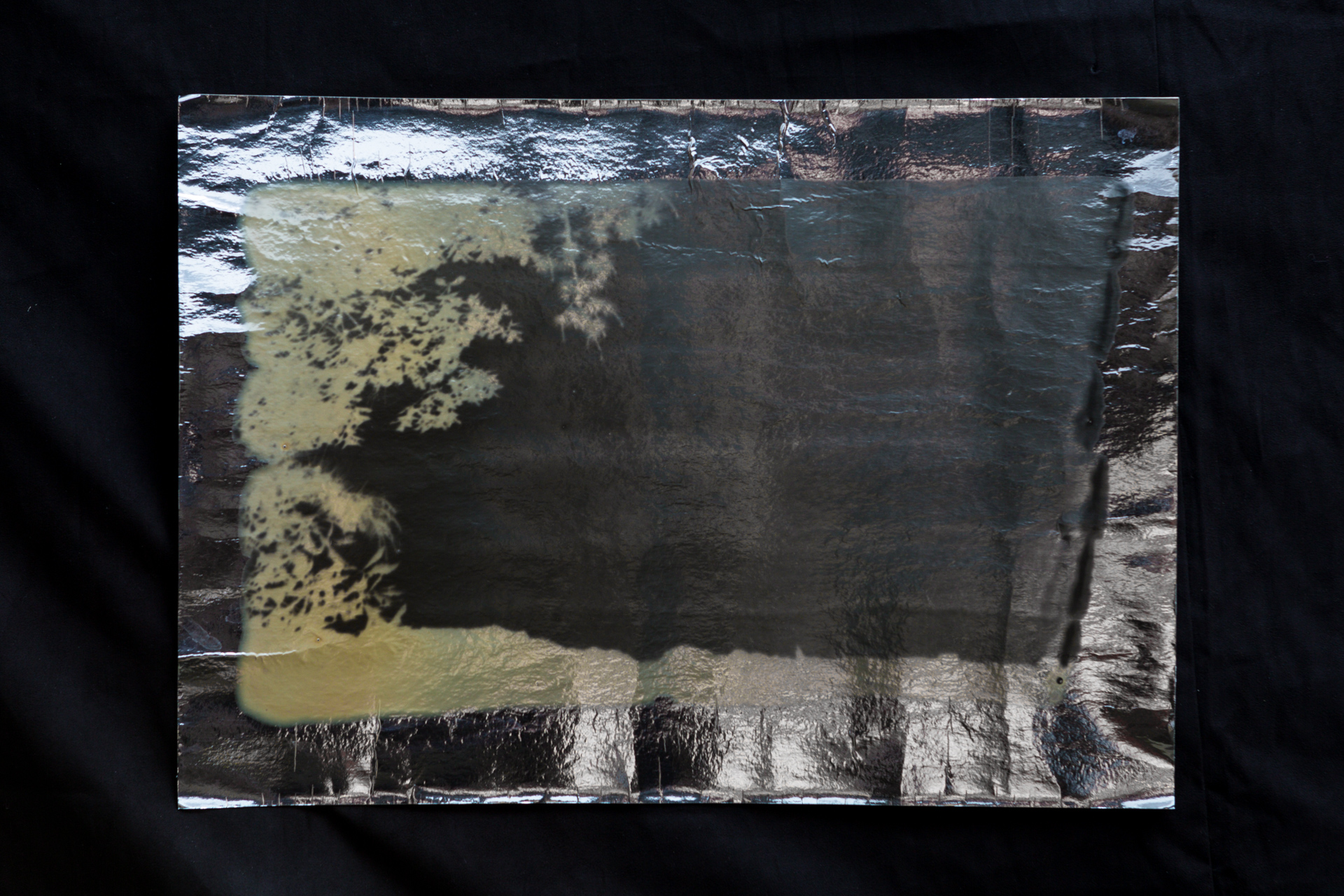

• Would you expect to see the included image, if it is an exposed negative of liquid light with 1:10 dektol on a paper with glossy silveryish sizing with normal dektol and Kodak hardening fixer processing? I can't quite get what's going on here. I took a normal photo so you can see what the surface looks like to the eye. This is 2 years old.
I'll have comparison photos of what adding dektol to the emulsion does up in a few days.
