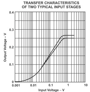

Be aware that there are two (at least) species of log amplifiers. Some are meant for compressing video signals; they accept bipolar input signals (how do they handle log(0)? see below plot for TL441) but have limited dynamic range (decades of input) unless several stages are properly combined. The TL441 belongs to that species.

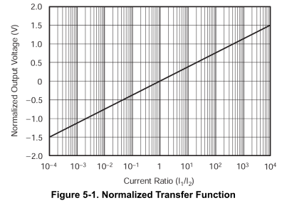

Another species are DC log amplifiers. They work with a unipolar current source (good match for photocells), and deliver 5 or more decades. An example is the LOG114 from Texas. See below transfer curve.
There are many more aspects to be considered. Is the input zero-bias? Price, availability? Packaging: is it compatible with the soldering options available to you as a DIY-er?
