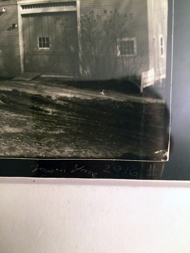

I sign the sheet in the lower righ-hand corner with soft pencil in the dark before exposing the print on the enlarger. Results in a very subtle but permanent signature.

Do you sign on the image area or in the margin? Both seem interesting if you sign prior to exposure of the paper.
Hi Kevin,
I sign in the exposed area. The prints that I sign are enlargements or contact prints of dry plate negatives, which very often have dark edges due to how the emulsion flows and sets on the glass plate. Therefore I am signing in dark portions of the print. So you can easily imagine the result of blocking light during exposure.
At first I would try erasing the graphite after the print had dried, leaving a light signature on a dark background. I stopped doing this pretty quick as this was hard to do without mucking up the print. So now it just looks like a graphite signature on a black background..and if ever removed reveals a faint permanent signature in the print. It is very subtle so it doesn't draw your attention and intrude on the print itself per se.
I'll post a photo of the signature when I get home if you're interested in seeing it.
Hi Kevin,

Hi Kevin,
I've attached here a picture I took of what it looks like when signed prior to exposure of the print. On this one, after development and drying, I very lightly erased the name and year to reveal the unexposed trace of my signature. So this is an exception to my rule of not erasing the pencil marks after the print dries. The "#1" I think I wrote afterwards, so you can see how graphite written after the fact compares to writing before exposure. This particular one was matted and framed, and my signature is as permanent as the print.
