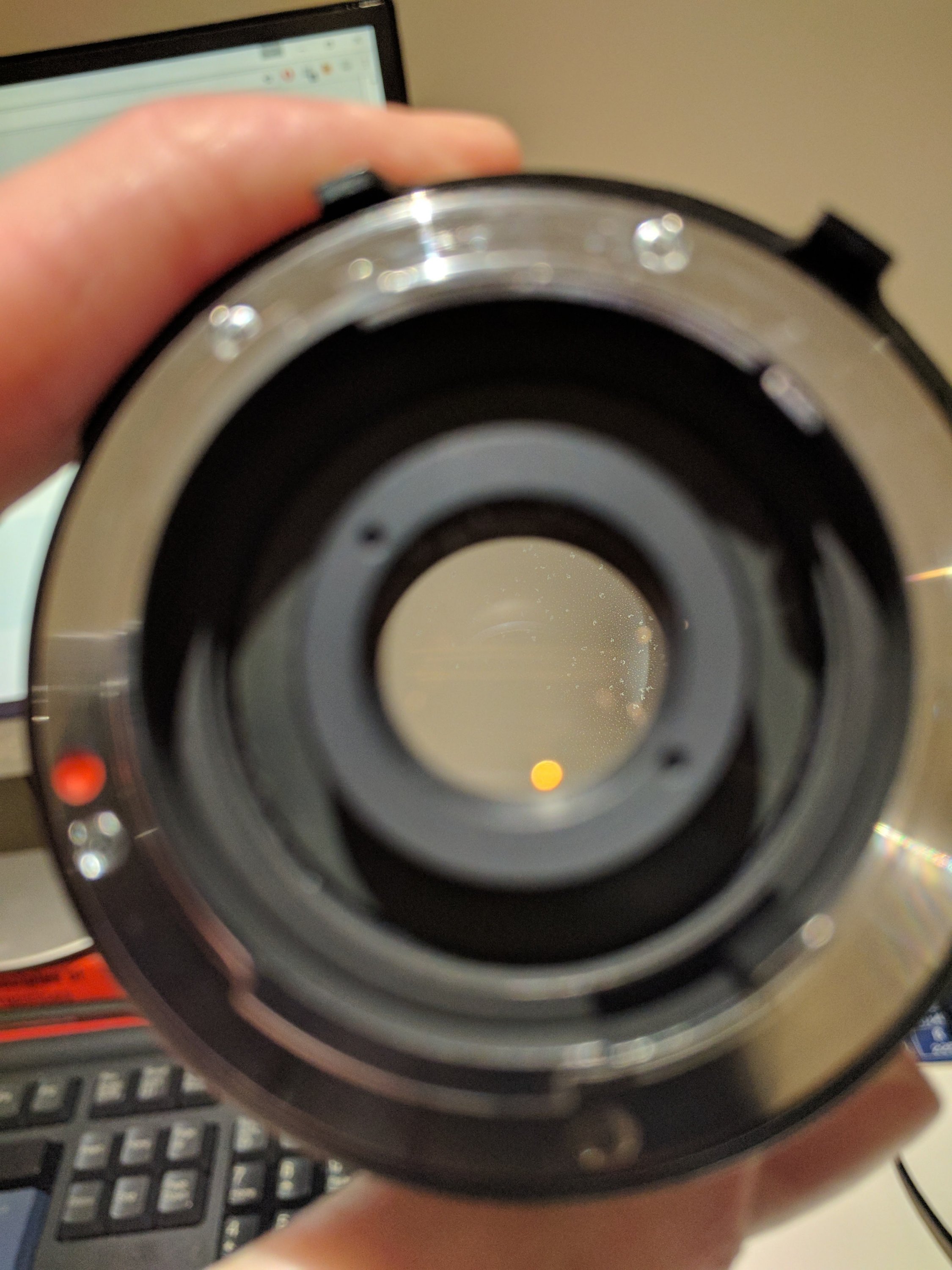

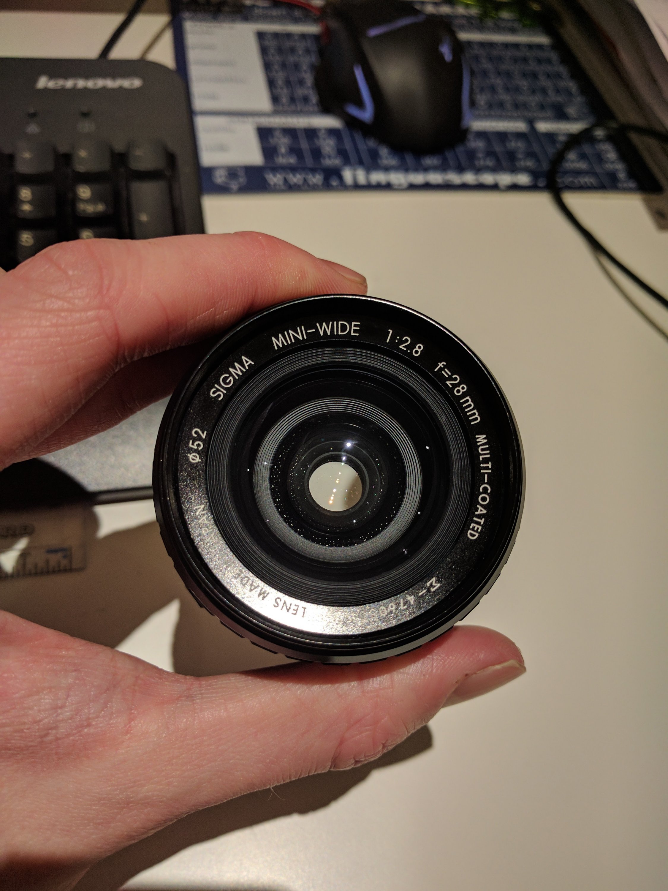

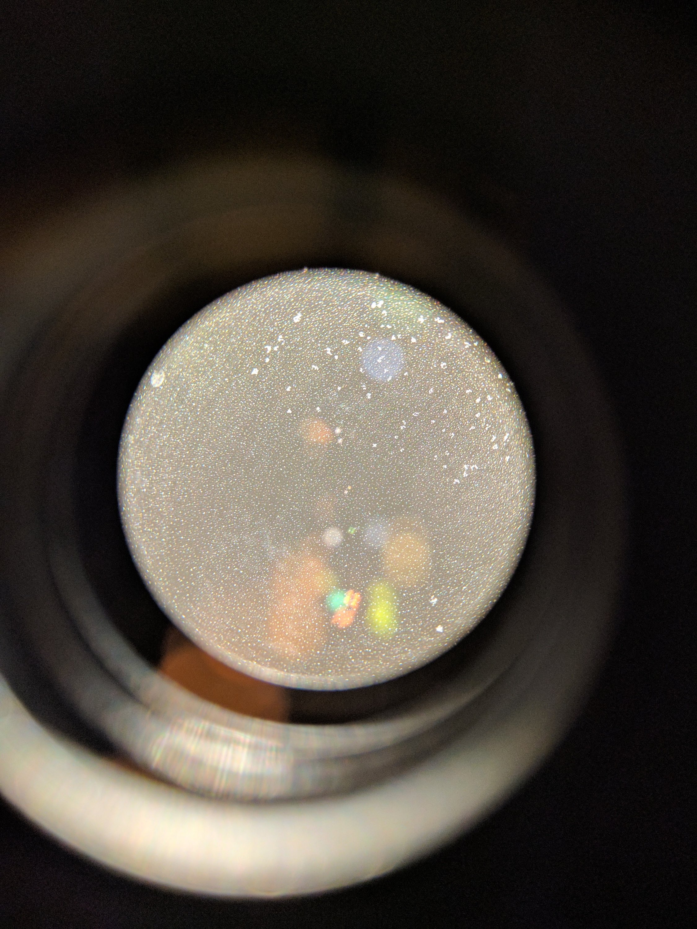

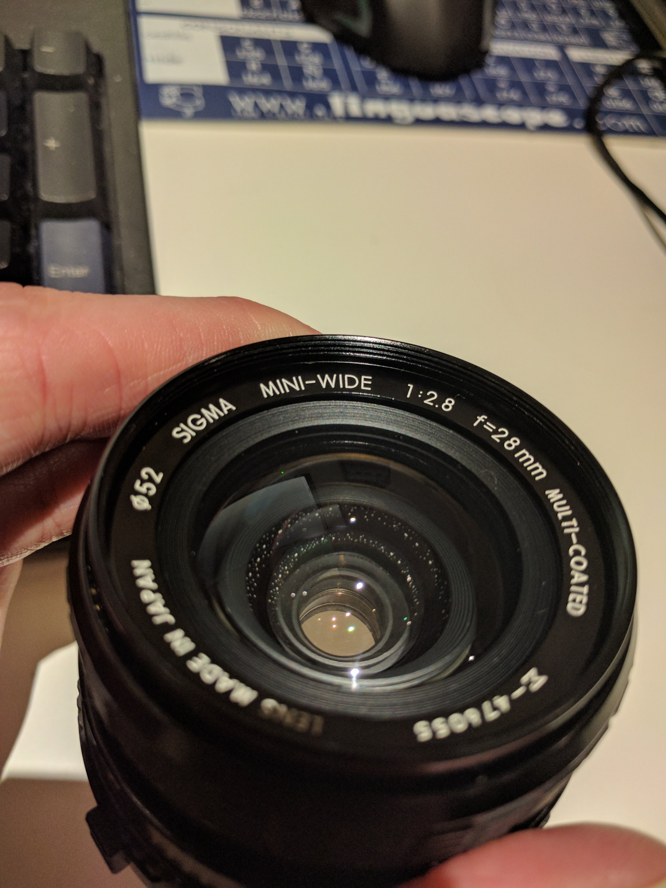

I bought this Sigma Mini Wide 28mm f/2.8 off eBay where the seller described it as excellent condition, and it is, mechanically at least. Looking directly through it, the glass seems to be clear, but when held up to the light there's a very obvious dusting of 'something' over the glass inside, which I'm guessing is fungus. When I put the lens on my camera, there's no obvious marks visible, but will it affect the image? If so, how? I don't own a digital camera with the minolta mount to check it unfortunately.
Would it be worth my trying to take it apart and clean it? Or should I just return it, or ask for a partial refund? It 'only' cost me £25, but that's a reasonable amount for a poor student, and I can't find another of the same lens in the same price range unfortunately - they seem to be £50 upwards from here (which obviously isn't that much at the same time, but I was just looking for a basic wide angle to play with and try out). I've attached a couple of pictures for you to take a look at, I'd really appreciate any input you have!
The speckling on the black parts seems to be marks on the paint, which I'm not entirely sure about too..

By the way, that does have something internal that needs cleaning.... but SOME of what you see maybe glue separation (which does not need to be addressed).

Fungus cannot be cleaned.
What's worse, it's contagious, and will infect other lenses in your kit.
Fungus eats the magnesium fluoride coating that's applied to photographic lens elements.
After digesting that, it excretes hydrofluoric acid, which etches glass.
Regardless of what method you might use to remove the fungus, you cannot replace the etched glass.
