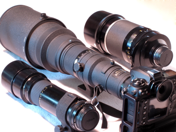

I do not have the Sigma 600mm mirror lens but I do have a 1000mm mirror lens and a 500mm lens that require a filter in the filter slot for it to focus correctly. The way I understand it is if a filter is not in place, the infinity focus will be off. For example:
1. If you manually focus on an object that is at an infinite distance, the distance scale on the lens will not be lined up with the infinity marking.
2. If you rotate the focus ring to the infinity position and point your camera toward a star cluster, the star cluster, which should be in focus, will actually be out of focus.
However, using the lens without the filter in place has no affect on the image quality.
