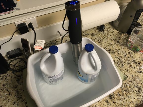

I just looked at it. It is evidently so cheap that it doesn't have a brand on it. The technical label says "Tristar Products," if that helps. I'm actually cooking up some film right now:

Does it just heat, or circulates the water also?

It circulates. It works really well. I am sure the Cinestill one works just as well... or just about any of them. Things like this are often made in a factory in China, then branded for various companies as they go out the door.
