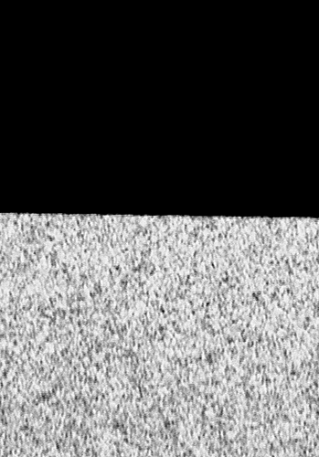

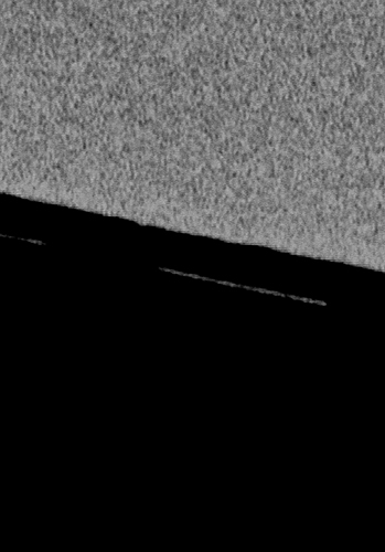

Here are some scans I made to illustrate the differing response of films to stand development with respect to edge effects.The photographs are of a gray card on a black card.The scans show the black/gray edge and are about 2.5 mm of negative in height.
With Adox 25 (same as Efke 25) and Tri-X there is a light line on the gray side,the edge effect.With FP4+ no edge effect can be seen,the gray is more even. IIRC, PE wrote this may be due to more iodide in these newer emulsions.
I believe the main use of stand development is to increase tonal range but it appears to have this side effect with some films.Scans are not a perfect representation of the edge effects on silver gelatin prints,on which I can see some slight edge effect on stand developed FP4,but they give the general idea.

Which developer(s)? What development times? What agitation pattern(s)?
Labels on the images might be helpful too.

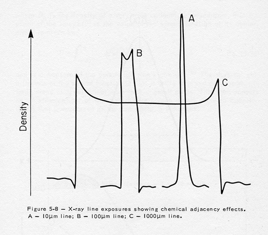

You are looking at the left edge of the wide line in the left attachment here. You cannot see if there is a 'peak' in the dark area due to density.
The chart on the right, either negative or positive, will give a much more definitive answer, but this is certainly a good example you have presented.
However, without a check with normal processing and/or another developer, we cannot 'prove' stand development did this.
PE

Alan Johnson
Nov 16, 2004
3,281
PE, all I have to illustrate the difference between normal and stand development are two Plus-X photos in Rodinal.They are Photoshop processed the same. Stand development (Rodinal 1+200 90m 68F) ,right thumbnail, gives more edge effect with this film I believe.

Photo Engineer
Apr 19, 2005
29,018
Rochester, NY
Alan;
Thanks. That is very revealing to me. It does illustrate the effects of stand + rodinal and how it can differ from film to film. Thiis is a good illustration of why different people get different results, due to film, developer and technique.
Thanks.
PE
