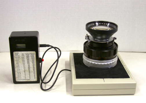

I found a hack on line that allowed me make a pad to support the lens while I was triggering the shutter. Works great

That is a nice shutter tester. Hard to find those these days.

This looks like the unit I have and seems to share the same guide sticker. Mine doesn't have the wired/remote trigger and is simply triggered by the eye. Did you add this. Gordrob?
Appreciate your comment. Thanks
It is a Calumet Shutter Speed Tester and I added the remote deck from a hack I found online from jbhphoto.com. It is a lot easier to use than just the original tester and not too difficult to build.

Many thanks for the jbhphoto.com link. It was new to me and the tester mod piece looks doable for a tyro like me, too!
