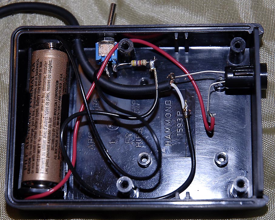

A couple pointers regarding this cool little device. I used a toggle on/off swithch, 1 AA battery, 4.7ohm resistor, and a photo transistor in my unit. I also have a 5mm LED holder (concave) for the photo eye to peek through. I don't know electronics much, so I had a friend do the soldering. I don'

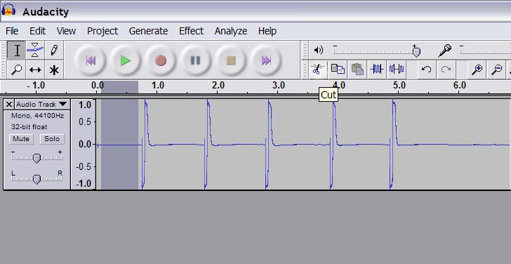

You'll find that it's easier to immediately edit the flatlines between your recorded waves by highlighting them and deleting them. Then when you make the window of Audacity (or other program) bigger, you have your 5 waves right there for measuring.

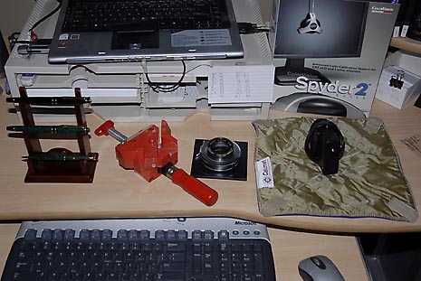

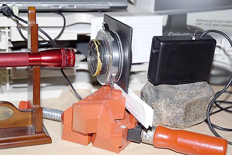

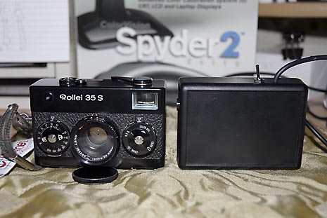

Here are a few shots of my desktop setup. If you're wondering what that is that the tester is perched atop, it's a genuine dinosaur bone - a vertabra.
In this setup you can see the flashlight, my trusty old 80 year old Dagor that is sooo sharp and its Alphax shutter.

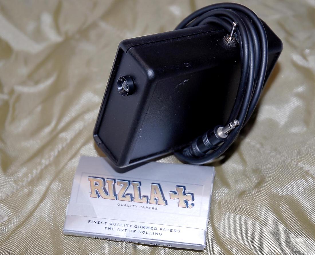

A couple of shots included for scale. The tester by two different types of Rollies!

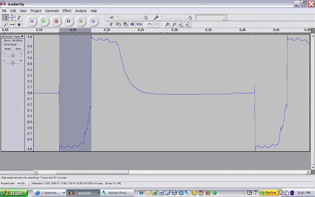

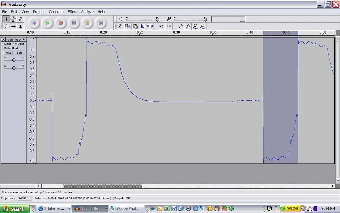

Then there are some screenshots showing what the raw sound file looks like. There is then a screenshot showing how I prepare the file for easier testing.
The last screenshots show the enlarged curves and two samples both were 0.047528 and the next three were 0.047891 for an average of 0.047567 seconds. This is 1/21 of a second. The shutter speed tested was 1/20th and when I had this lens tested by a technician six weeks ago he reported 1/20th. Not bad for a vintage shutter! What amazes me is how consistent most shutters are that I've tested. This shutter only varied in the ten-thousandth of a second decimal place.

Must be the Rizla effect (worse than Callier!)...
The Alphax shutter speed was 1/25th that was tested. So it's consistent but a slow about 1/3 of a stop.

You may also wonder how I know the battery is off. I chose to put the audio out wire at the 'on' side of the switch. The wire is my indicator. Works well actually.
I also recommend use of a caliper so the holes you drill for the switch, wire, and light sensor are nice and snug. I purposely made the audio out wire hole very tight so that I don't need any kind of collar. It's very secure and makes the unit look more like the sleek beast she is!

I indicated above that two identical reads were showing in the measurements. Actually there was a rogue 0.048254 in there that I mistook for a '528' - yes these are millions of a second here! The adjusted average is more like 1/20.8 seconds. I like comparing the shape of the waves. Different shutters have much different curves. Different speeds on the same shutter can have different curves, I think this I should expect between the higher two speeds and the others. Separate springs perhaps?
