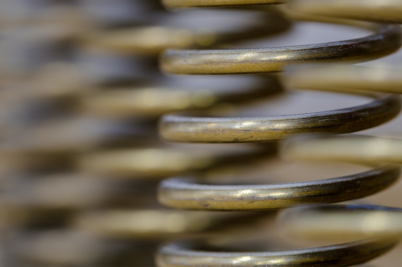

A slight aside (is it an aside?) about old shutters being slow. Apart from the top speed, which is maybe the result of the marketing /advertising depatment making promises that engineering can't fulfil, the other speeds are also slow, typically by 1/2 EV. I've noted this on several old shutters (Zeiss, Retina...) despite using all available adjustments and repeatedly cleaning in naphta.
Could it be that the main spring is "tired"? Initially I was skeptical, since it is never deformed beyond the elastic regime. But I googled "spring creep". FYI, "creep" is permanent defromation occurring below the elastic limit.
and a number of more academic texts.
So, yes, springs can lose tension over time, just from sitting there. Just about makes up the difference between ISO and ZoneSystem film ratings🙂

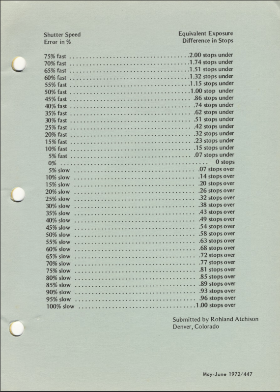

I just found this resource in one of the SPT Journals on learncamerarepair.com. Should be helpful.
MattKing
Apr 24, 2005
55,425
Delta, BC Canada
So - how many interpretations can you think of for what is meant by, as an example, "65% slow"?
I can think of at least two.
The way that AndyNC set up his data is much more clear.
