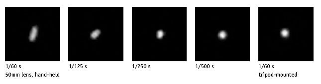

What's attached are the results of the best of five exposures at five different setups. If sharpness matters, always use a tripod! If having an image matters more than having a sharp image, and a tripod is not an option, take the shot without a tripod.
It depends what you call sharp. If you mean "sharp in a (small) print" then only the relationship between field of view, camera rotation rate and print size matters. In which case, you can happily handhold a 4x5" at 1/50 with a 200mm lens on it if you only expect to contact print.
However if you mean "as sharp as the lens is capable of producing", i.e. no motion blur bigger than the lens' resolution limit or the film's grain, then the original rule of thumb pretty much holds. The focal length defines how fast the image moves across the film for a given rotation rate and it doesn't matter how big your film is. So if you can get a grain-sharp image on 35mm with a 200mm lens at 1/200, then you can do the same with a 200mm lens on a 4x5. You can probably do better because you don't have any mirror slap and the camera is heavier.
Another thing to consider is that it's all a bit probabilistic. The rule of thumb says "you'll probably do OK at that speed". Some people can get sharp shots 90% of the time going twice as slow as the rule of thumb, some people can't get a sharp shot at all unless they're shooting at twice the speed implied by the rule of thumb. Different people have very different levels of steadiness. Here's a whitepaper on testing image stabilisation which goes into the detail required as to different people's differing steadiness.
