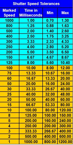

This shutter speed tolerance chart from http://www.flutotscamerarepair.com/ shows there are a lot of speeds between 250 and 500 if you don't round or truncate to the nearest whole stop.
