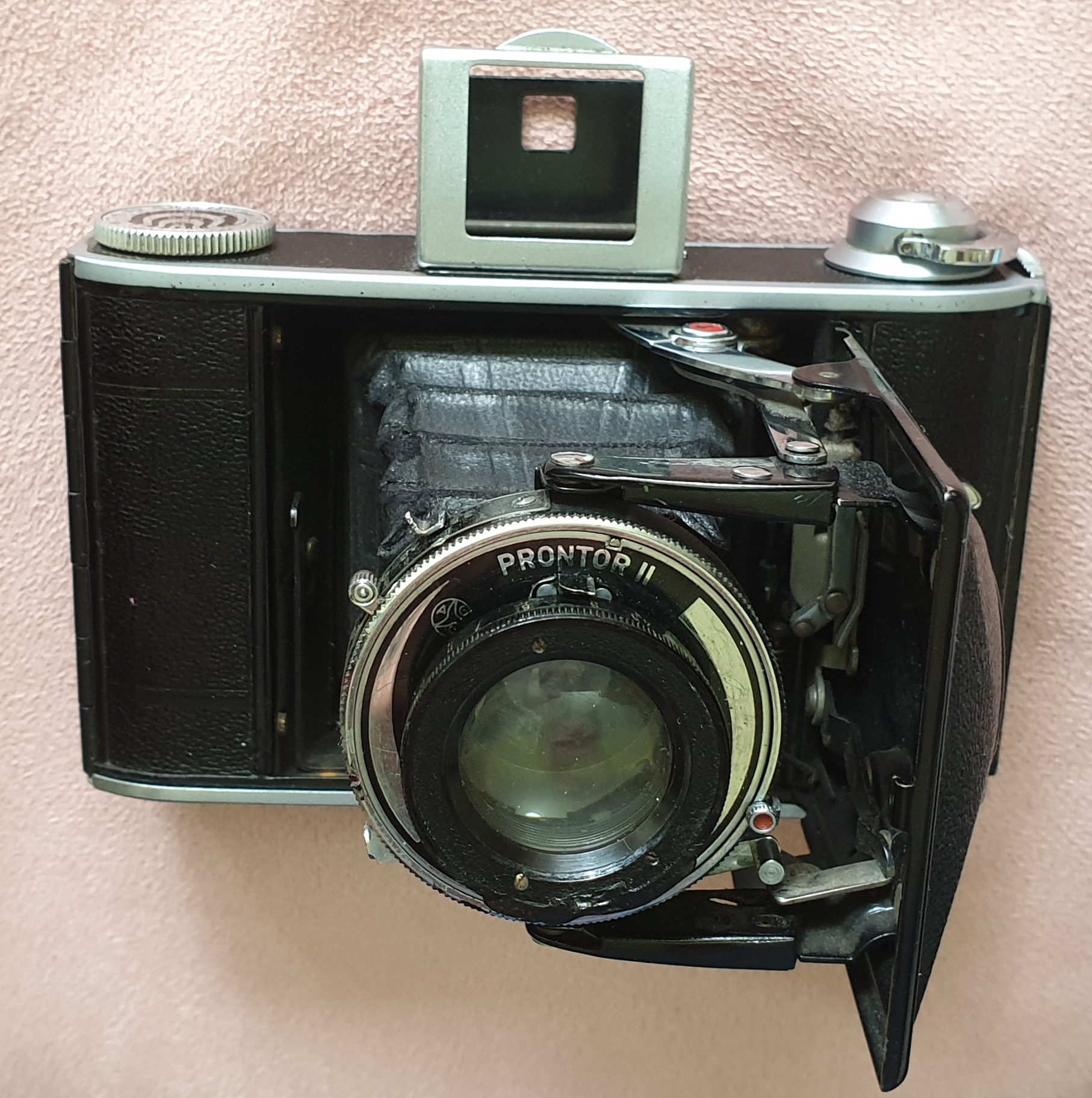

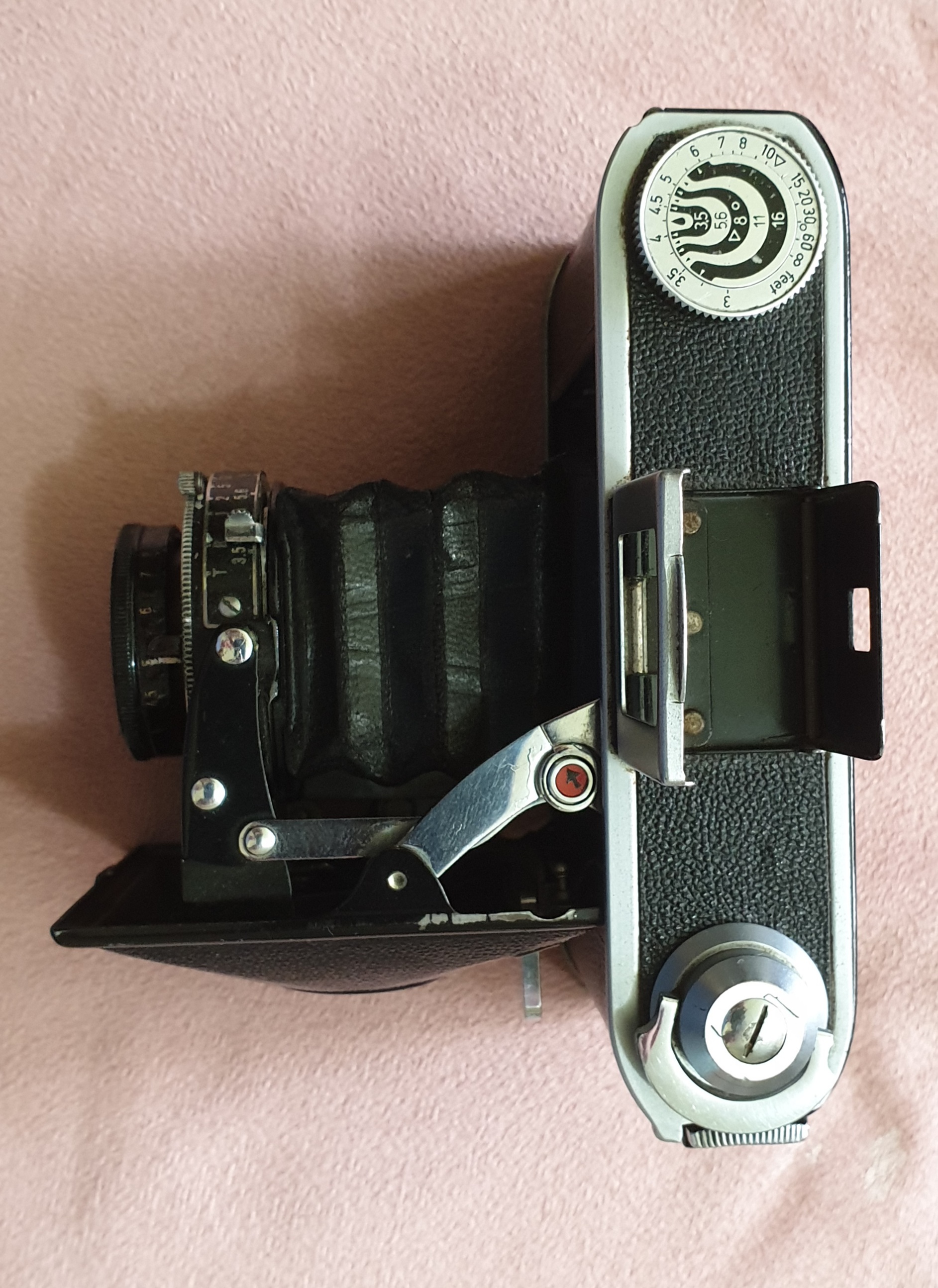

The test film I ran through it confirms that the higher shutter speeds are OK. I've attached a few photos. I think it's a fairly early model, with the hinged yellow filter missing - you can see where it was once attached. Otherwise it's in excellent cosmetic condition and everything else works nicely.

That's an early Baby Bessa. Later ones have a chrome top plate assembly with automatic frame spacing. Not integrated to the shutter release; you hit a button to wind on. And the viewfinder is moved to the far right end, a small optical tunnel.
On later models, I think the basic system was the Heliar lens had a Compur-Rapid shutter, the Skopar had a Compur, and the ??Voigtar?? triplet had the Prontor shutter. Sorry, I forget the name of the Voigtlander triplet. I don't know how this broke down on earlier models like yours.
