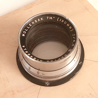

Yes I know. I've been cautioned and chastised in other groups but I want to build an instant camera to use my stockpiled Fuji 100 utilizing the body of an old broken Polaroid Big Shot and my (currently barrel mounted) Wollensak 190mm Raptar ƒ4.5 lens. I have mocked it up with blue tape and it works wonderfully and incorporates the focusing two step with the camera's built in viewfinder. I DO NOT want to buy a different, or better, or smaller lens. I'd like to use pieces I already have.
But I do need a shutter. I have been told its a Alphax No. 3, and also a No. 4 but even with the catalog posted by Camera Eccentric and info at lensn2shutter.com I really can't tell. I don't want to drop a bunch of money on something that won't fit. I really don't want to drop a bunch of money at all. The outside of the mounting threads measure 2 3/16 inches with my H. Freight plastic calipers.
Could someone help me and share your wealth of experience by telling me if there is a shutter, of any age, I can drop the lens elements into with out any hassle. Or, barring that, with minimal hassle - and what precisely that hassle might be.

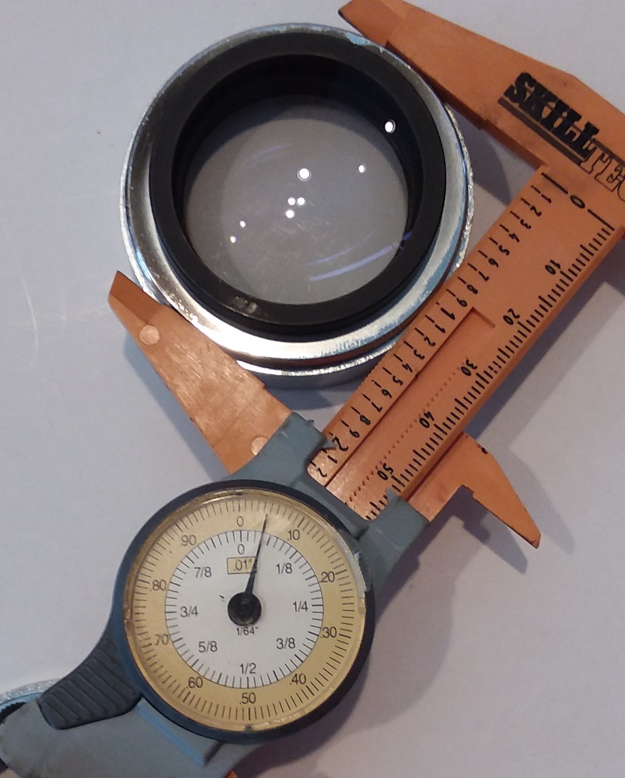

Hey Dan, Thanks for the replies. The first picture above is measuring the threads on the back of the front element after removing from barrel which I assume would be the necessary thread diameter of the receiving shutter.
The shutter facing threads on the rear element are the same.
If my conversion is correct they would be 53mm in diameter.

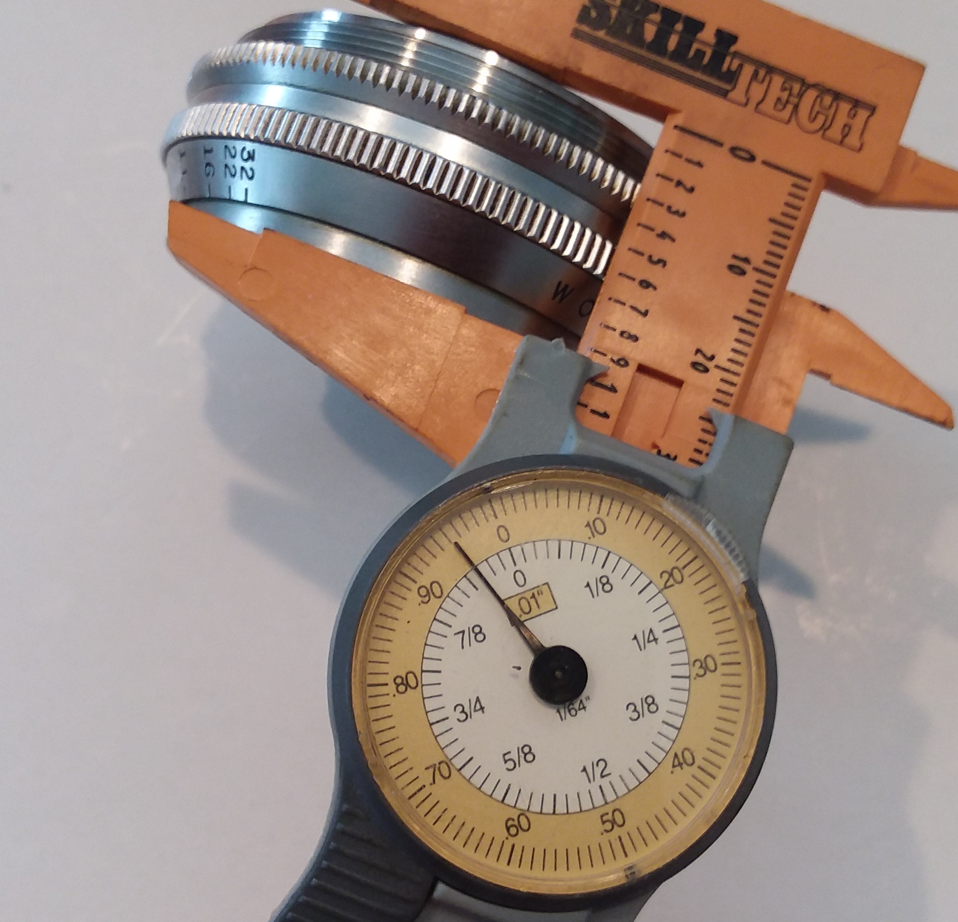

The second picture is the thickness of the barrel which i assume would be the same thickness of any usable shutter.
Sometimes my attempts at precision fall flat.
