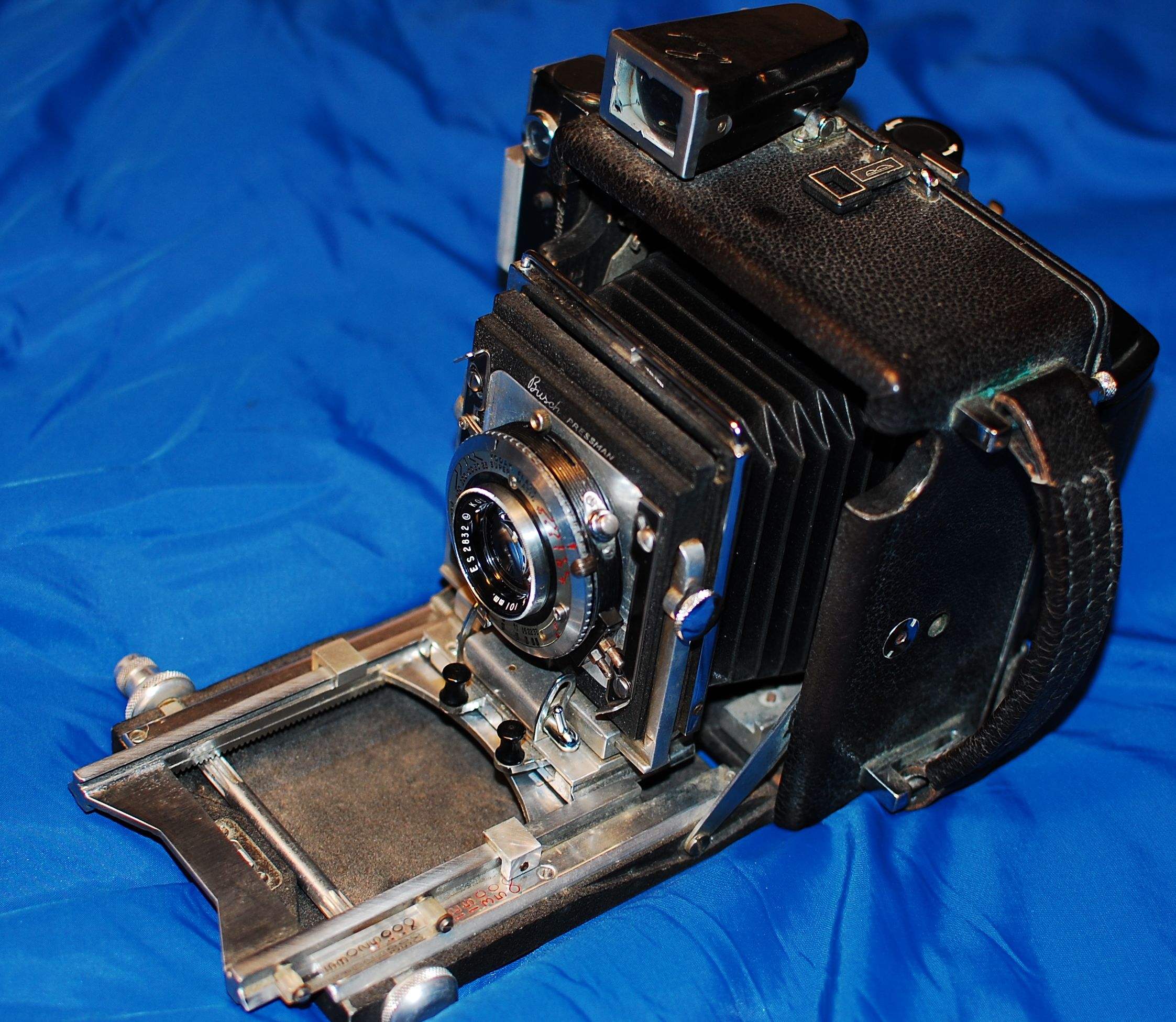

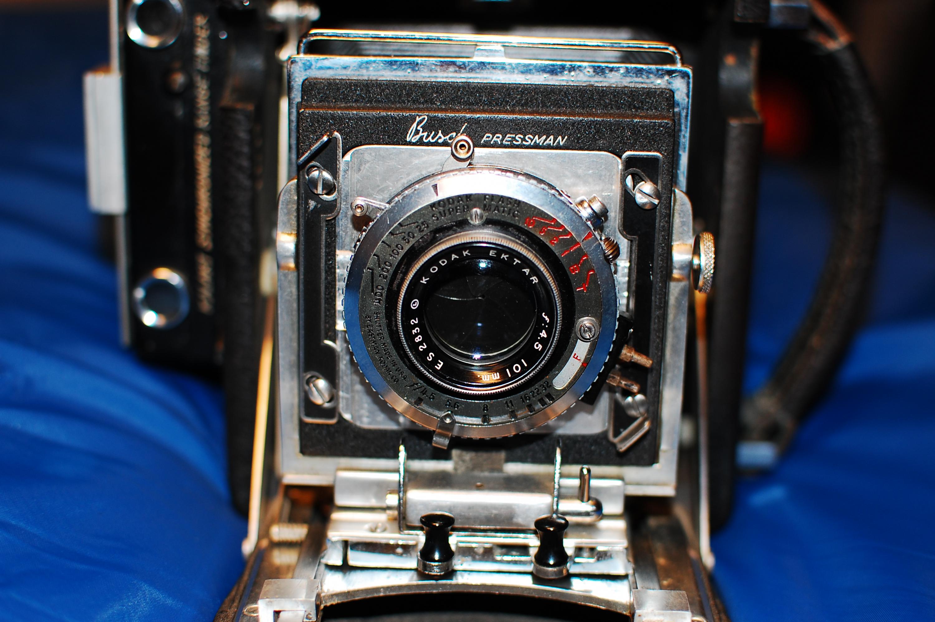

Received a Busch Pressman C with Kodak Ektar 101mm f4.5 lens mounted on a Kodak Flash Supermatic shutter needing a CLA. The shutter works very well in most regards, but the blades are oily, and the shutter usually doesn't close tight, leaving a tiny opening. But, the camera is in fine, servicable shape, has ground glass back and 120x8 rollfilm back, and I'm anxious to use it. What a fine camera! It has the Kalart rangefinder on the side, and a Busch viewfinder on top (with parallax lever). Best to send this out for repair. Would like recommendations on repair person or place.
I'm new to large format. This is my first camera with movements, and using 120 film makes it highly affordable. Should I tackle this myself, or is it economically feasible to send for repair? Thanks in advance for guidance and advice.

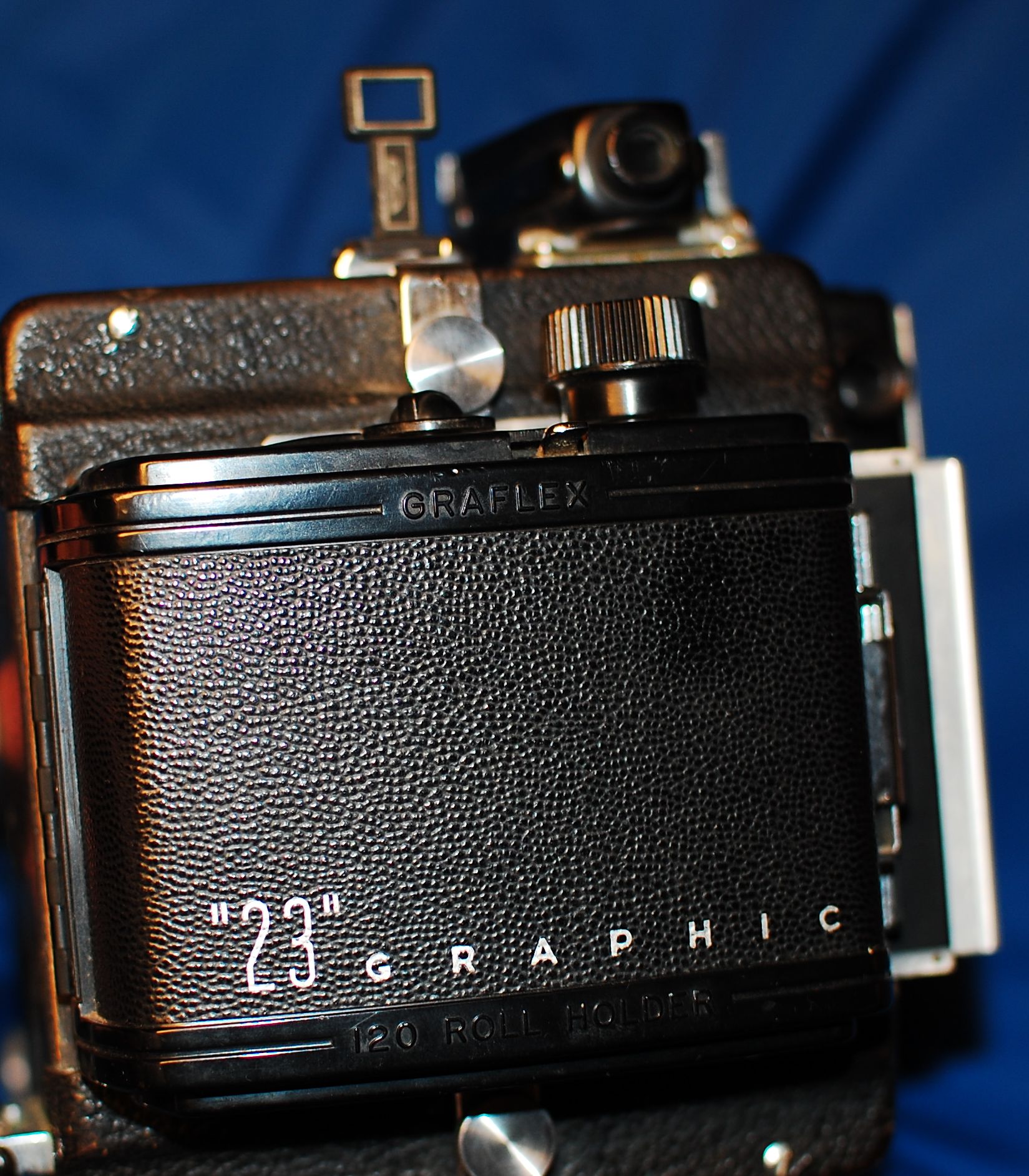

naptha
Is Coleman camping fuel simply naptha, and good/safe to use for this purpose? I think it's just pure naptha.

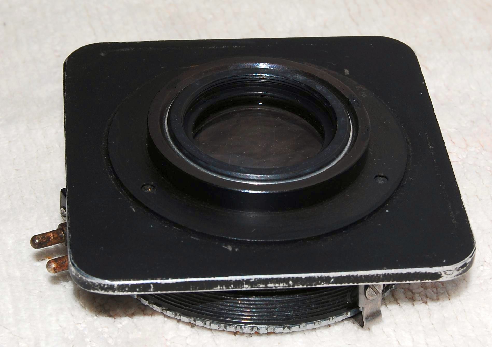

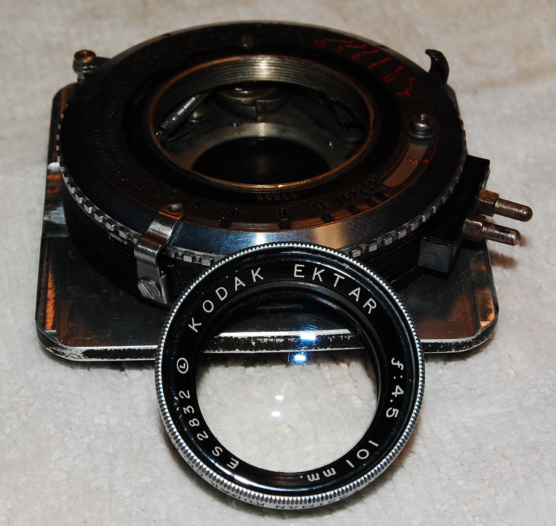

rear element removal
How to remove the rear element? The front is out, as shown in the picture, but it isn't clear how to remove the rear element. Would appreciate guidance.
Once the rear glass is out, I will try flushing the shutter leaves to clean off the gunky oil. Thanks in advance for any help and assistance.
Jeff
Have you tried one of those rubber jar openers?
Jon

rubber gripper
Yes, I have thought of that. It appears I would need to lay the rubber over the assembly, and use a round object to apply pressure the the center circle, which I believe to be the part that will screw out. I could use a socket of the appropriate size, for example, to apply precise downward pressure on the rubber. (a basic mechanics bolts and nuts socket, which is just the right size and shape). Just not sure if that's the part that screws out. It sure looks like it.
The glass needs cleaning. Oil residue on the inside. The glass is in great shape, as shown by this photo of the front assembly, and this lens (and shutter) appear worth my efforts. Even if I succeed in cleaning the glass, I am not averse to seeking professional help from Paul Ebel on the shutter. "A man's got to know his limitations!"
